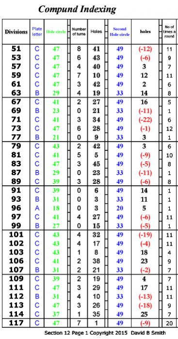

    Compound Indexing any number to 250 on a standar indexing head
    Compound Indexing any number to 250 with a BS-0
    Dave
    Attached Thumbnails Attached Thumbnails Compound Indexing any number to 250 on a standar indexing head-compund-indexing-chart1-copy.jpg   Compound Indexing any number to 250 on a standar indexing head-machinistguidepage14apr-4-2015-copy.jpg
