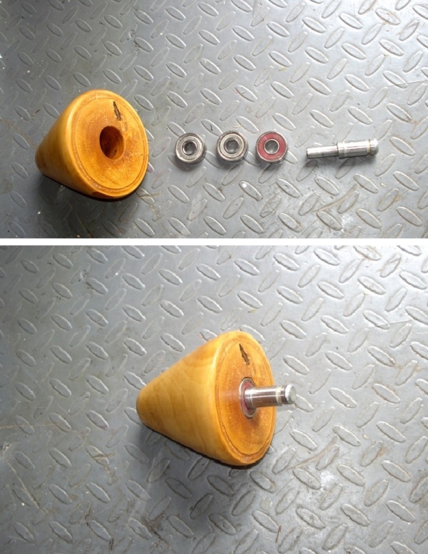

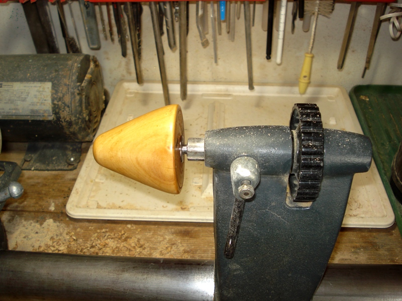

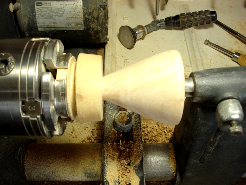

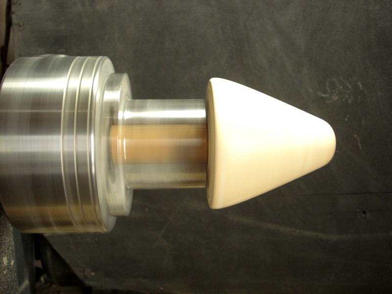

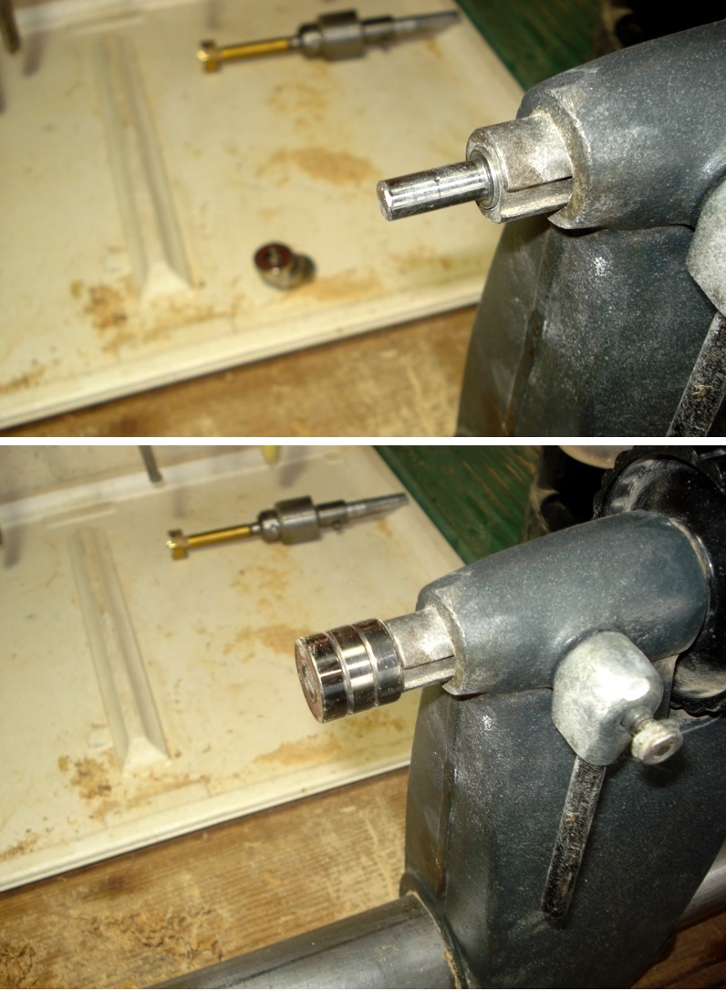

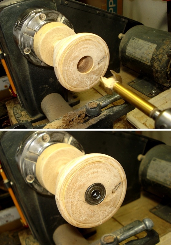

    Conical Live Center for Tailstock
    This device is useful to hold the free end of some pieces, once the center has been hollowed out.
    The cone was made with mesquite wood.
    The center was made by reusing a chair wheel shank, and it has three 3/4" bearings.
