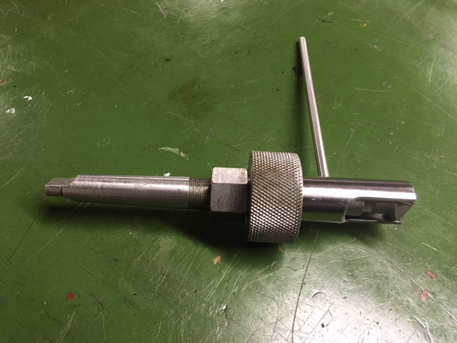

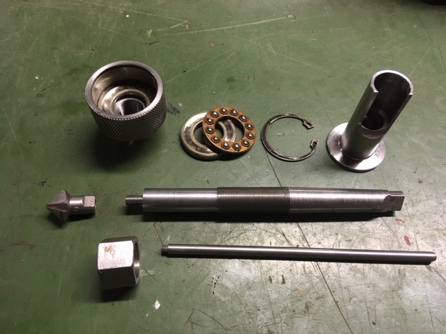

Hi All
This is my homemade countersink tool with an adjustable integral depth stop that doesn't mark the work piece on a No. 2 Morse taper. In my opinion there is nothing worse than seeing countersinks all different sizes on a component. I designed this so I could set the tool up and not have to faff around with the depth stops on the machine. Using depth stops is not a problem if all the holes are on the same plain, but as you will see from the video this really quickens up production and more importantly to me maintains the same size countersink on the components when they are not.
Attachment 21621Attachment 21622
Thank you for taking the time to view the short video https://youtu.be/Ii79hYzJ00Q
