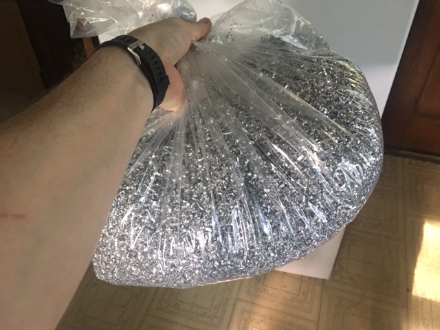

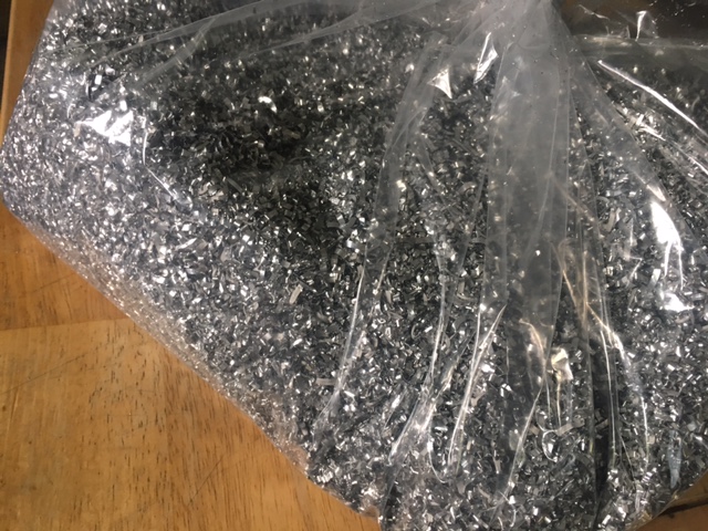

    Funny timing... I just got 3 pounds of aluminum chips from 80/20 Inc just for this purpose a few days ago.
    Countertop made from metal chips - photo-chips_3830.jpg Countertop made from metal chips - photo-chips_3829.jpg
    Neil
