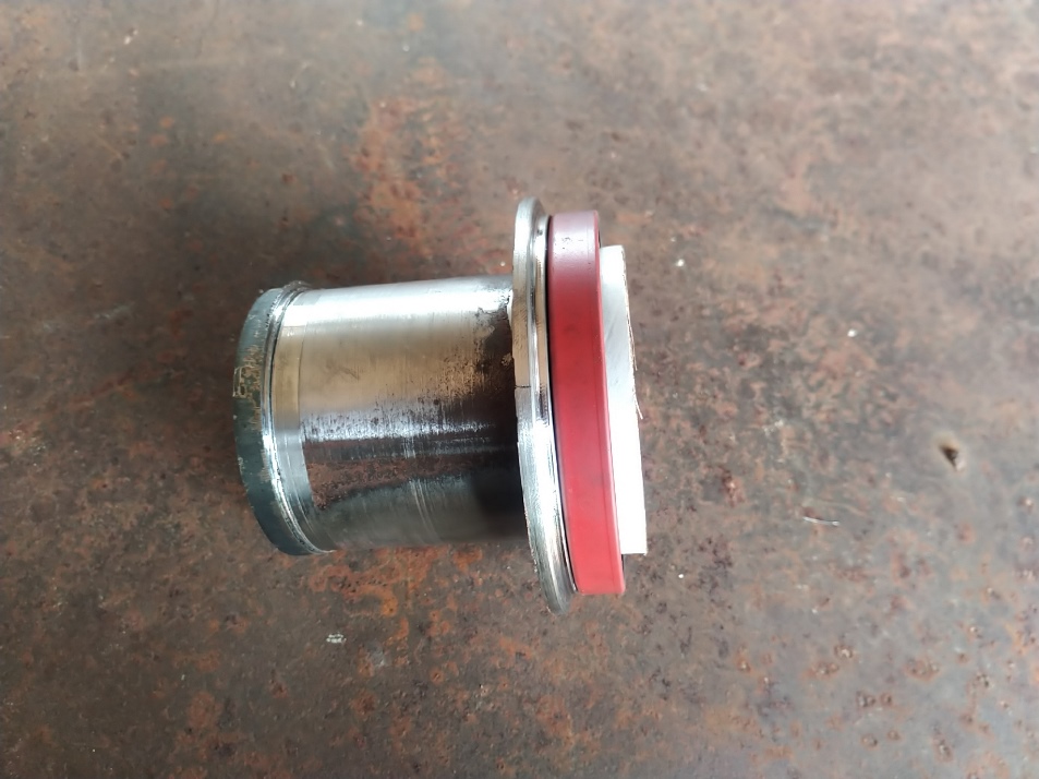

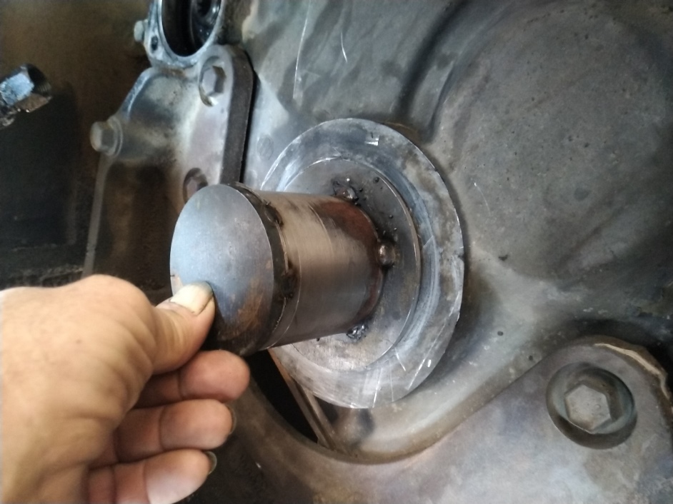

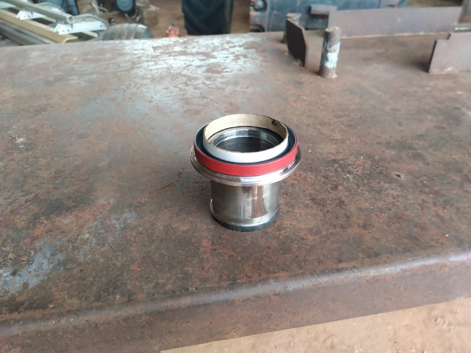

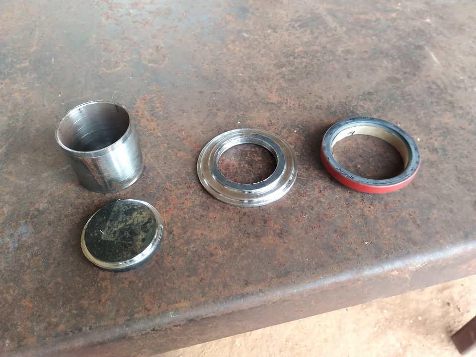

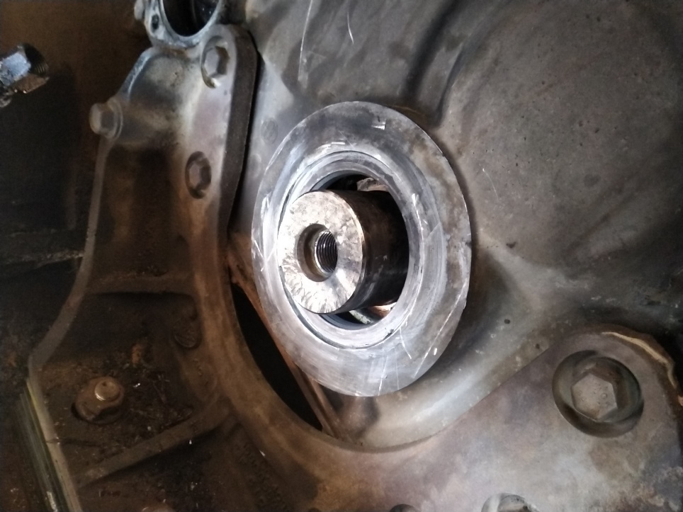

Crankshaft seal installing tool
When installing any oil seal it is very vital the seal is not damaged while being driven in and is driven to the proper depth as well as being perfectly aligned Many seals do not have a locator ring of flange to set the depth so the installation tool must compensate for this
Before removing the old seal I made note of the depth it was installed then machined a few simple items to fabricate a simple install tool
