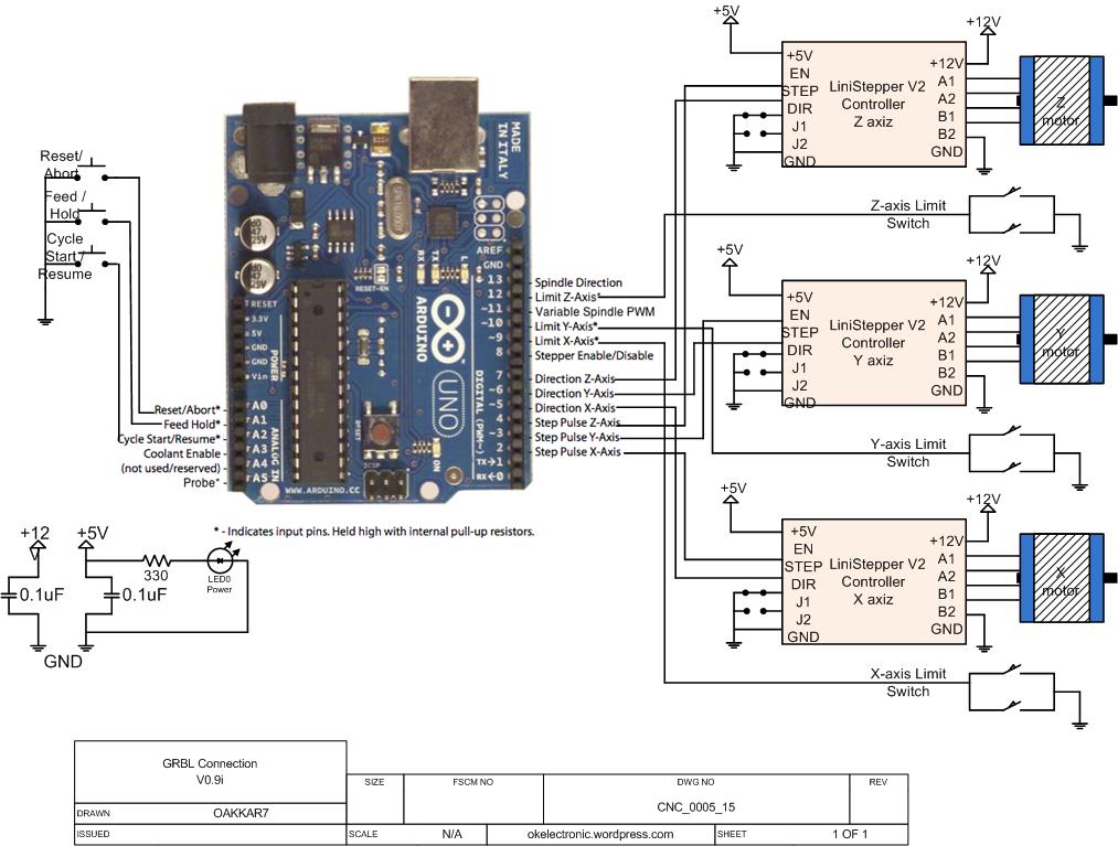

    So you want to build a cnc machine, let’s start with a bit of top down approach.
    Image taken from
    https://okelectronic.wordpress.com/category/grbl/
    all Credit toOakkar7
    This is perfect as its based on the Arduino Uno as a controller.
    So you have 3 stepper motors and drivers for each axis, limit switches to stop the machine wandering off piste and that’s enough to get you started really.
    The Arduino Uno is just a development board, its dumb and has no operating system/firmware on it.
    This is where GRBL come in, Grbl is Open Licence firmware (computer code to you and me) which is loaded onto the Arduino uno to turn it into a cnc controller.
    The easiest way to do this is to upload the code directly to the board using a hex uploader, you could use the arduino’s design development environment but you want to build a CNC not learn to program.

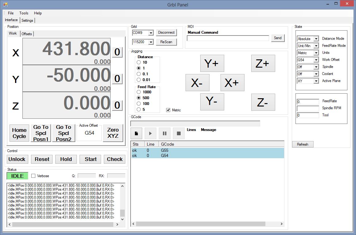

    Next step is to find some software to operate the controller from your PC and enable you to send files to it.
    I use and would recommend GRBL panel
    https://github.com/gerritv/Grbl-Pane...s/tag/V1.0.9.3
    You are looking for GrblPanel-Release-1.0.9.3.zip its at the bottom of the page above where it says Downloads. The two options below are the source code and very scary, do not go here.
    Install GrblPanel-Release-1.0.9.3
    You should get a screen like this
    In the top centre of the screen you can select the port where your Arduino is connected and underneath the baud rate for the communications this must be set for 115200.
    When you press the connect button it should connect and make the remaining parts of the screen active.
    I personally think there is a bug in this software when it comes to entering your machine setting,
    Click on the settings tab and you will see a list of machine settings
    $0=10 (step pulse, usec)
    $1=25 (step idle delay, msec)
    $2=0 (step port invert mask:00000000)
    $3=7 (dir port invert mask:00000111)
    $4=0 (step enable invert, bool)
    $5=0 (limit pins invert, bool)
    $6=0 (probe pin invert, bool)
    $10=3 (status report mask:00000011)
    $11=0.010 (junction deviation, mm)
    $12=0.002 (arc tolerance, mm)
    $13=0 (report inches, bool)
    $20=0 (soft limits, bool)
    $21=1 (hard limits, bool)
    $22=1 (homing cycle, bool)
    $23=0 (homing dir invert mask:00000000)
    $24=25.000 (homing feed, mm/min)
    $25=500.000 (homing seek, mm/min)
    $26=250 (homing debounce, msec)
    $27=1.000 (homing pull-off, mm)
    $100=4750 (x, step/mm)
    $101=1500.000 (y, step/mm)
    $102=50.000 (z, step/mm)
    $110=500.000 (x max rate, mm/min)
    $111=350 (y max rate, mm/min)
    $112=500.000 (z max rate, mm/min)
    $120=20.000 (x accel, mm/sec^2)
    $121=20.000 (y accel, mm/sec^2)
    $122=20.000 (z accel, mm/sec^2)
    $130=330 (x max travel, mm)
    $131=135 (y max travel, mm)
    $132=80 (z max travel, mm)
    Now what you are supposed to do is type in your values and just hit enter, I cant honestly say it worked so the alternative is to go back onto the Interface tab/button and enter the command manually ie type $130=330 into the manual command text box at the top of the page and click on the send button.
