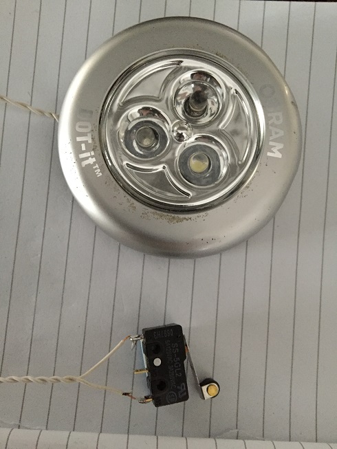

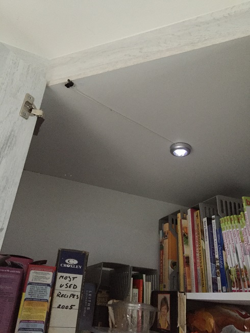

    But wify has been on about a light in the corner cupboard for a while, I was waiting patiently for the lights ordered from Aliexpress, but when they arrived they did not fit the non standard 135 Deg hinges.
    So I opened up an old LED light we kept at the front door for emergencies and soldered some wire to its battery and a small limit switch that I actually bought for a conversion of a manual valve to automatic.
    A few pieces of double sided tape and job done.
