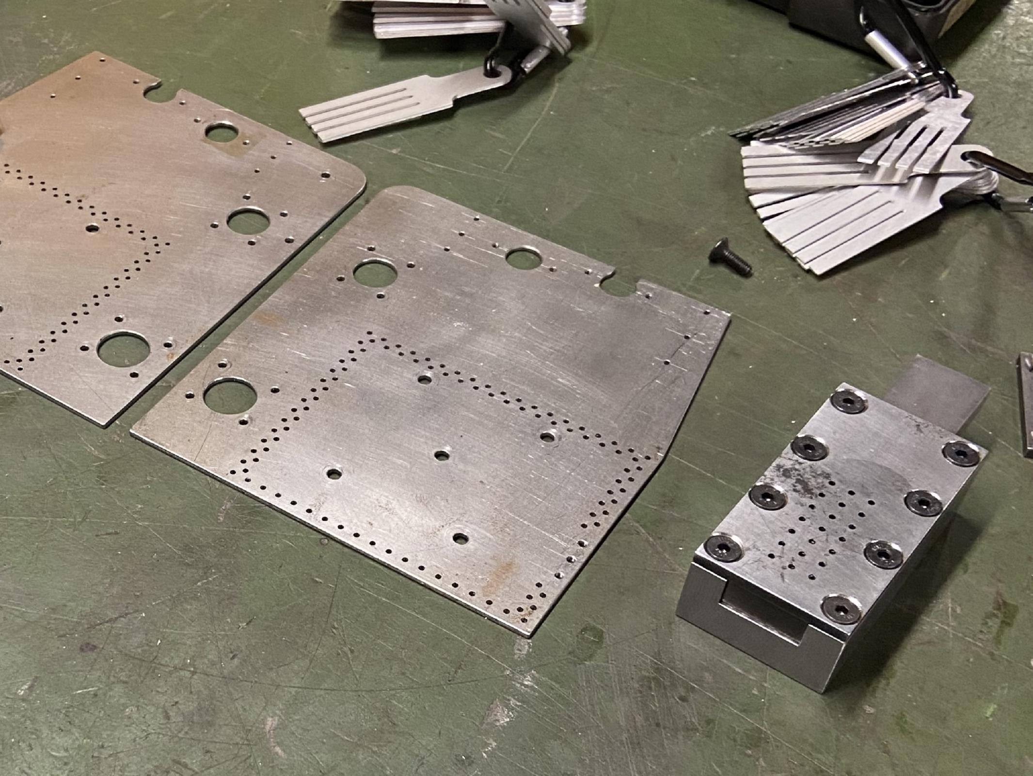

Hi All
I have quite a few solid rivets to shorten for dummy rivets on the horn plates of my 1" scale Minnie traction engine. So the criteria for the tool was to be able to cut several rivets at a time and maintain consistent length accuracy.
Attachment 33480
Horn plate and rivet cutting tool.

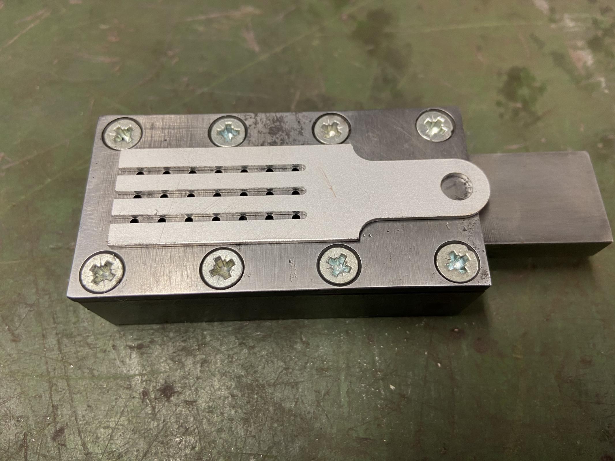

The tool is basically a guillotine that is loaded with rivets and the length is set by shims under the head of the rivet.

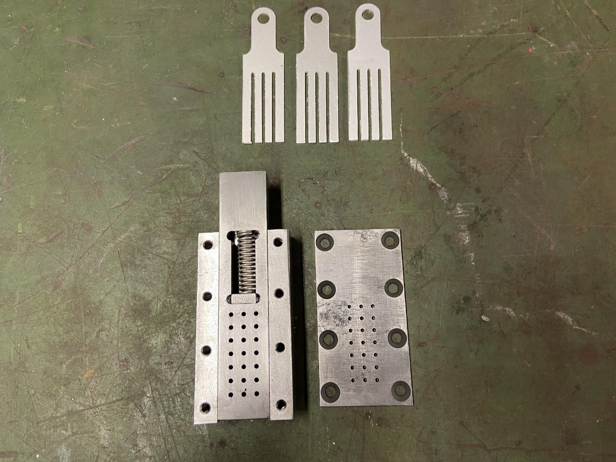

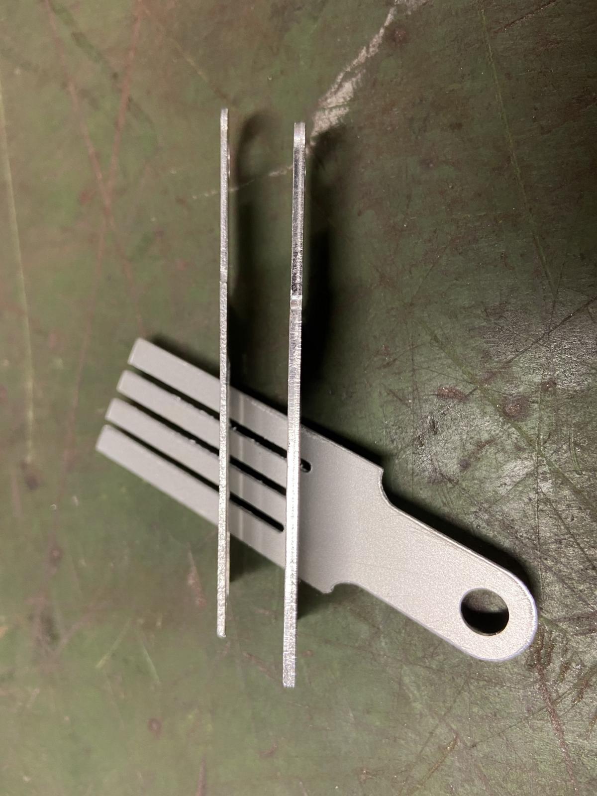

Attachment 33481
Shims, 3 different thickness. I have access to a CNC mill and made the shims using this method.

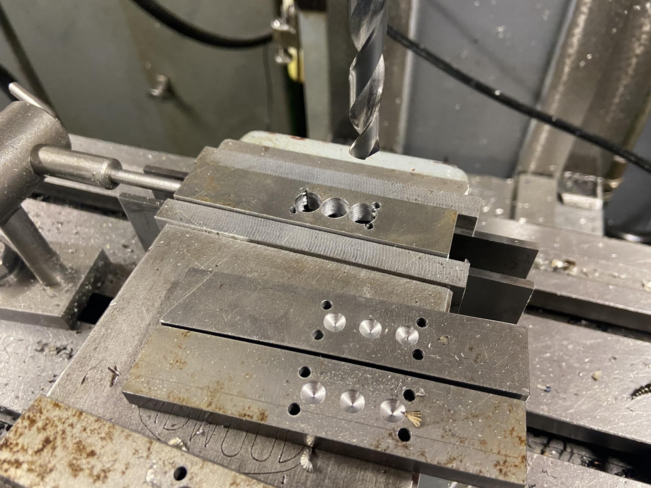

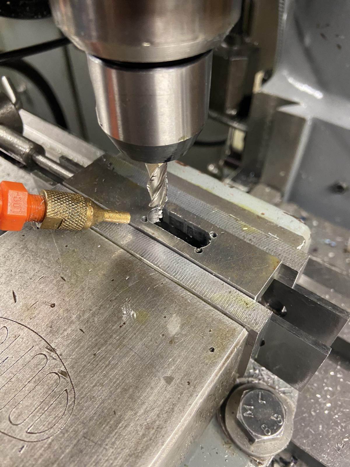

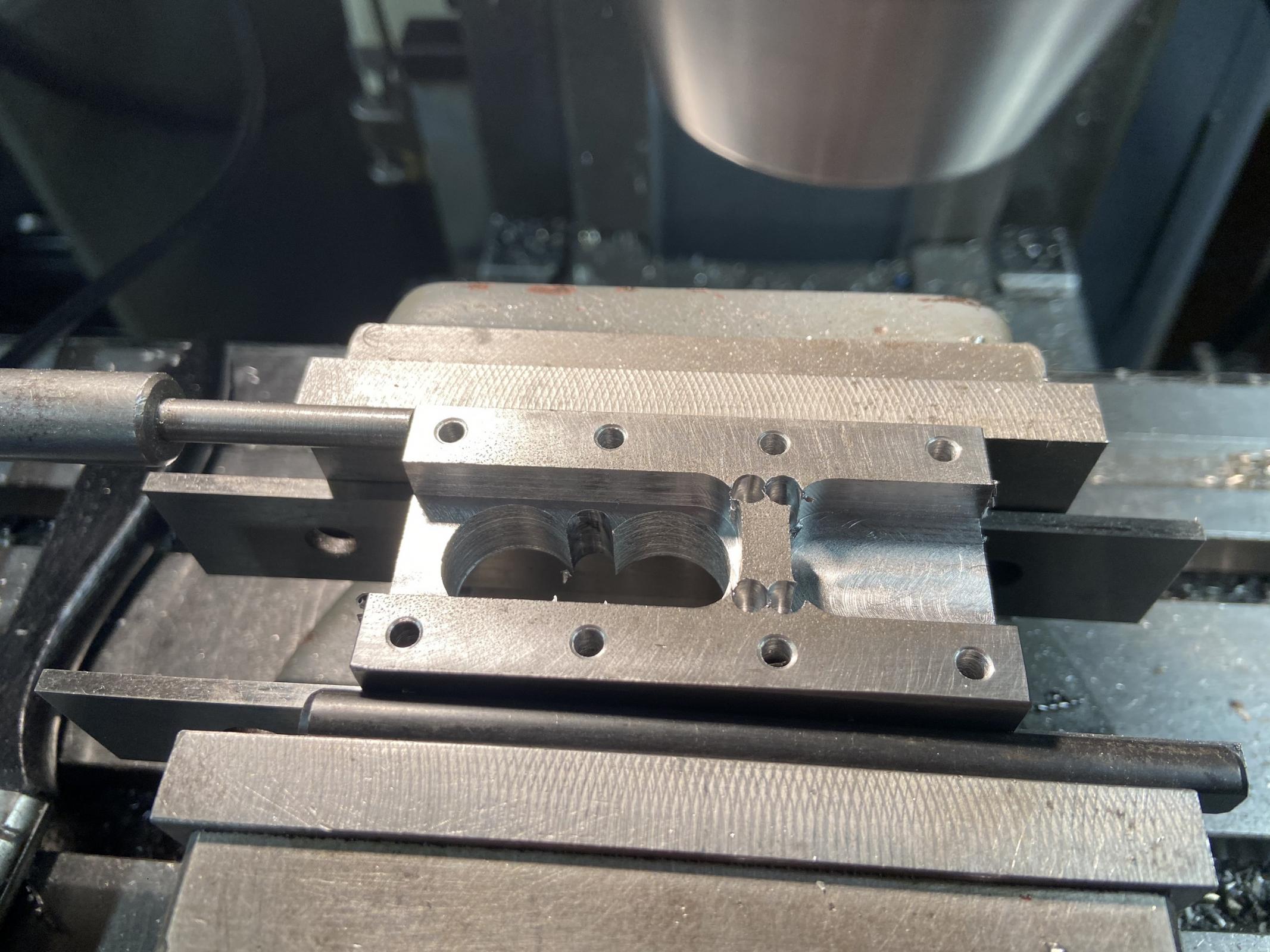

Attachment 33482 Attachment 33483 Attachment 33484
Machining main body and sliding cutter

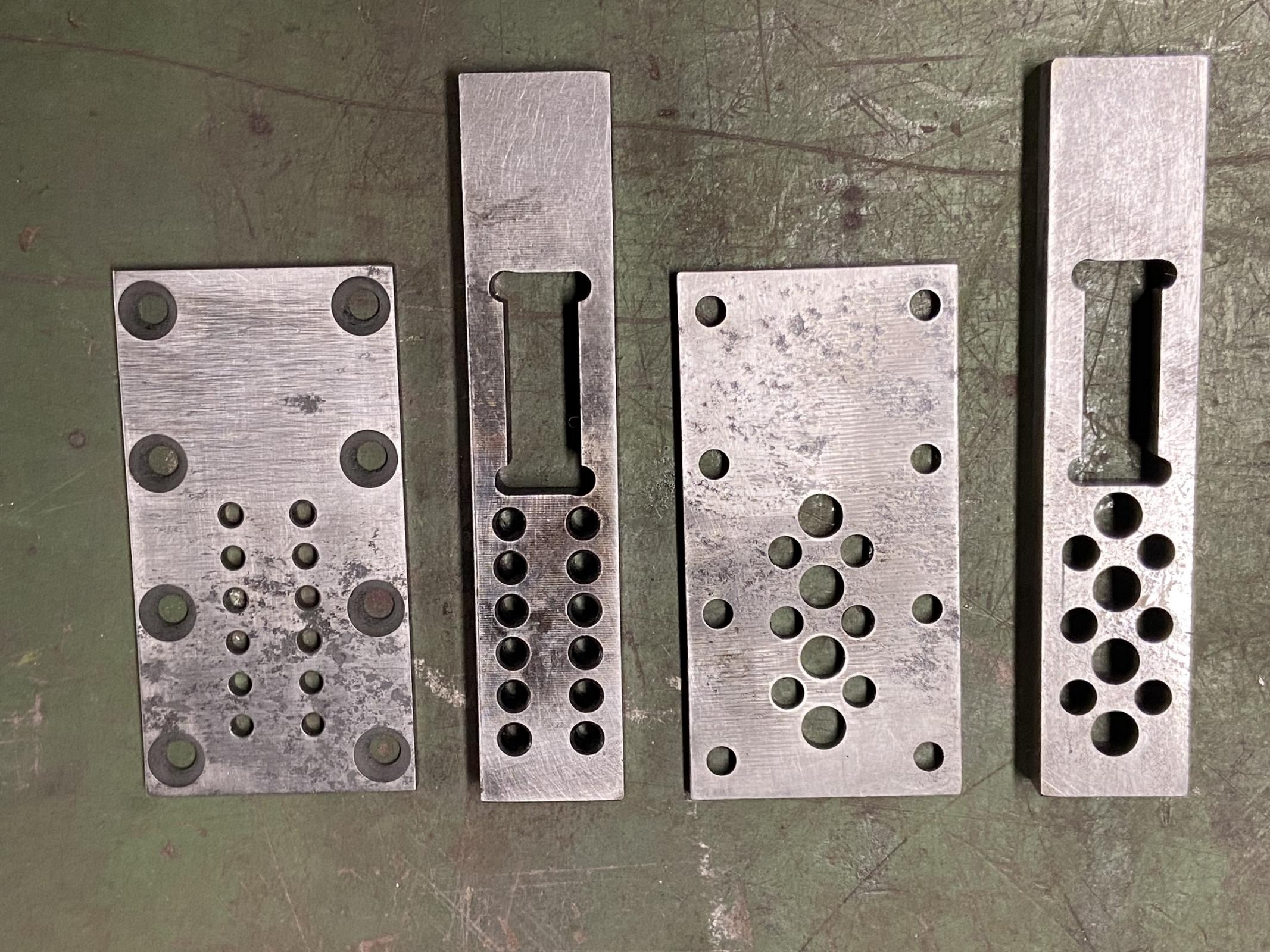

Attachment 33485
Heat treated sliding cutter

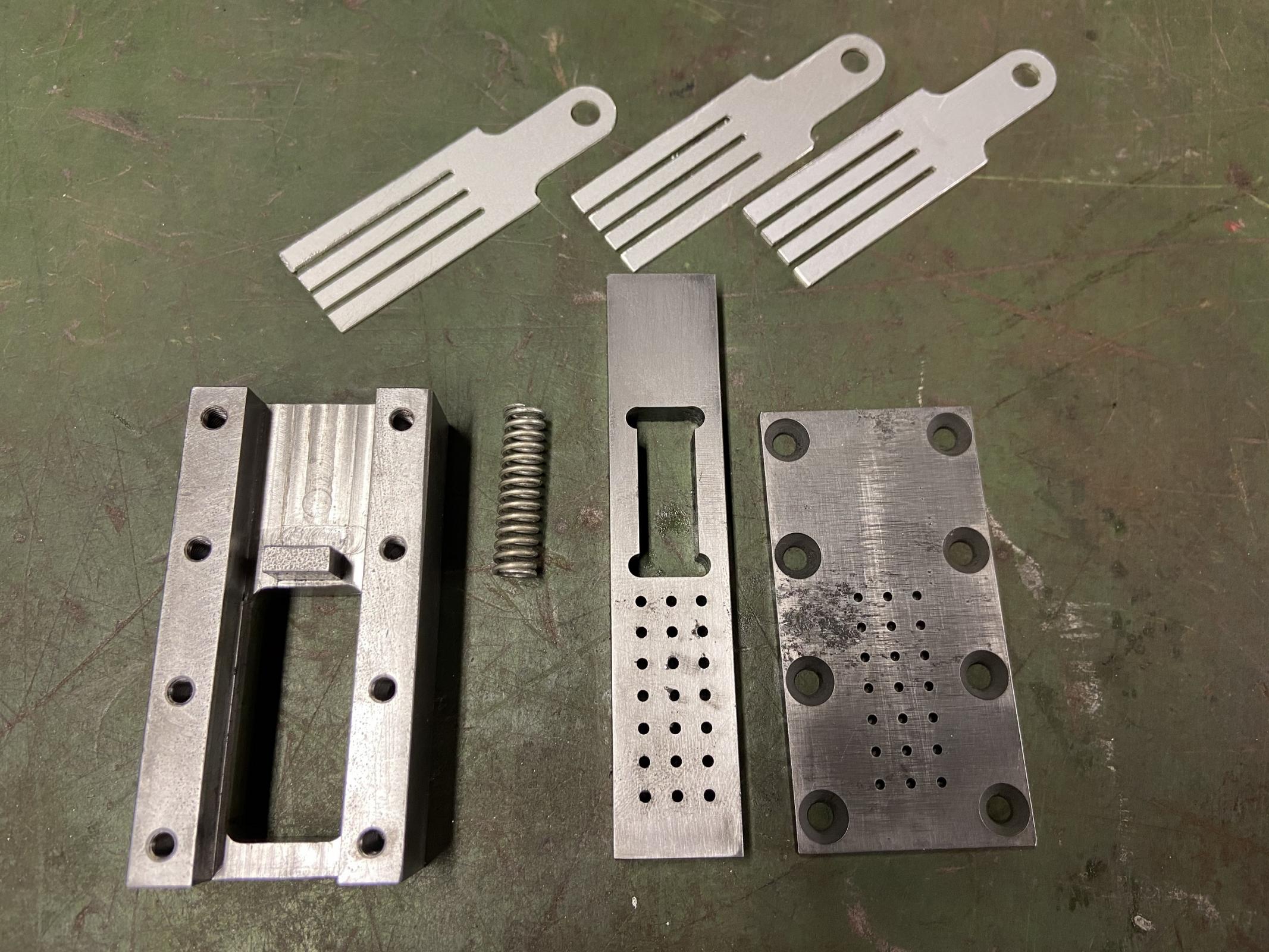

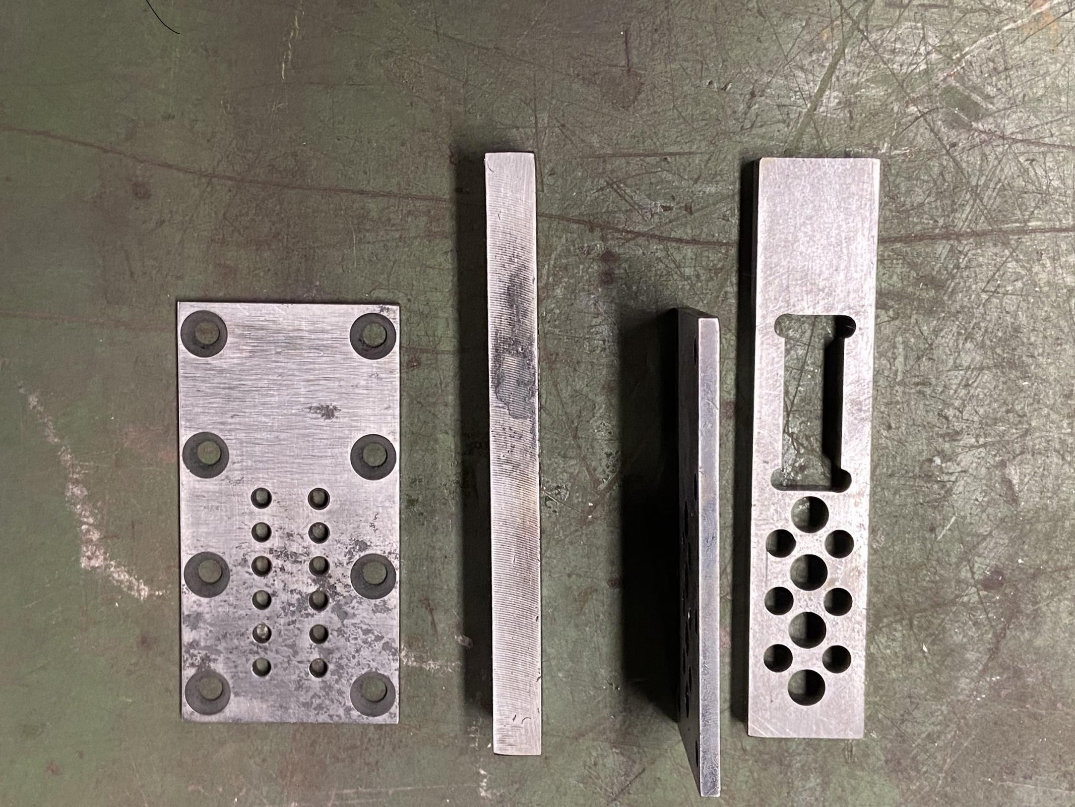

Attachment 33486
Completed unassembled cutter.

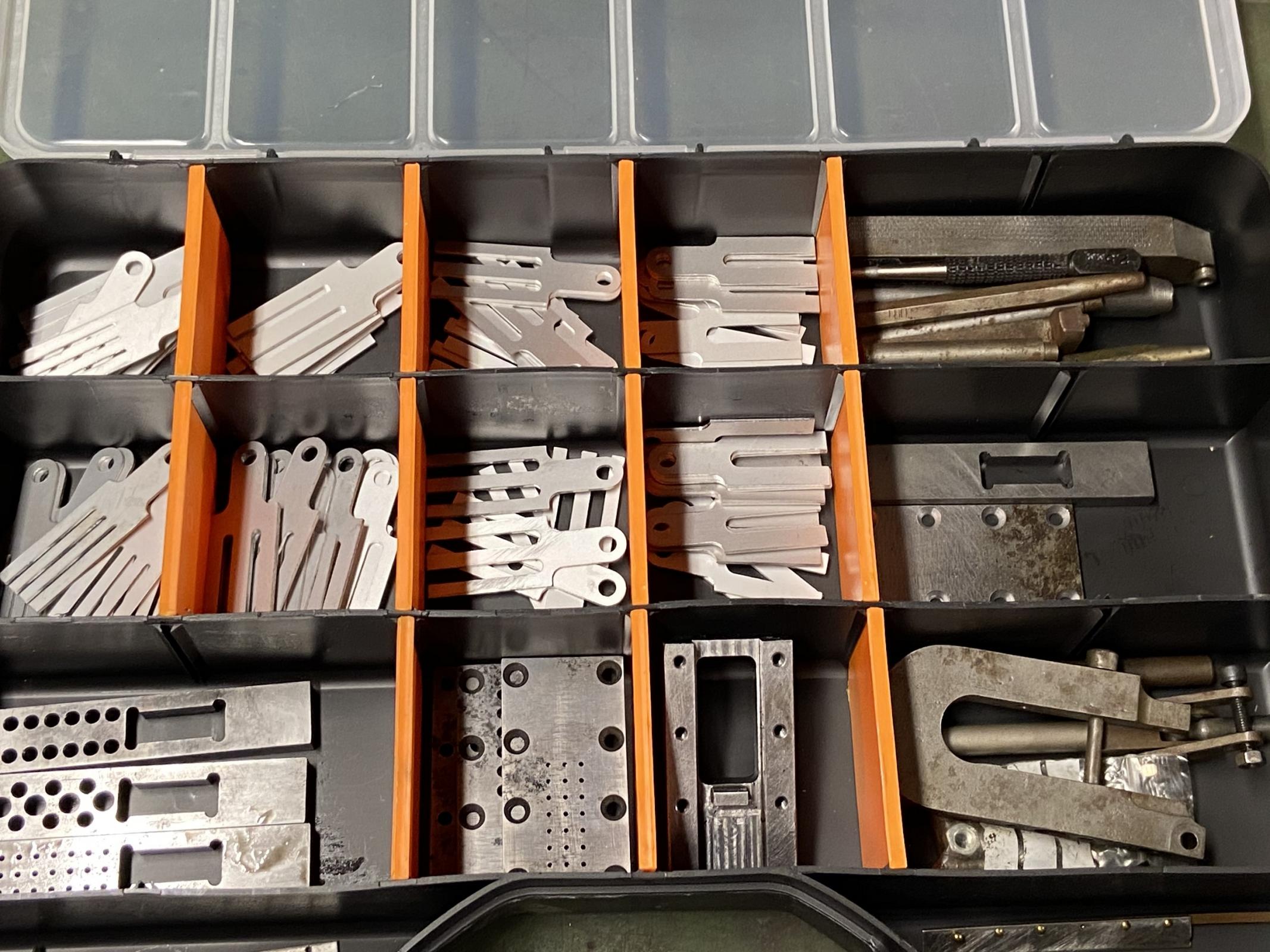

Attachment 33496 Attachment 33497
Additional cutters and the thickness of each

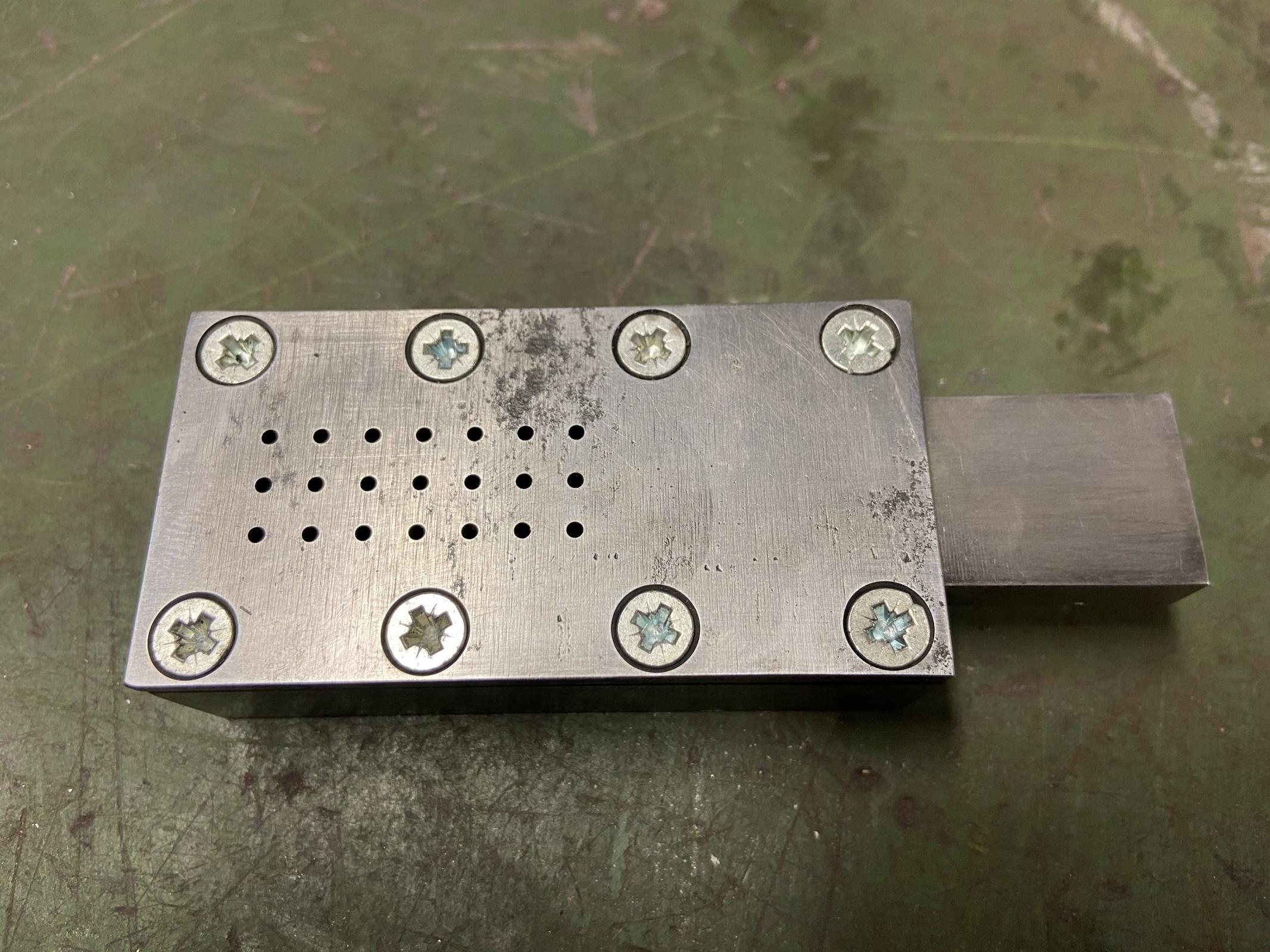

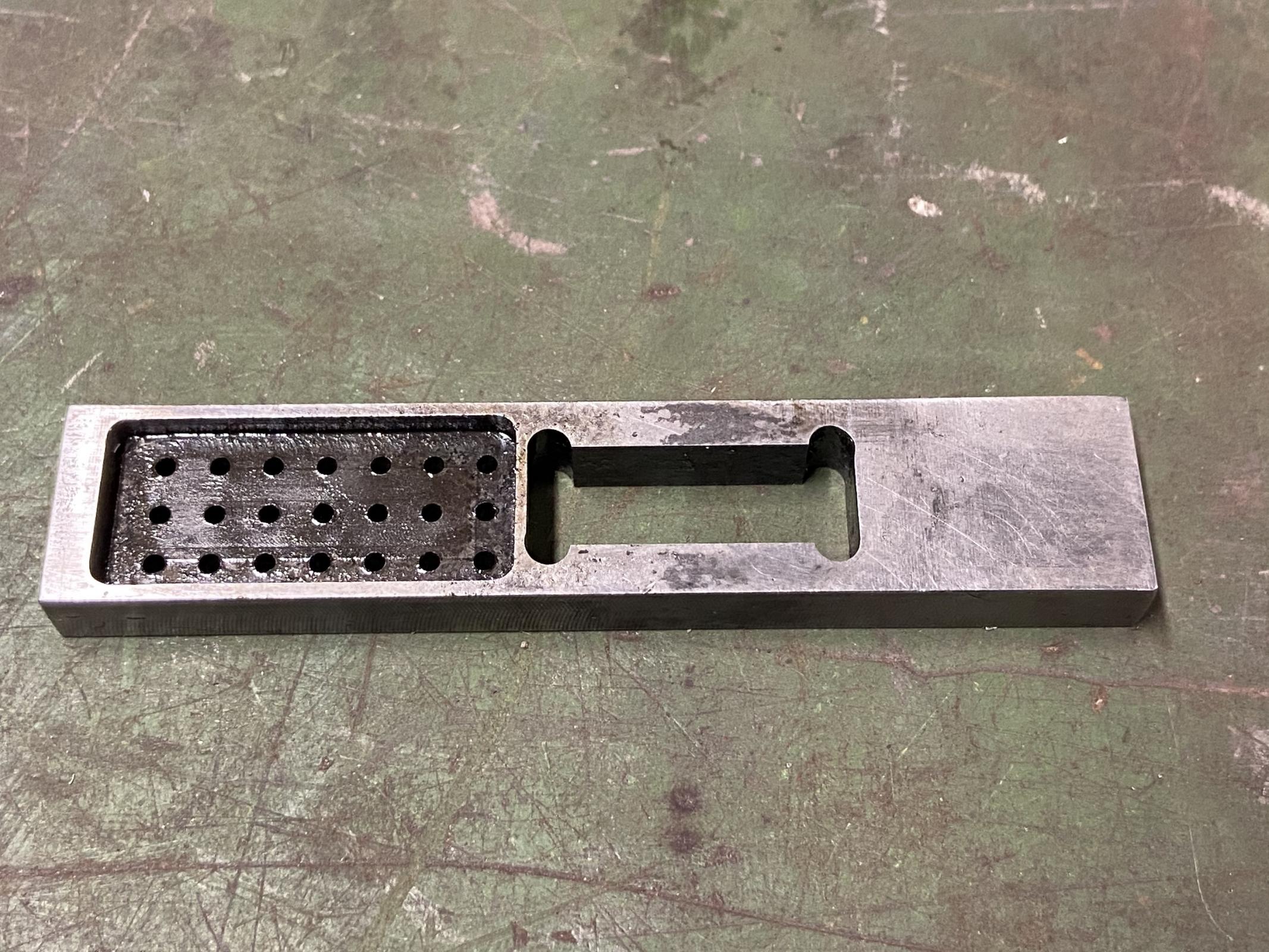

Attachment 33487 Attachment 33488
Assembled cutter and spring return in left photo
Attachment 33489
Shim in place

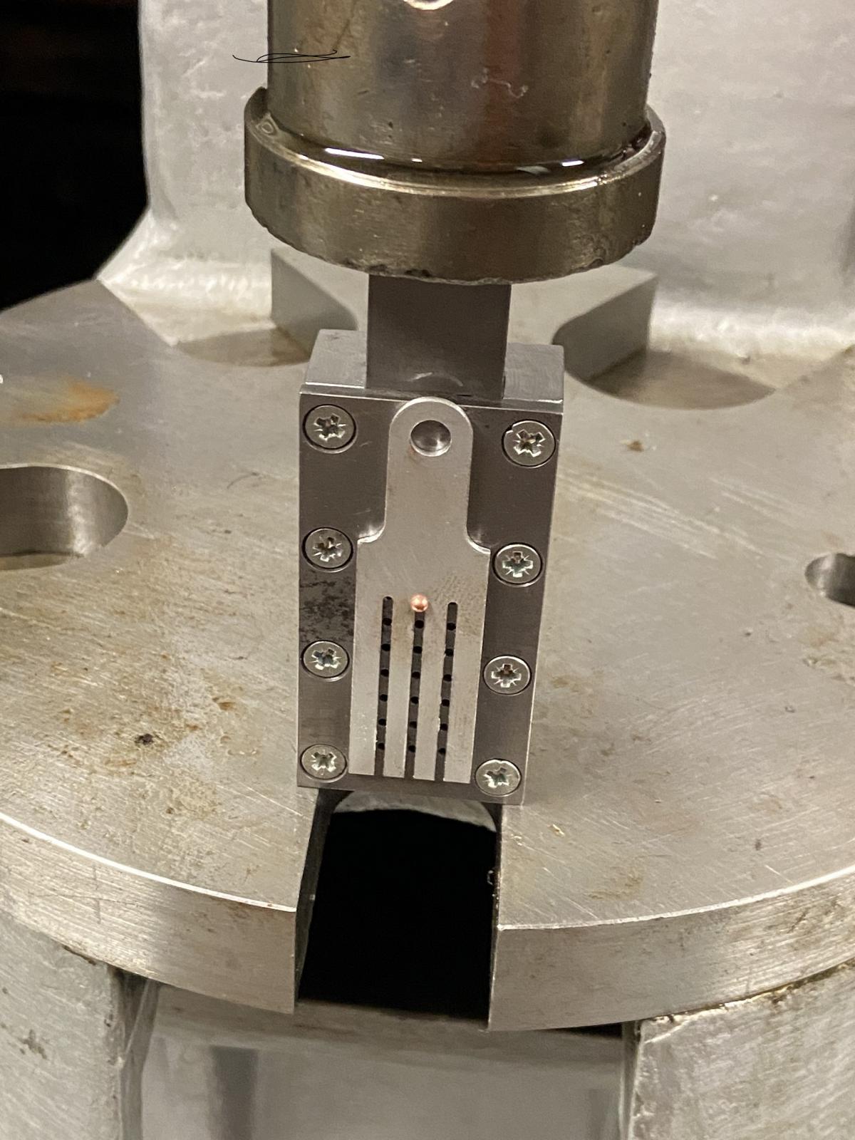

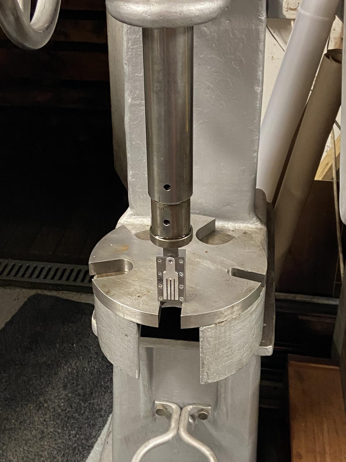

Attachment 33490 Attachment 33491
Arbour press used to apply pressure to cut

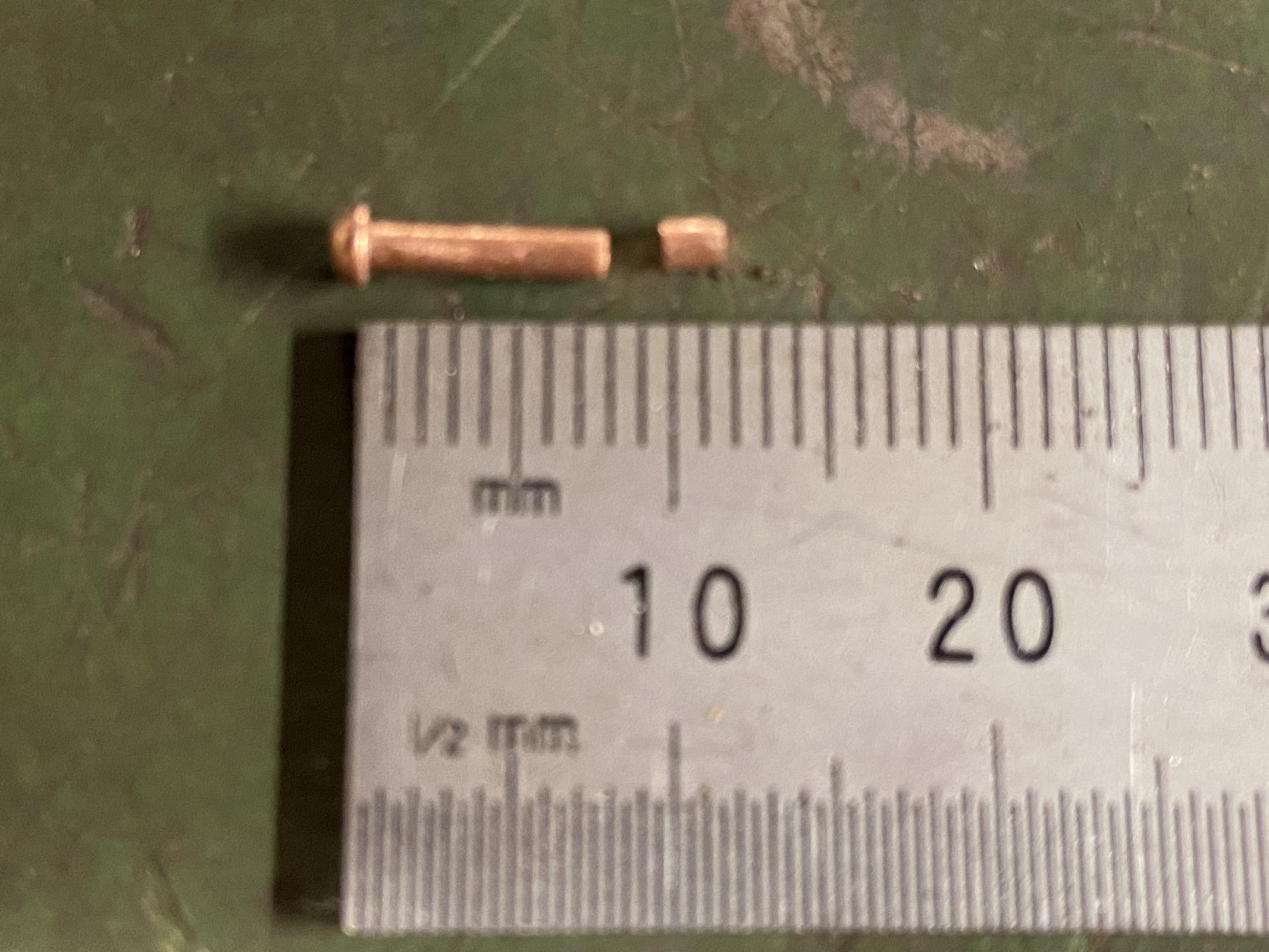

Attachment 33492
Test cut

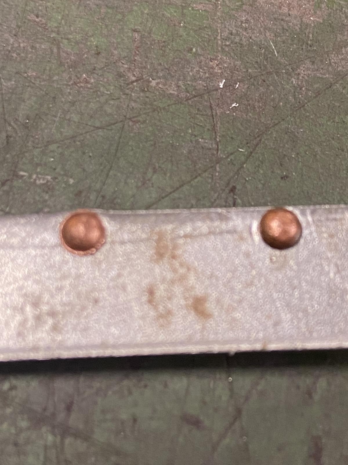

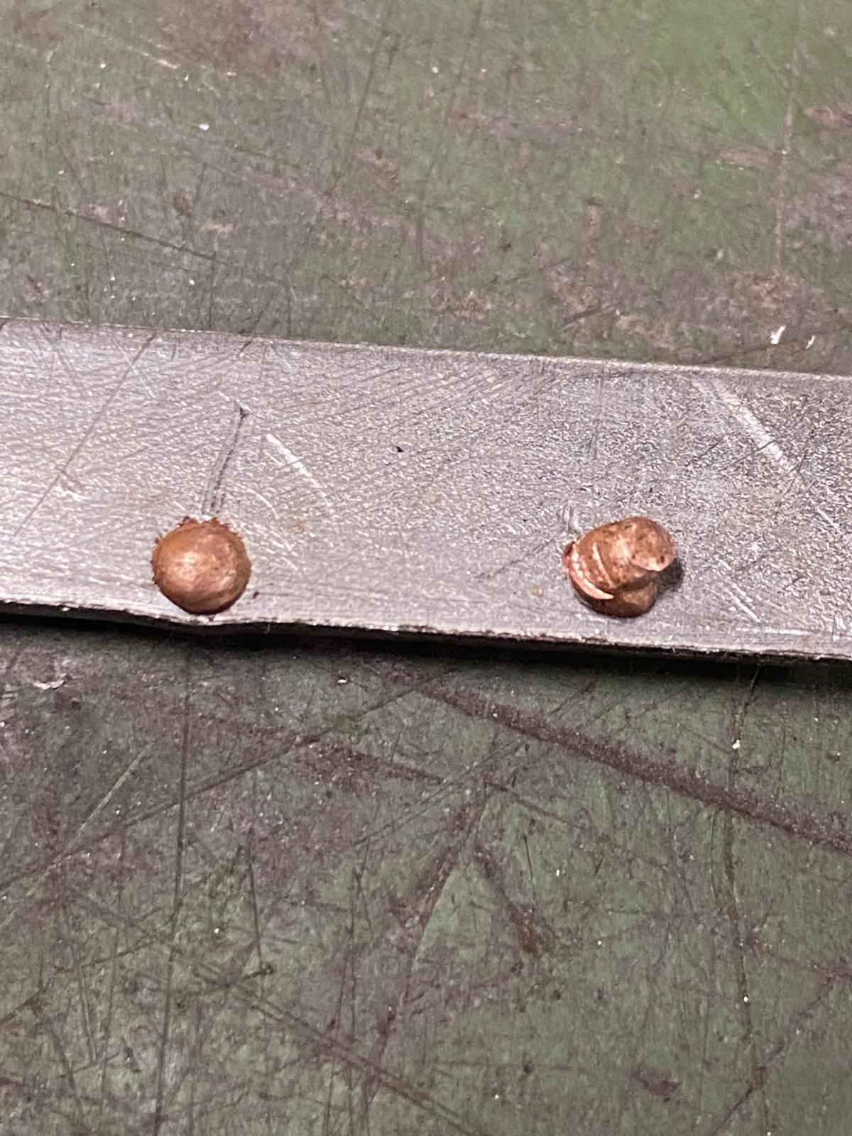

Attachment 33493 Attachment 33494
Right rivet head the rivet was to long so the head didn't form correctly the left rivet was the trimmed rivet. The 2nd photo shows the preformed head side.
