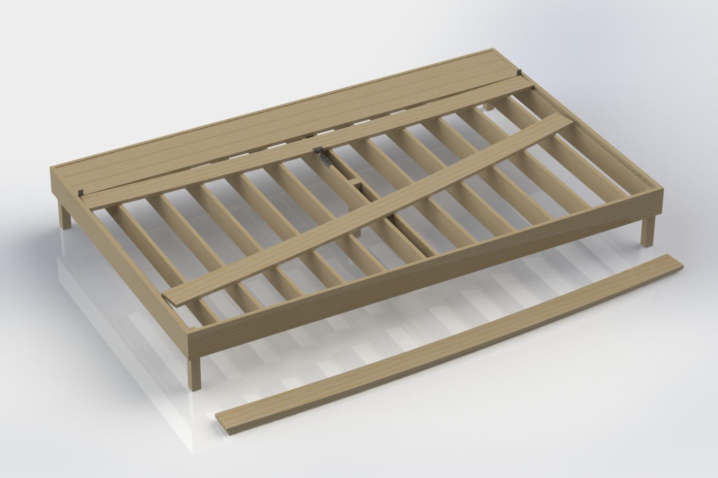

Because she was unable to leave her home, I gave her a list of what was needed and she called the lumber company and had them deliver the treated boards. Unfortunately, I was at work when they delivered and the lumber company used the opportunity to get rid of all their 'picked through' bent "Propeller" boards. (You know they type of lumber that no one wants) *SIGH*
Attachment 1148

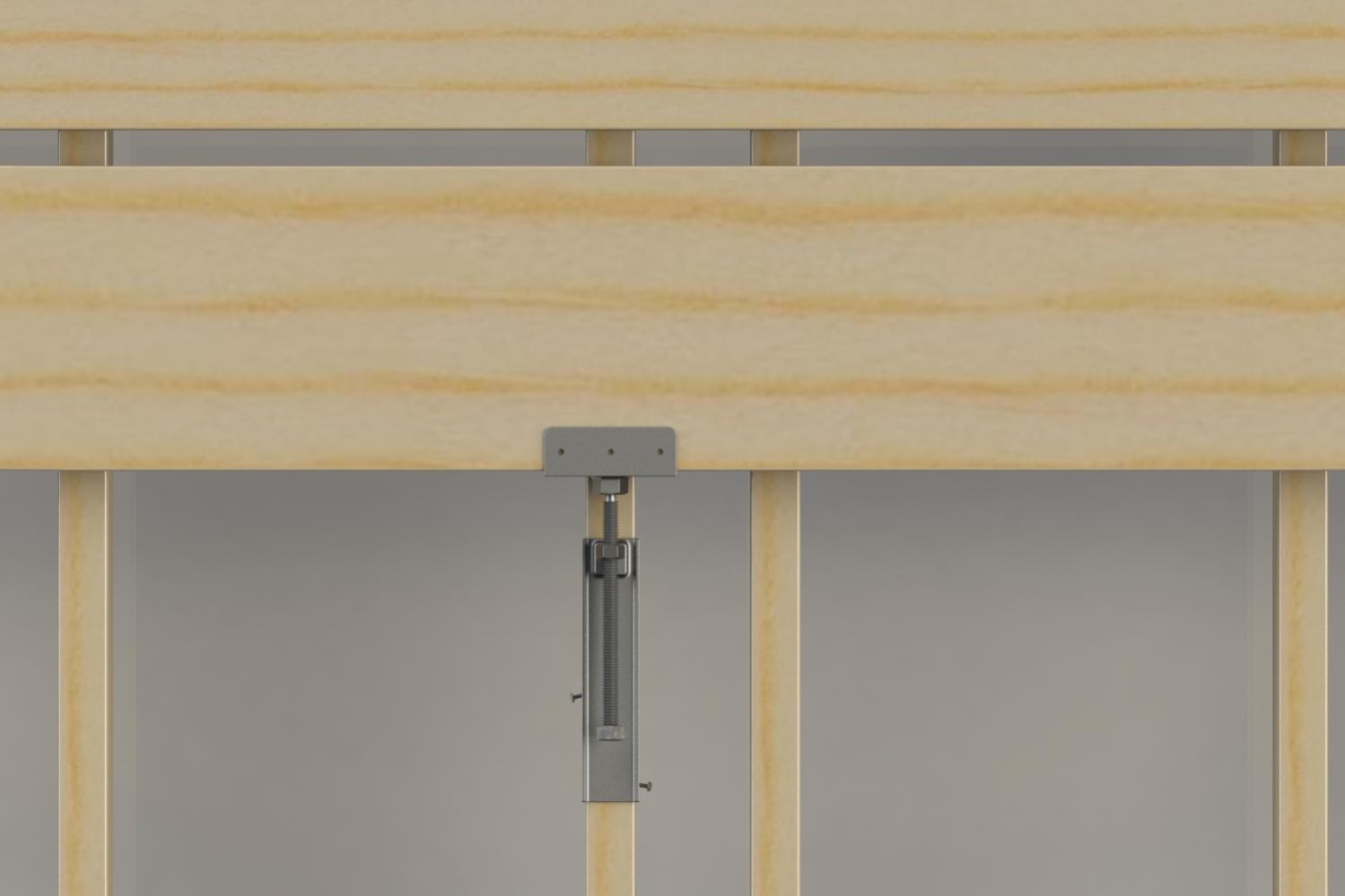

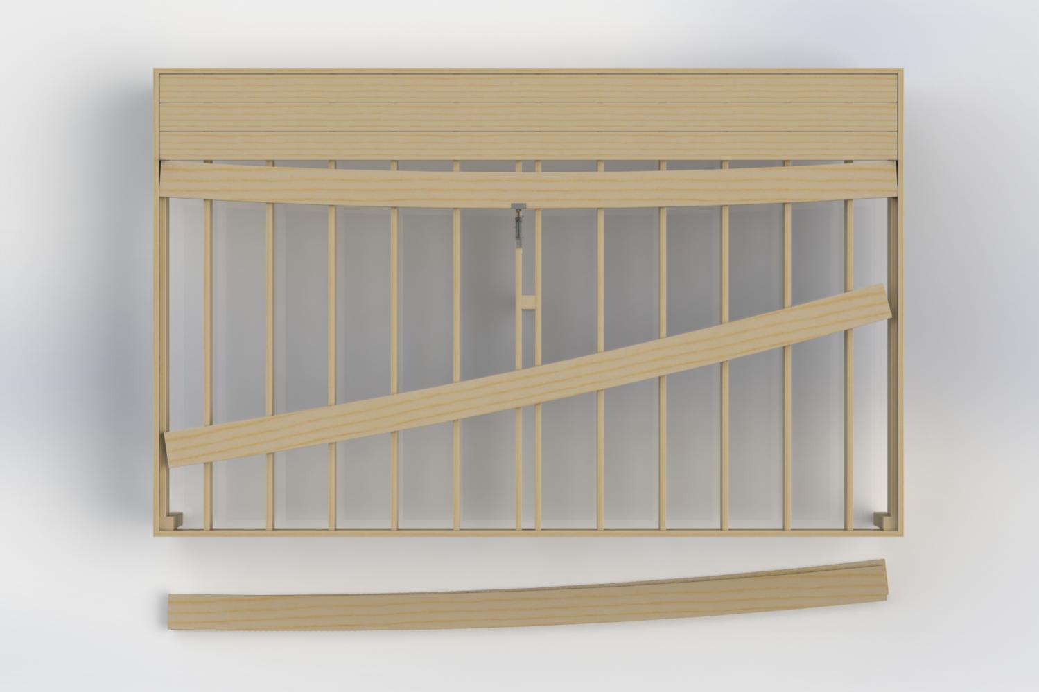

I only had the weekend to complete the project and was by myself. After viewing the large number of very bent boards and knowing I was too far to drive in town to the lumber company and still finish the project that weekend ~ I decided to take some digital photos of boards and use them anyway, because other than being crooked to the point of being hard for a single person to install, they were still structurally good quality.

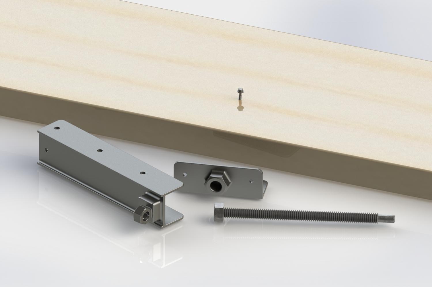

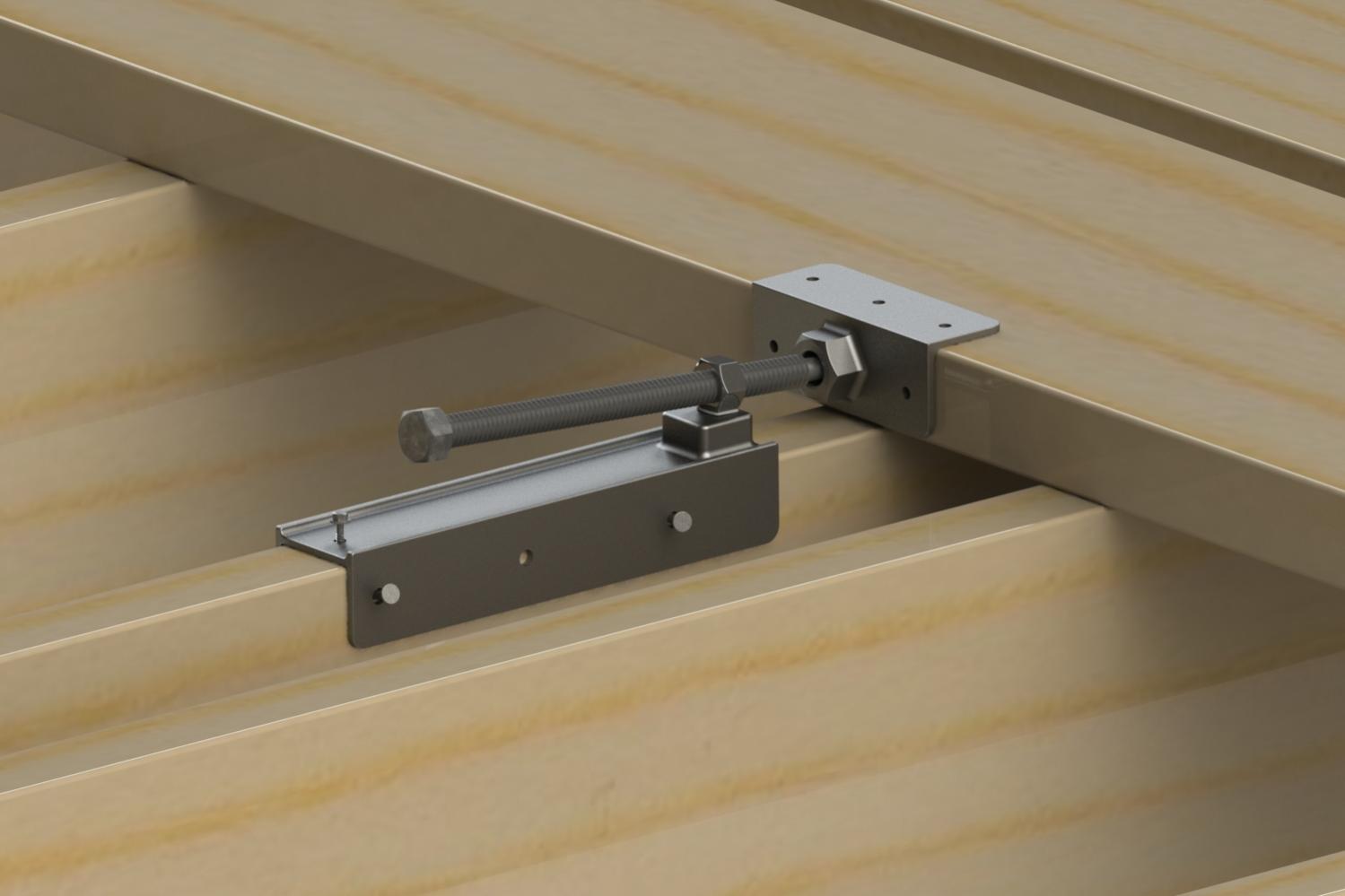

That was when I decided to make a quick metal item I could use temporary screws to attach the cross support joists that could be threaded in with a socket wrench as a way to 'encourage' the bent boards into place and stay that way as I secured the boards with deck screws.
Attachment 1149

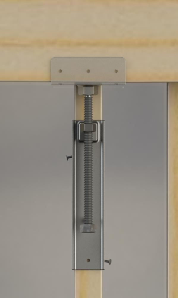

I found some 1.5" x 1/8" thick flatbar, 1.5" Angle, and some 1/2" threaded rod in my scrap bin. Cut and welded the items together as you can see in the images and slightly angled down the nut when I welded it on. On the angle iron that connects to the bent board I welded on a drilled out 5/8" nut to allow the 1/2" threaded rod to easily turn.
Attachment 1150
Drilled lots of holes in the Straightener device to allow me to partially insert deck screws (or nails) to hold it secure for each board as I went across the deck, but found out it worked with just a screw on each side and didn't need any in the angle that connected to the bent board.
I only show 1 straightener unit in the images, but ended up making a 2nd one, and each took about 10 minutes to make but saved me hours of fighting the very crooked boards by myself. I probably now have enough long clamps to do the same job, but did not at the time.
Due to the weather where we lived she requested I leave a 1/8" gap between the boards so I used a few pieces of 1/8" flatbar as spacers. Depending on what part of the boards were bent or if they were 'propeller shaped' I used one or both of the threaded devices. Basically these devices were just an extra set of hands to bend the boards back into shape while I used deck screws to permanently secure them. Over time as the green boards dried out they have stayed nice and straight on her deck to this day.
The rest you can figure out from the renderings I made using SolidWorks CAD software. The deck in the renderings is not the shape of her deck but for the Computer renderings I just used a rectangle shape to give the idea to a friend of mine that still lives up North that needs to build a deck by himself.
