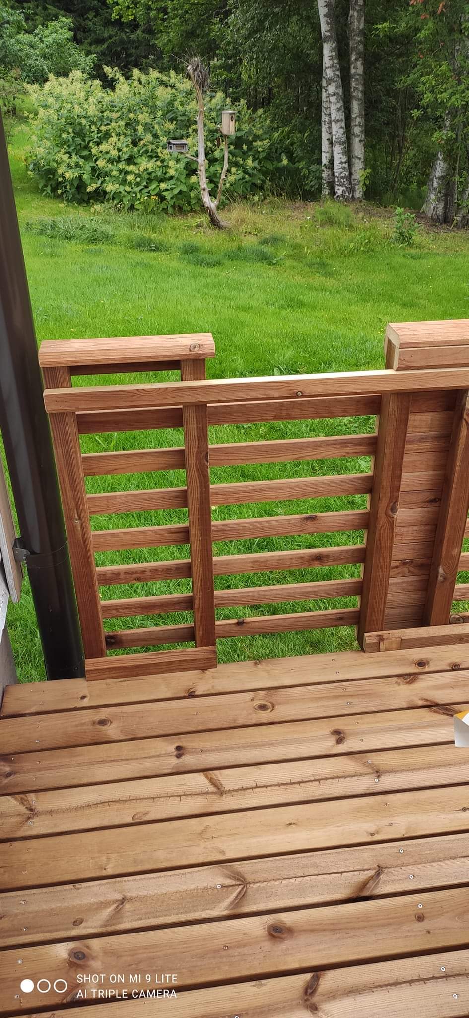

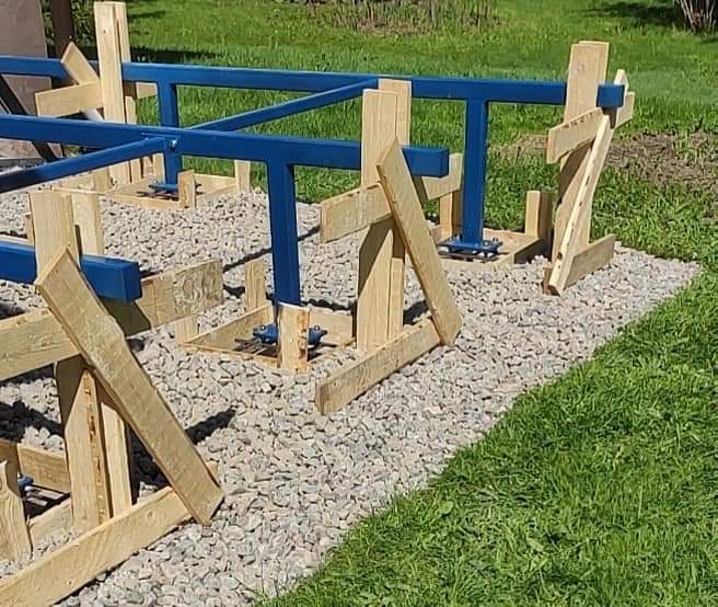

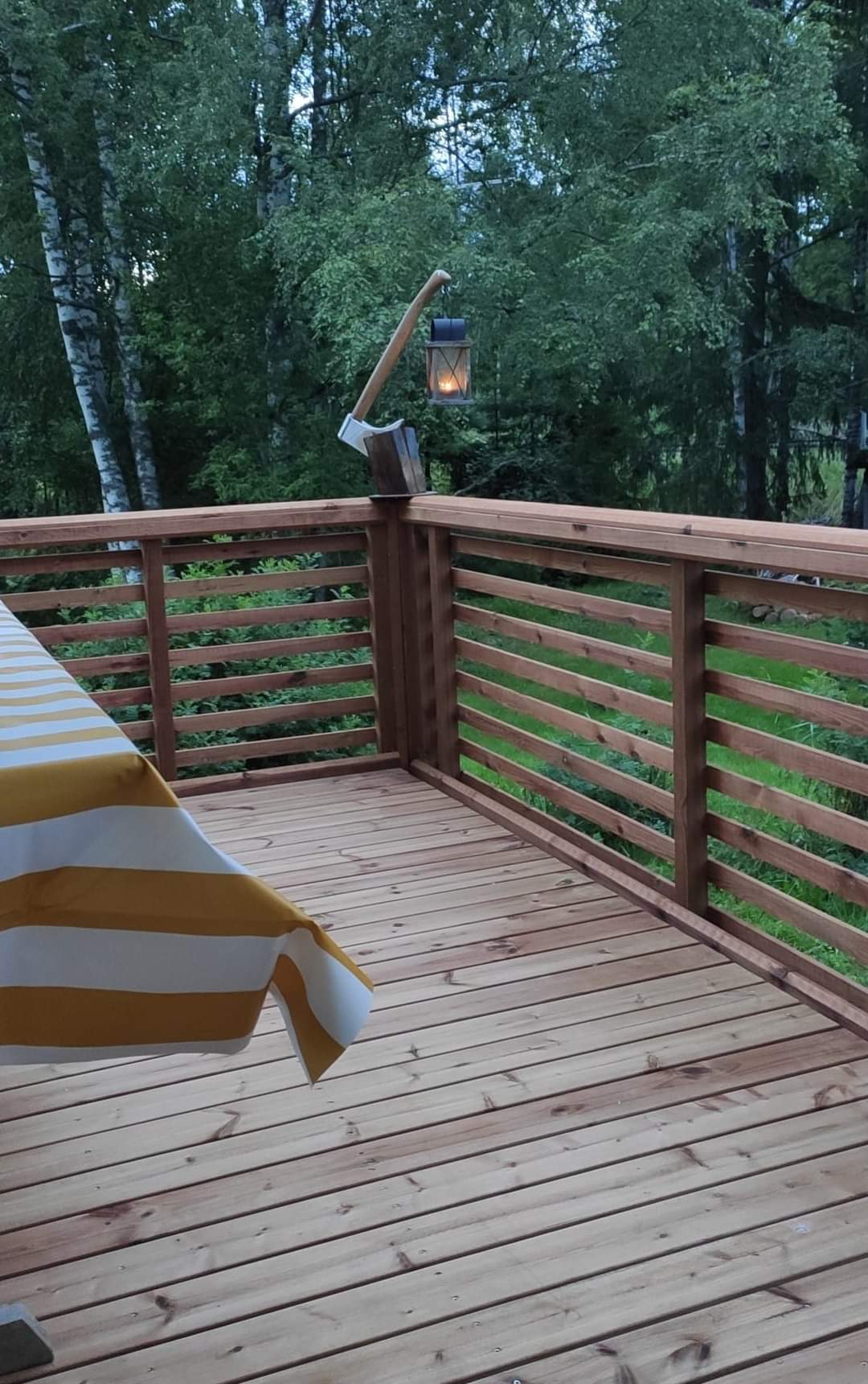

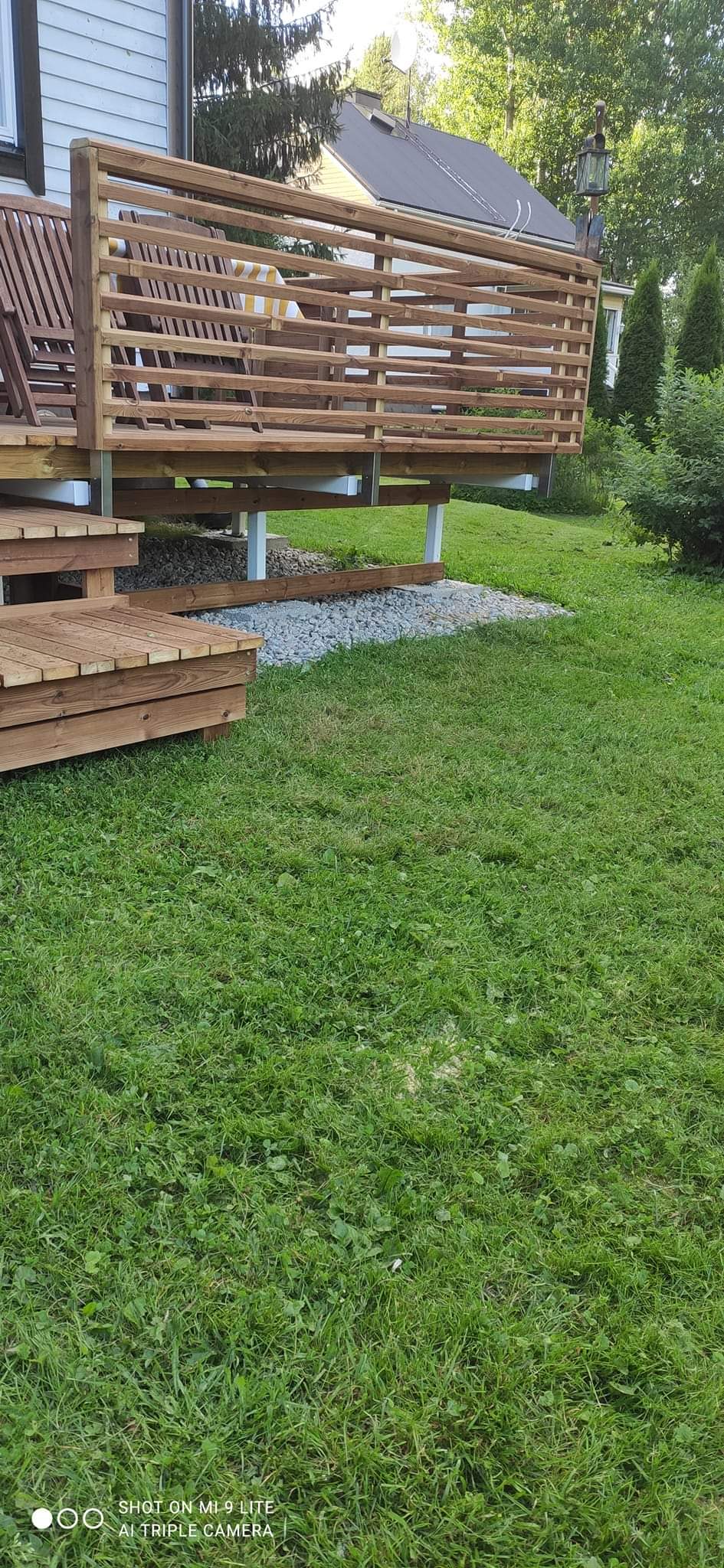

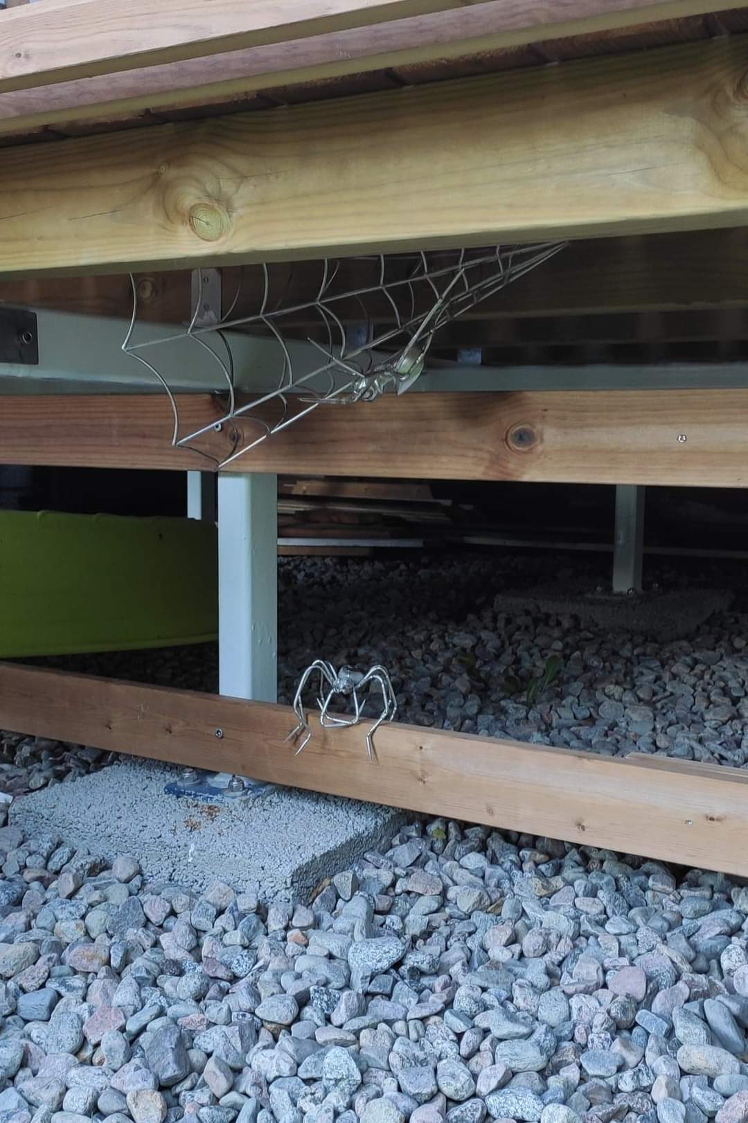

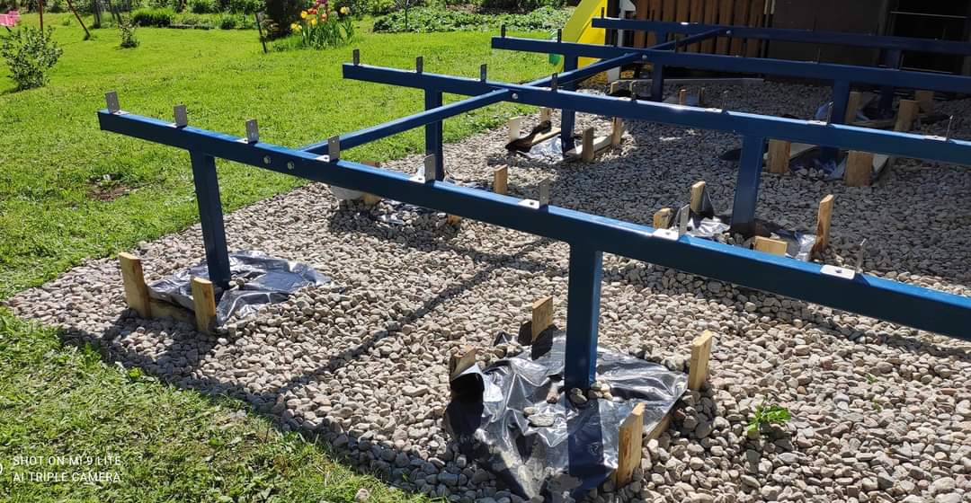

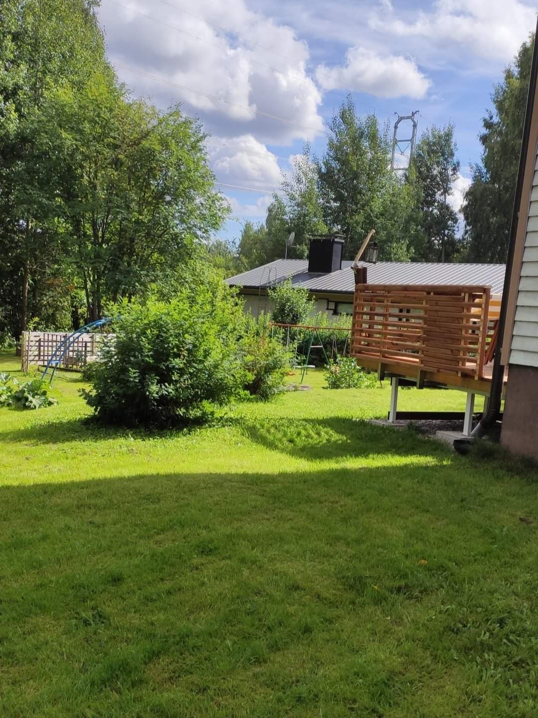

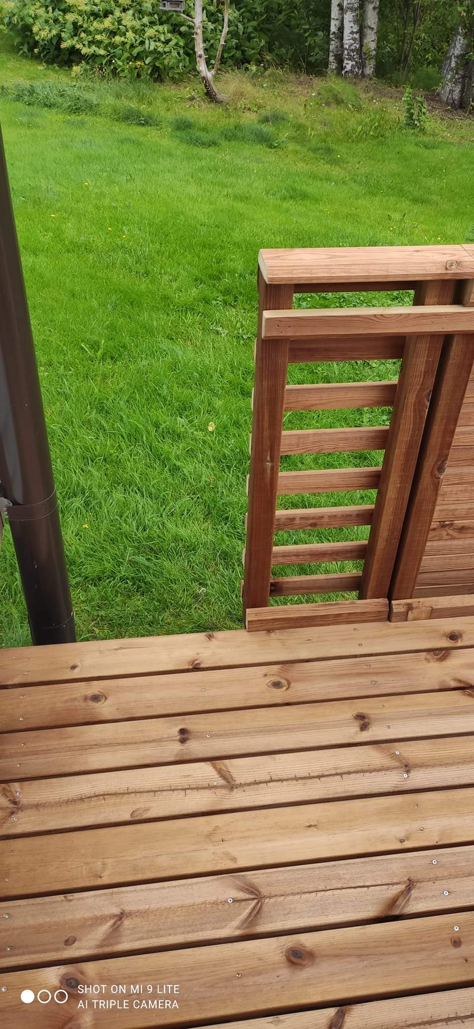

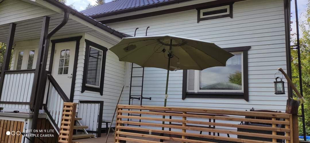

I made small " morning coffee " deck to my wife during last summer.
Because i wanted it to look slim and light weighted, i made frame of it used steel.
Material is 70mm * 50mm tubing, with 5 mm thick wall.
Attachment 43862
Attachment 43863
Attachment 43864
Attachment 43868Attachment 43869
Attachment 43865
Attachment 43866
Attachment 43867
Blue paint is a base coating. Tubings are also rust protected from the inside.
