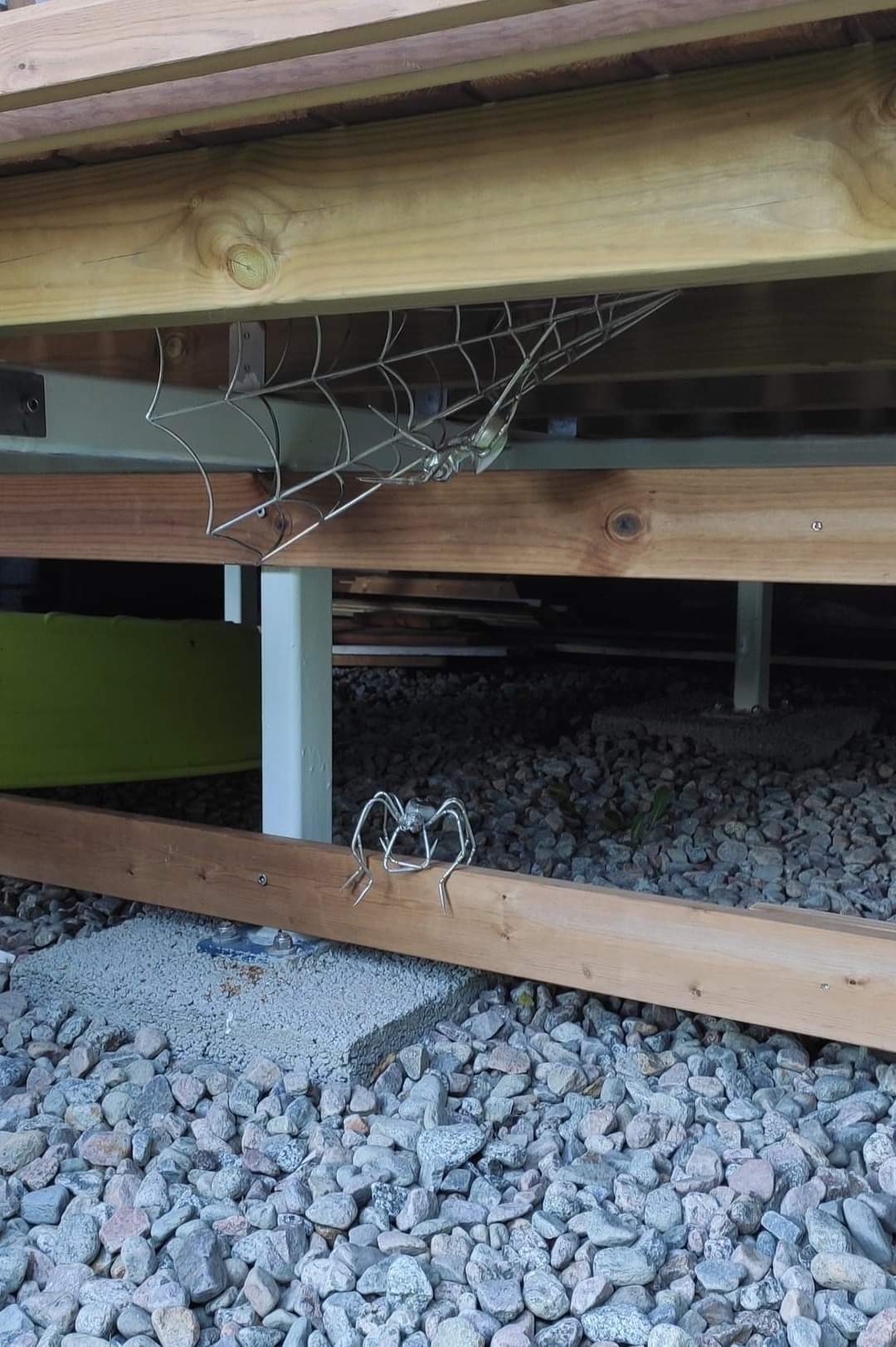

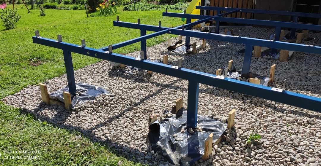

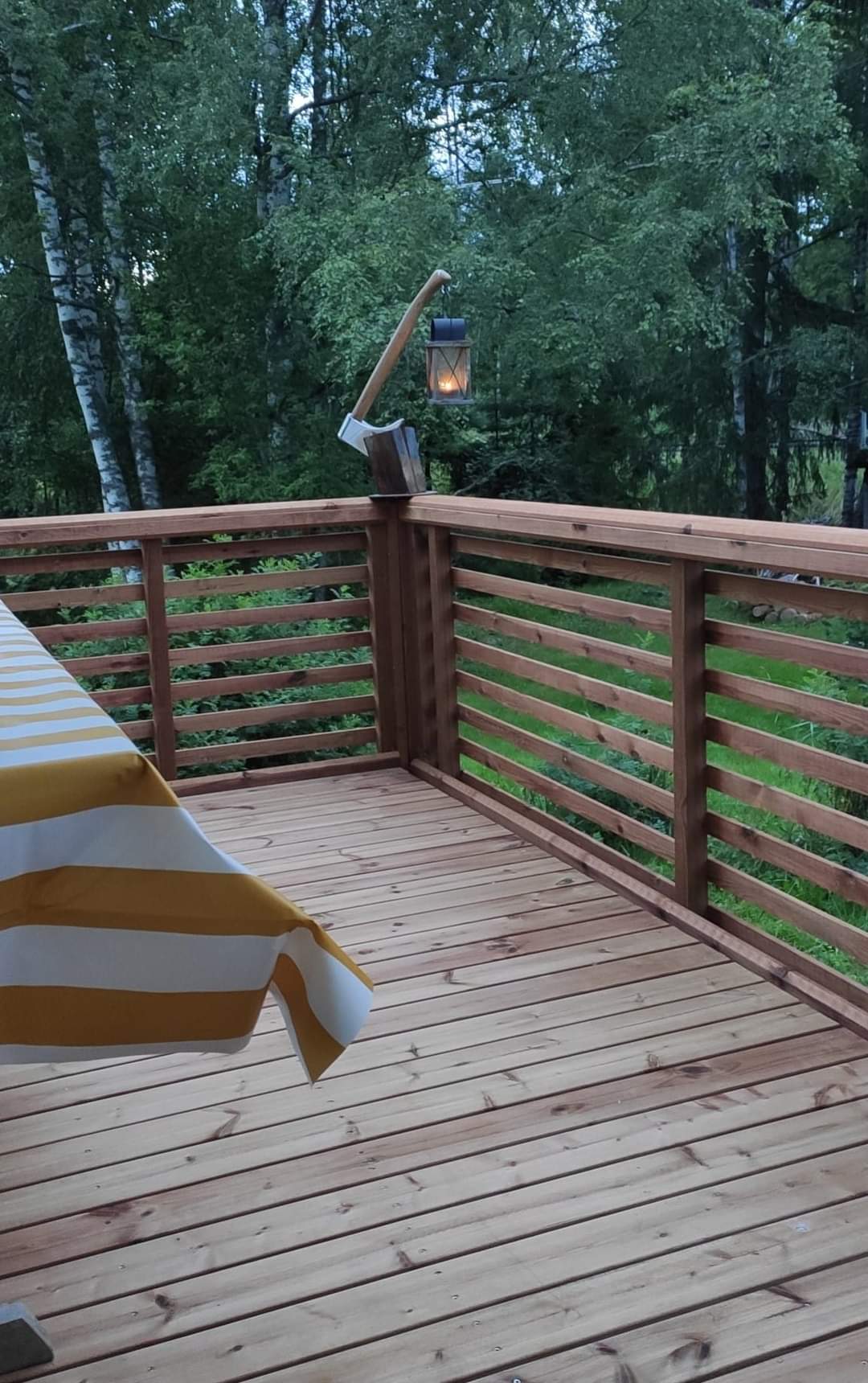

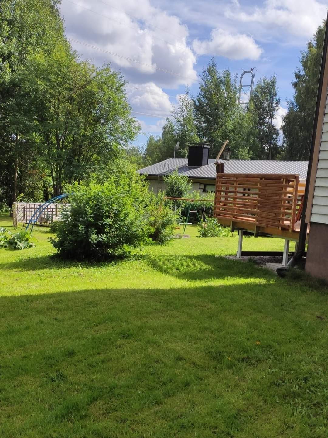

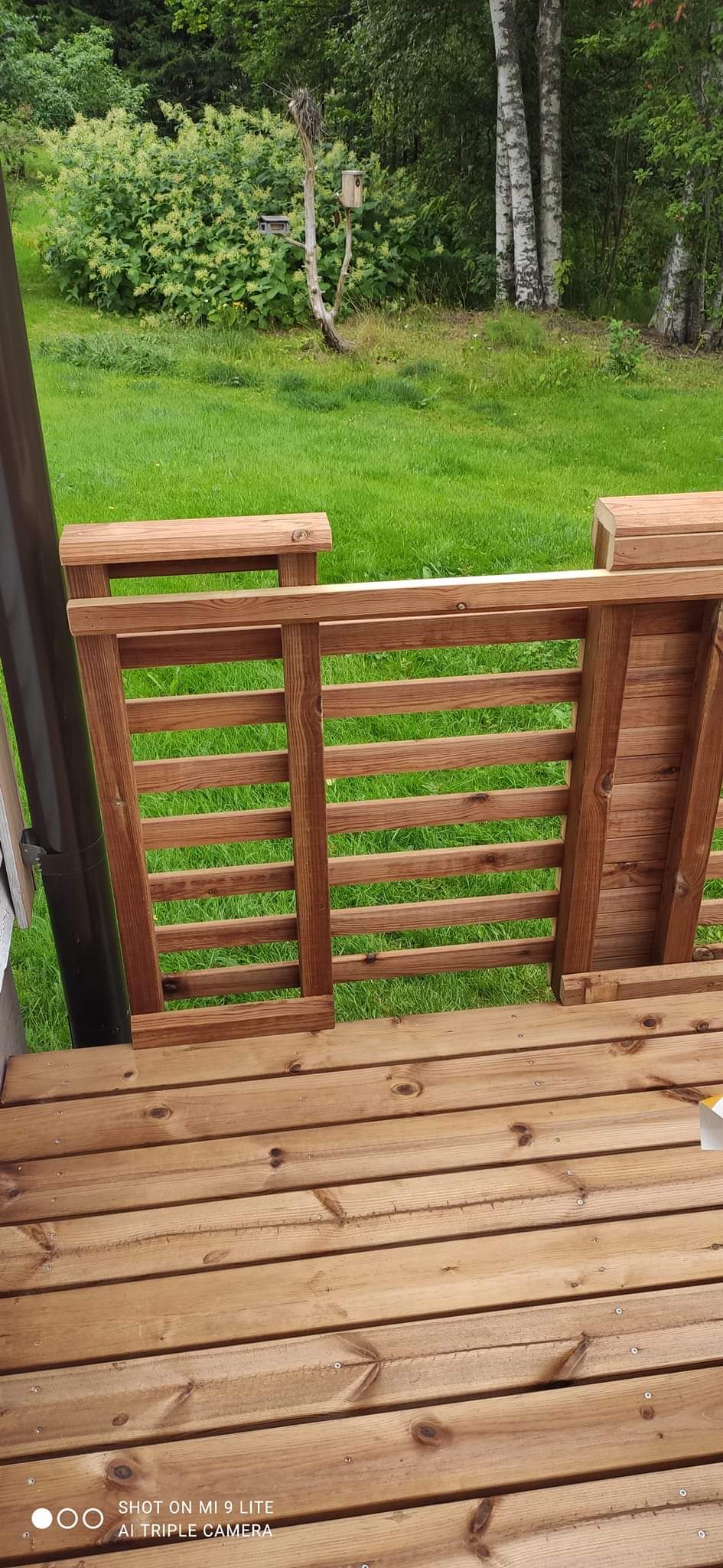

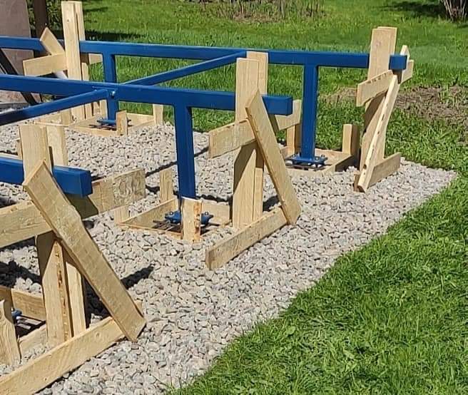

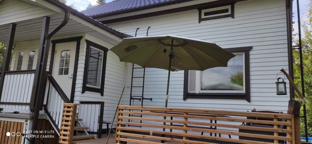

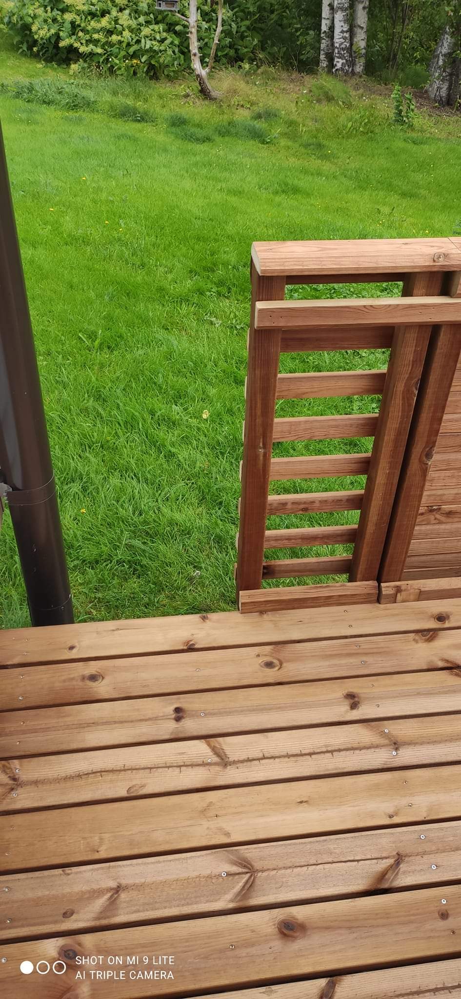

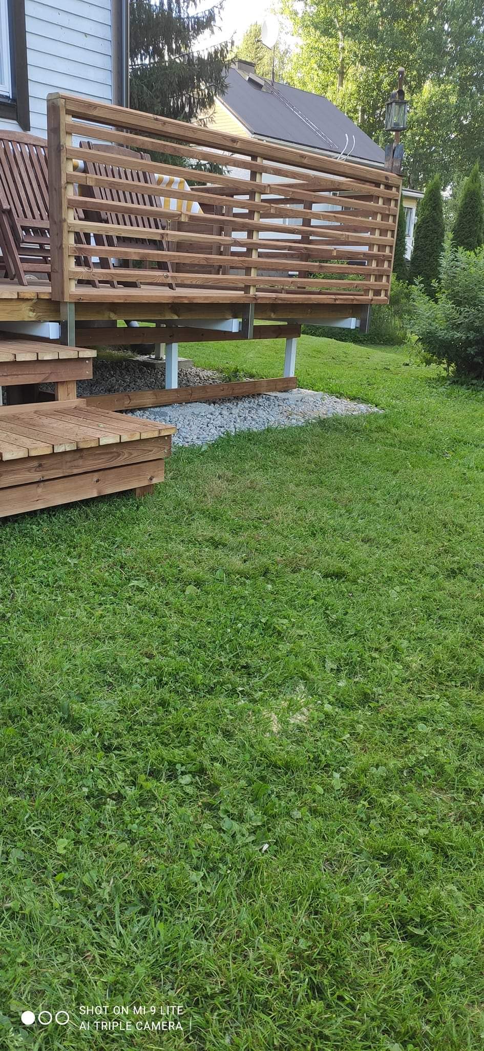

    I made small " morning coffee " deck to my wife during last summer.
    Because i wanted it to look slim and light weighted, i made frame of it used steel.
    Material is 70mm * 50mm tubing, with 5 mm thick wall.

    Blue paint is a base coating. Tubings are also rust protected from the inside.
