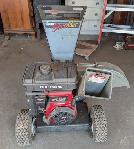

I have 40+ year old Craftsman 5hp chipper shredder. It has had lots of use,
but still runs good.

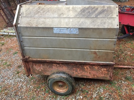

I have the collection bin from an old TracVac I picked up along the road a
while ago. It just happens to fit the old Sears yard chart, also from someone’s trash.
Attachment 50063

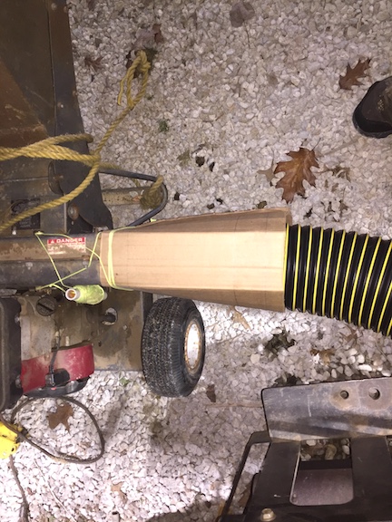

Since I already have the major components, I may as well make a leaf vac.
The leaves are piling up and rain is headed this way. Since I do not have
time to build the whole thing right now, the first step is just getting the leaves

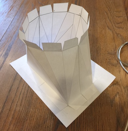

from the shredder into the cart. That requires a rectangle to round transition
to adapt a hose to the shredder outlet. Made a quick cardboard mock up to start.
Attachment 50064
Attachment 50065

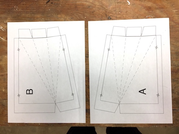

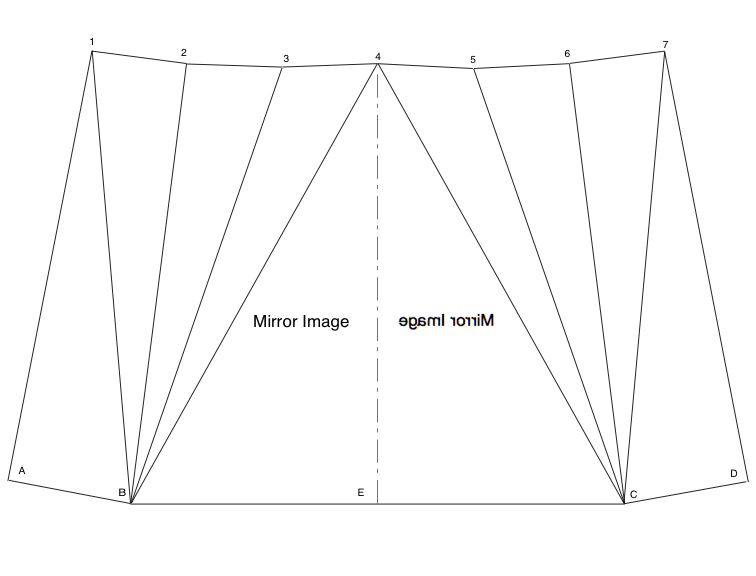

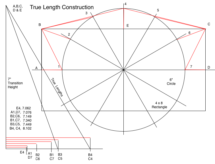

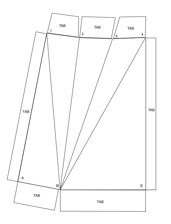

I have made transitions for HVAC a long time ago but needed a refresher for
layout. I found one on YouTube, search for "Basic square to round triangulation "
The chipper discharge is 4 x 8”. Typical leaf vac hose is about 6” ID. The transition
stretch-out, or pattern, was made with a simple CAD program.
Attachment 50066
One half of the stretch out
Attachment 50067

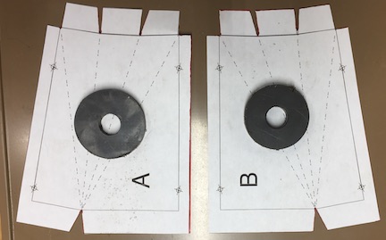

Adding tabs to a 1/4 pattern for making connections.
Attachment 50068
Patterns A and B
Attachment 50069
The 2-A’s and 2-B’s held together with tape looks right

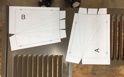

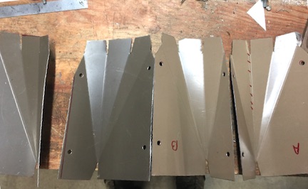

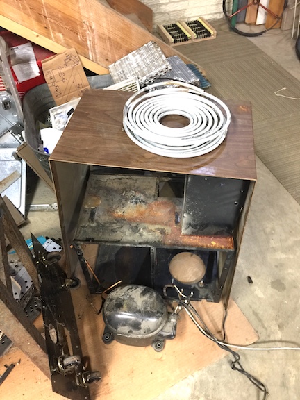

This is where the dehumidified became involved. Looking through my stock of r
eclaimed appliance sheet metal, found enough of appropriate thickness for this project.
Attachment 50070
The patterns make it easy to select suitable pieces from the pile I have.
Attachment 50072
Magnets hold the patterns in place and a prick punch to mark line ends. Then
connected the marks with a scribe.

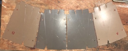

Attachment 50073

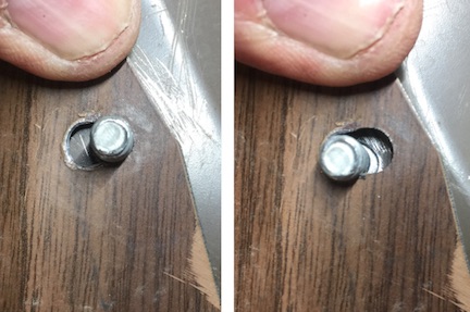

Holes were made while still flat and checked to be sure the fit properly. Rather than
make the transition one piece, it is 4 sections which bolt together. This makes the
required pieces smaller, and with slotted bolt holes, adjustable.
(Like Crusty’s sig line, “If you can’t make it precise, make it adjustable”)
Attachment 50074
Attachment 50075

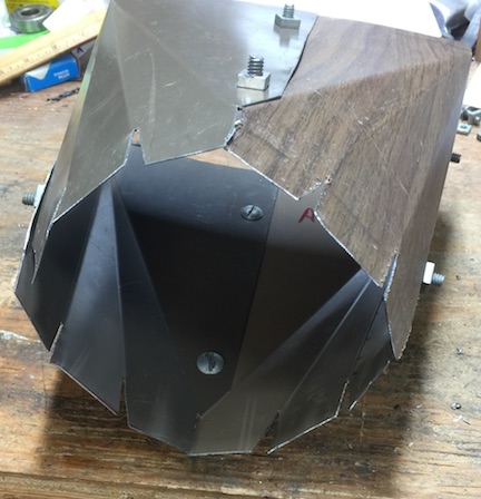

Then off to the brake. The round end has 12 segments which would make each
bend 30˚. BUT the 4 points that are centered over the sides each require 2 bends,
for a total of 16 bends 22.5˚ each.
Attachment 50076
With the pieces bolted together some tune-up with a hammer and anvil brought it into shape.

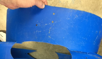

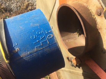

Plastic strips cut from the side of a 55 gallon drum form couplers. A heat gun softens
the material and large hose clamps to hold it in place as it cools.
Attachment 50078
The photo is distorted, the coupler slides into the bin inlet
Attachment 50079

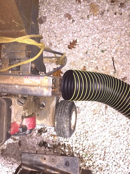

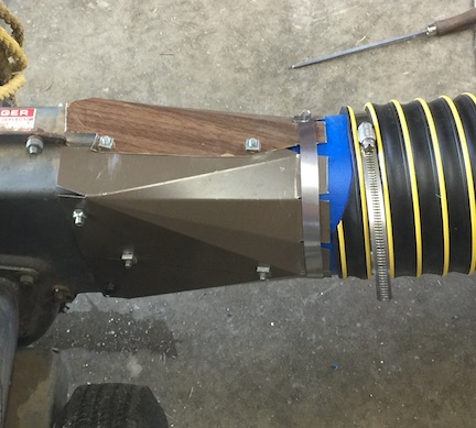

The transition is attached to the chipper using two existing threaded holes and making
two additional holes for nuts and bolts. I planned to slip the hose over the transition,
but the tabs were too short for a secure fit. The hose kept slipping off.
Good thing it was adjustable
Attachment 50080

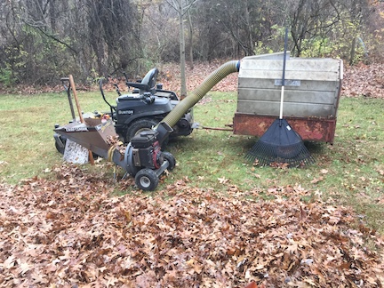

For this year I blew into a windrows with the mower, then shovel them into the hopper.
It its working pretty good. The 6” hose I got was 25 feet long. Wet leaves from the
recent rain, and the LONG horizontal section laying on the ground lead to some clogs.

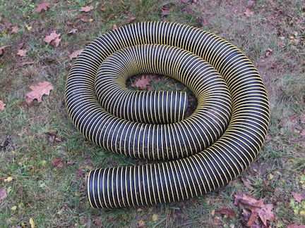

Attachment 50081
With a long section removed, it works much better. This piece will be used as a
vacuum hose to clear leaves from flower beds, etc.

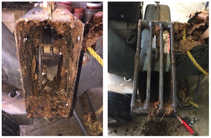

It does not like soggy leaves. There is a grate in the discharge that keep branches
in the chipper into they are small enough to escape. Wet leaves are sticky and block
the grate if they are fed too fast. With dry leaves the grate can be left in place
which grinds the leaves much smaller. Shown here with the grate removed.

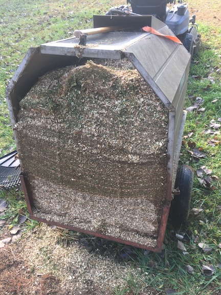

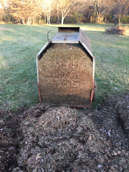

The bin holds almost a cubic yard of leaves,
Attachment 50084
Or chipped tree branches.This is a load of pine chips.
Attachment 50085
