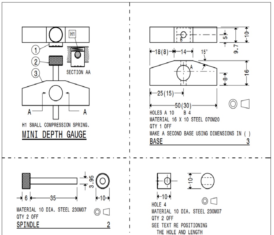

A little service:
Harold Hall's page of this particular gauge: Miniature Depth Gauge 1
Drawing of same: http://homews.co.uk/DepthGaugeMini01.pdf
Attachment 30229
