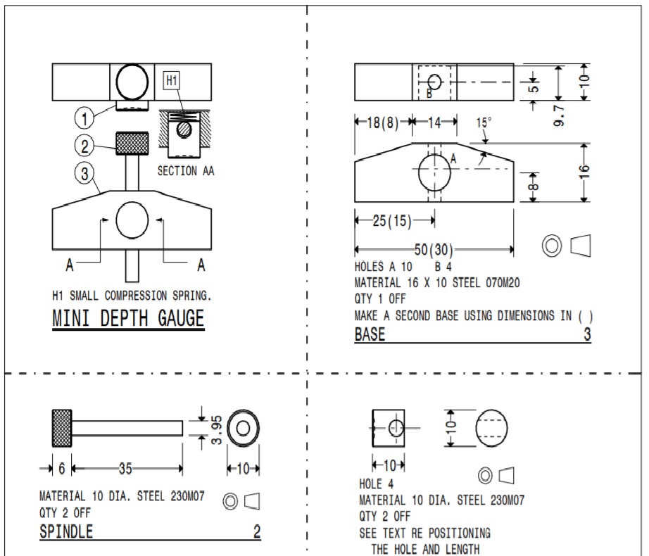

    A little service:
    Harold Hall's page of this particular gauge: Miniature Depth Gauge 1
    Drawing of same: http://homews.co.uk/DepthGaugeMini01.pdf
