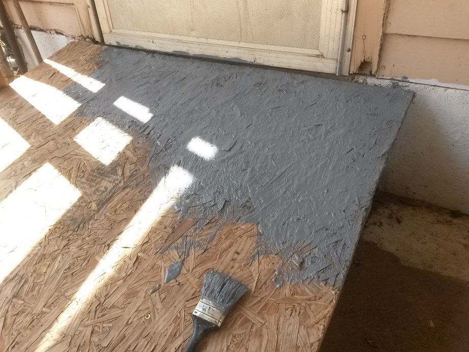

I screwed down a 1/2" OSB over the top OSB is not as smooth as ply and weathers well.

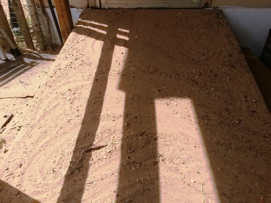

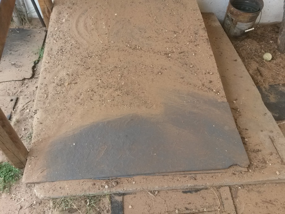

the other day I got one of those wild hairs and decided that I would improve it even more. So I mixed up a couple qts. of battleship grey paint with 3 lbs of sand then painted the surface I lathered it on thick really working the mixture into the surface I use the entire amount on the 4ft by 5 ft ramp After painting I covered the whole thing with sand and rubbed it in as well.

Attachment 30619
Attachment 30620
Attachment 30621
