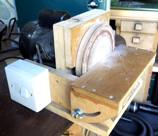

Why not make it direct drive?
It would have been too long for my shop. I have lot and lots of vertical room but not so much lateral room. A guy in Australia made one from my plans but it was free standing. I wish I'd thought of that.
Aprox 6000 RPM. Pulley size is not cast in concrete though. The builder can use whatever pair of pulleys he or she is comfortable with. The rigid disc I am now using (rather than a paper one) is rated for 6000 RPM so I set up my pulleys to get that speed. I had originally intended it for a rigid disc but a friend and co-conspirator (Colin) expressed concern that if one of those detonated we'd all be killed. After a month or so of changing paper discs, I'd had enough and switched to a rigid disc. That was in 2012 and the original one is still in use today. I'm keeping close tabs on it but, even If it detonates, the shield is made of really heavy stock and will contain the debris.
