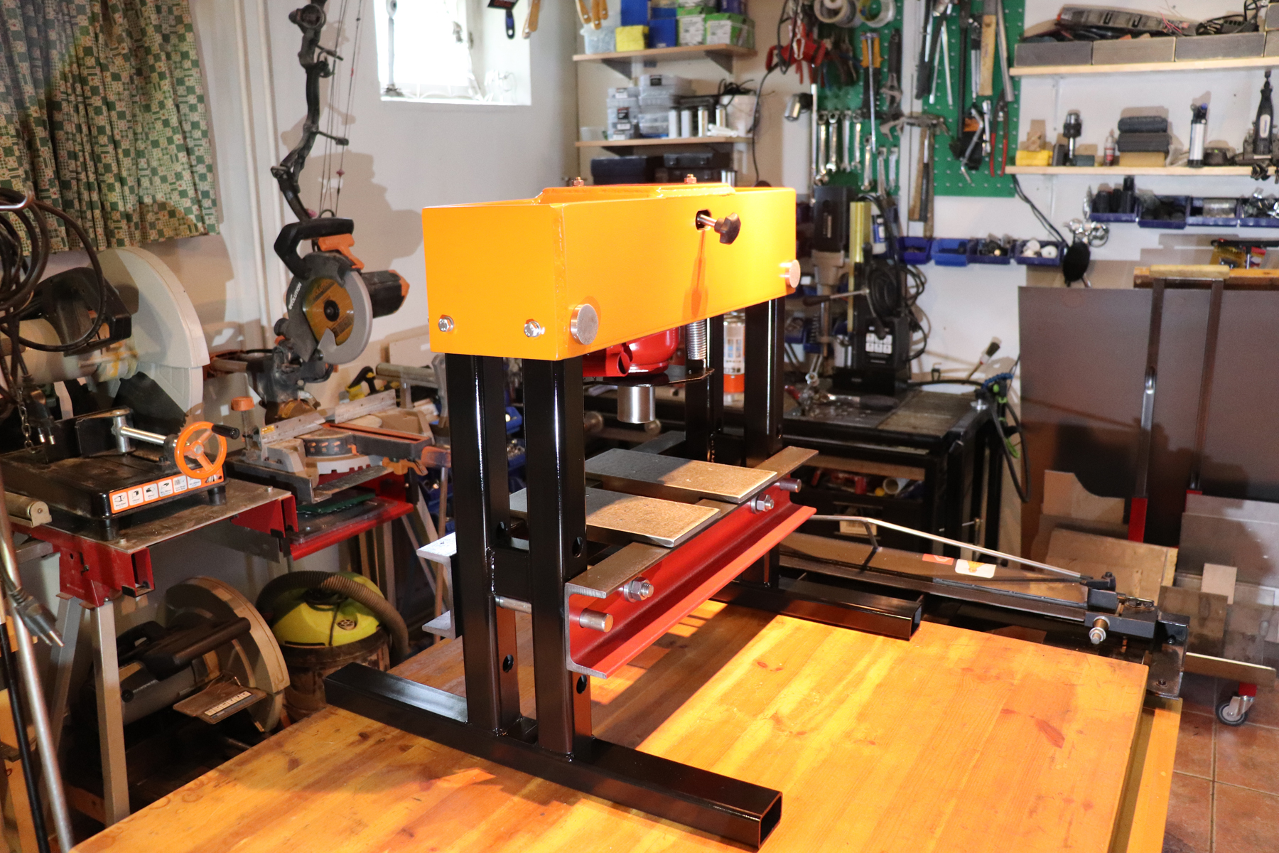

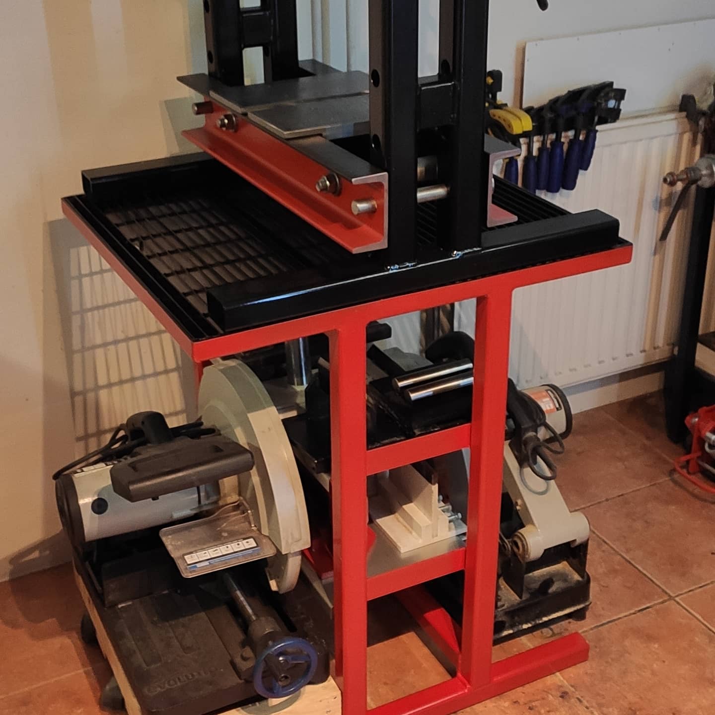

Diy 20 ton hydraulic bench top press
My new video is about making 20 ton hydraulic bench top press.
https://youtu.be/k_Cwoovww4E
Top is connected to the frame with 20mm ldx pins and four M8 bolts. ( bolts just spline axles against frame, and remove clamp )
Attachment 39513

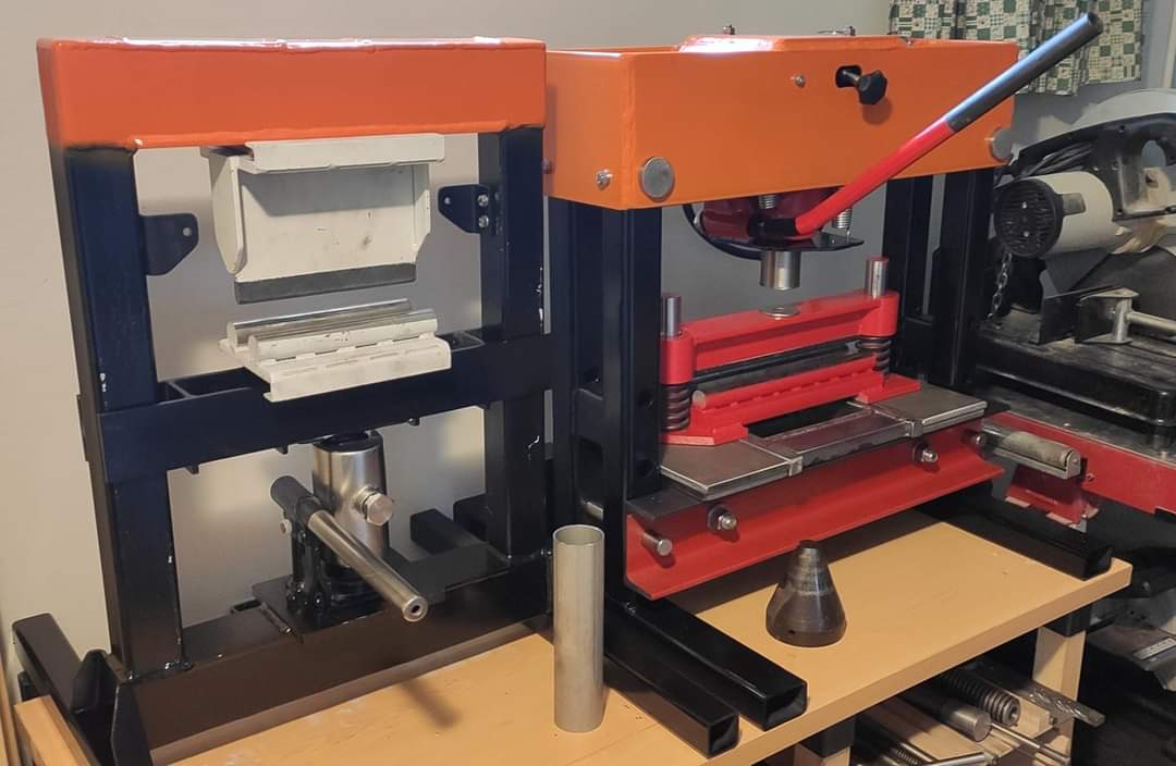

Press can be disassembled easily, this helps if i need to carry it out from our basement.
Also, frame is designed to be used with 30 ton jack. Now i have room to upgrade it.
( only bed needs to be replaced with stronger one ) Making upgrade is easy, when i can remove top from the frame.

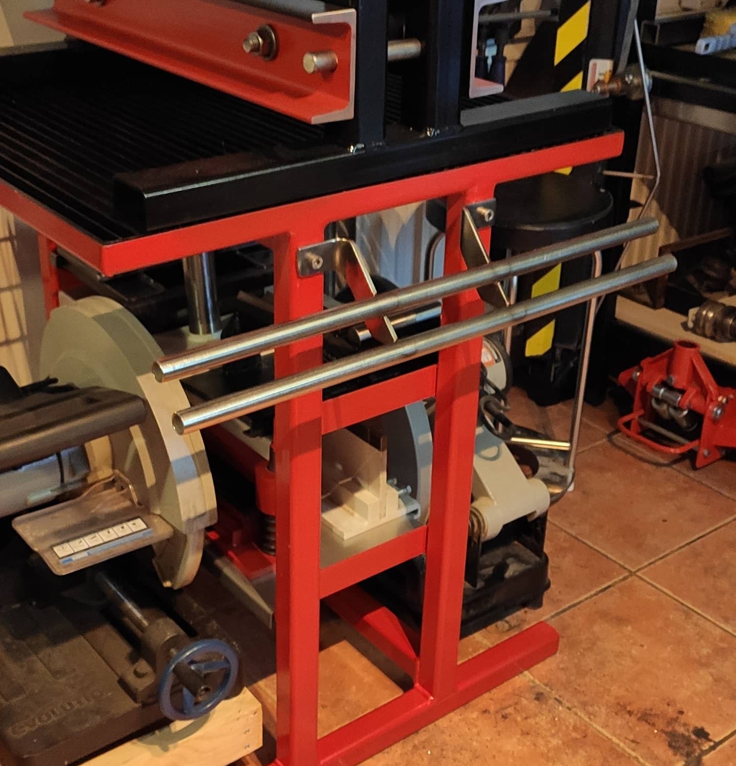

Attachment 39514

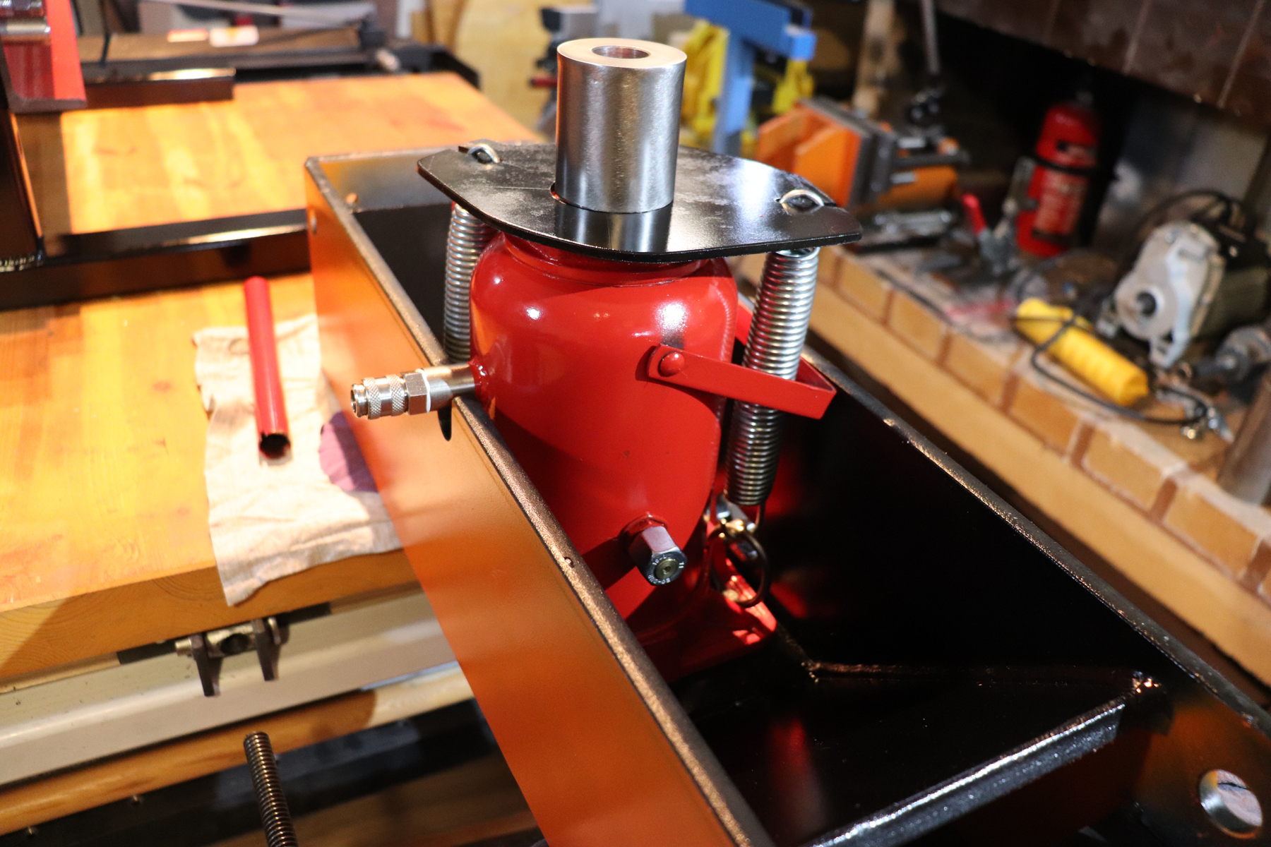

Jack after modification.
Weld inlet is for filling the jack. That can be leave out, and use " breathing valve " for filling instead.
I just liked to have easy access to fillport.
