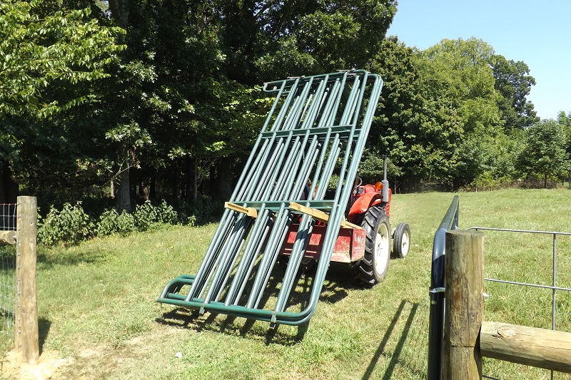

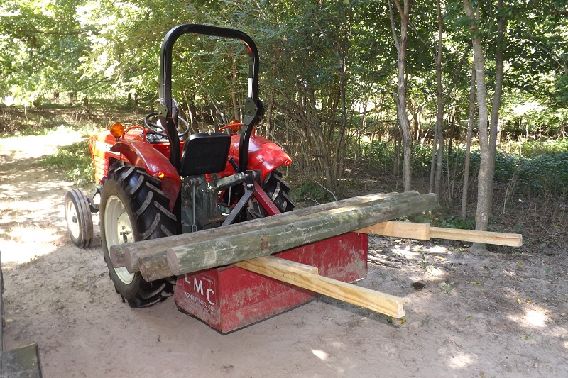

    I'm poor, but not without rich ideas. I turned my box-blade into a BIG carry all tool.
    Yanmar with a BIG lift
    FYI, the tractor has two 42-lbs weights on the front. It helps to keep the front end from raising off the ground.
    FYI, I will either need a PVC tube at the top of the ROPS or a closed-cell foam (pool noodle $1) to prevent the cow coral panels from scratching the ROPS.
    Tractor attachments cost sooooo much money. For a lift like those wood bars, it would be about $300 or more. My wood was FREE from Lowes or Tractor Supply and the carriage bolts, washer and nuts were less than $3.
    I can toss a plank or two across the boards for a platform to haul tools or whatever as well. Or use it as a lift to stand on to trim trees.
    I'm not a welder nor a machinist, but I try to be creative enough to save money. Hope others out there can glean from this too.
