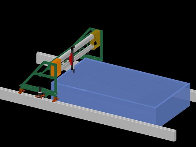

    A few years ago, I made a CNC oxygen cutter. More than three years ago I worked without problems.
    X = 12m
    Y = 2.2m
    Z = + 300mm
    * Mach3
    TB66000
    NEMA 23 495 oz
    Construction weight about 700kg
