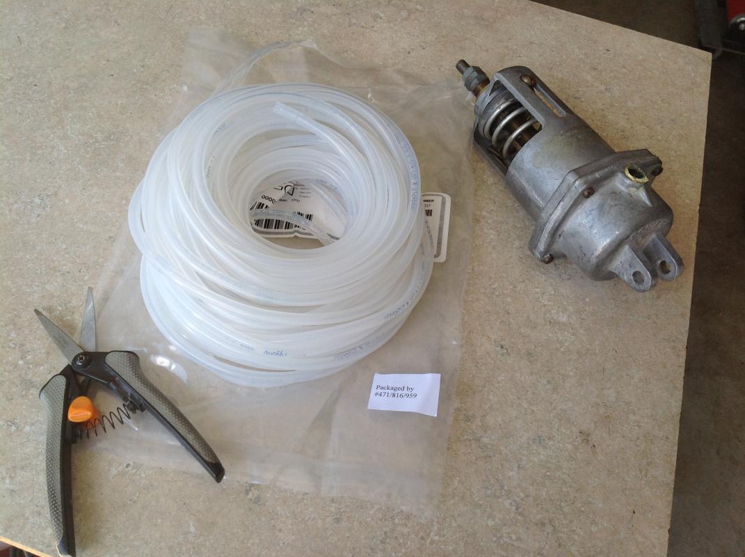

Yup, buried in all that rambling I mentioned it's 1/4"dia 1/8" wall silicon hose. And the pieces need to be 1.25" long.
So the stuff is soft but oddly sticky but not like in a goopy way, but in so soft and clean it clings to stuff. You know how silicon caulk is? So feeding through a tube is not going to work. Like all silicon it's weird to cut. Like it resists being cut fast but cutting slow is no problem if it's done right.
Attachment 10850
So here is a grouping for y'all of the hose, the little scissors I use that work so well and on of the 7 or 8 air motors I have. I didn't get a pic of the sliding glass door rollers that I think would be the bomb for guiding the hose, next time.
Thanks for the pic C-Bag. The sticky is a bit of a problem and now understand better the parameters. I have that same pair of scissor (nice) but just picked up a pair of similar Fiscars with my SO a few weeks ago for her wool work, but they are titanium...I warned her they might end up being MIA. ;) They leave no thread uncut and square as my head...Super Nice but pricey.
Have you tried pulling a single edge razor blade through the tubing for cutting? The other thing that came to mind for cutting if it is that persnickety is a pair of "Guppy" style tubing cutters. Either scissors or a pull blade could be anchored and connected to solenoids or a pneumatic of some type.
The thing with pneumatic motion is the peripheral costs on a cheap and cheerful budget. I found this 2" linear slide on Ebay for a decent price but you will need pneumatic solenoids, fitting, and such to build up your system. They might be available on Ebay or CL but haven't looked. Don't know if your "Air Motors" would work...have you tried them? Are they linear motion or rotational?

The air motors are outrageously strong. It's a 3" piston with linear motion, not rotary, with a heavy duty return spring and built in stroke stops. I'd never bumped into these until I found them and two plastic milk crates at a ReStore of all places. They had no idea what they were and it was 8x "motors", a board with three foot pedal air valves and a bunch of custom brass plumbing, quick couplers and switch valves. Said some woman came in and asked if they took donations and dropped the whole thing off. All looked unused and got the whole lot for $100. So all it would take is a simple two way valve because of the return spring to actuate. :cool:
I tried my big Olfa rotary cutter on the hose and went through it like a hot knife through butter. That cutter is astoundly sharp. For cutting anything where you want long straight super clean runs they are absolutely to way to go. So that's definitely to way to auto cut the hose. I also scored some used 1" stroke guided air Rams off eBay last year in the deal of the century. They were obviously scavenged off a box making machine as I'd seen them used for holding boxes in place for assembly. Guy was selling them for $46 for 4 of them +$10 shipping! They were US made the list for $260ea.! So I have a couple of spares for the project.
