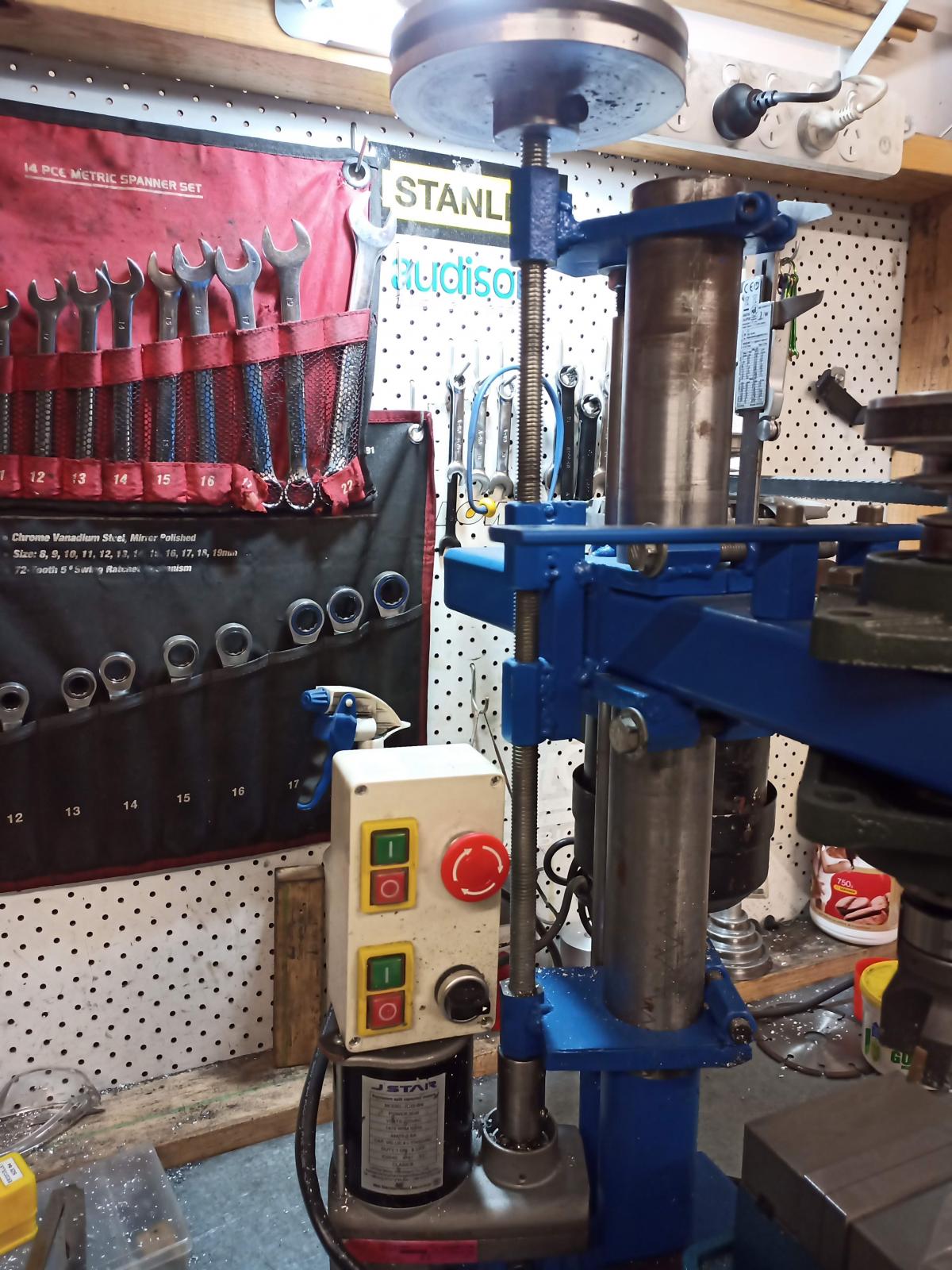

The power spindle motor is a 2400 watt electric motor salvaged from a paint sprayer pump.

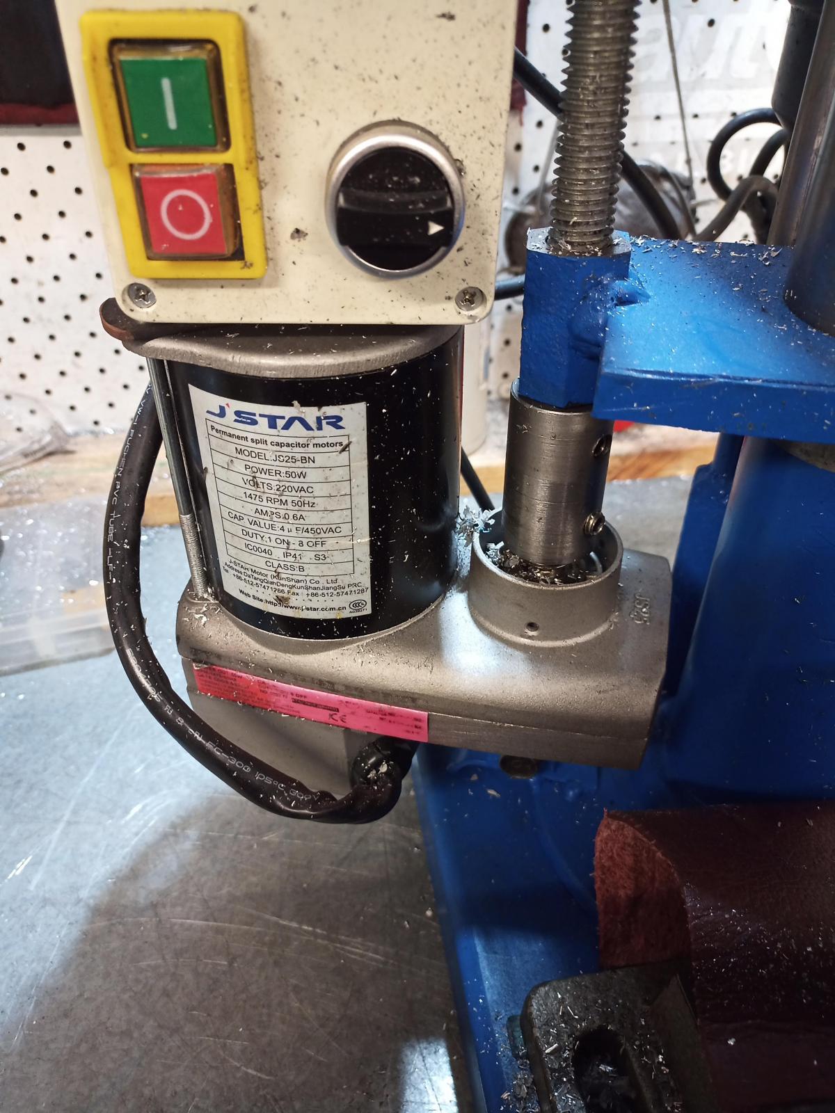

The power feed for the Z axis (up and down) is the climb motor from a treadmill - this is a strong geared motor which is used to raise and lower the spindle head.

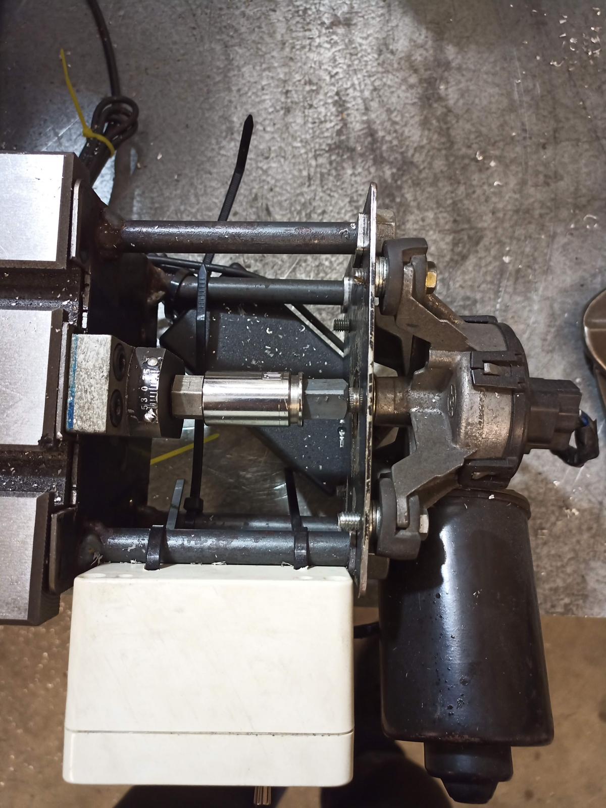

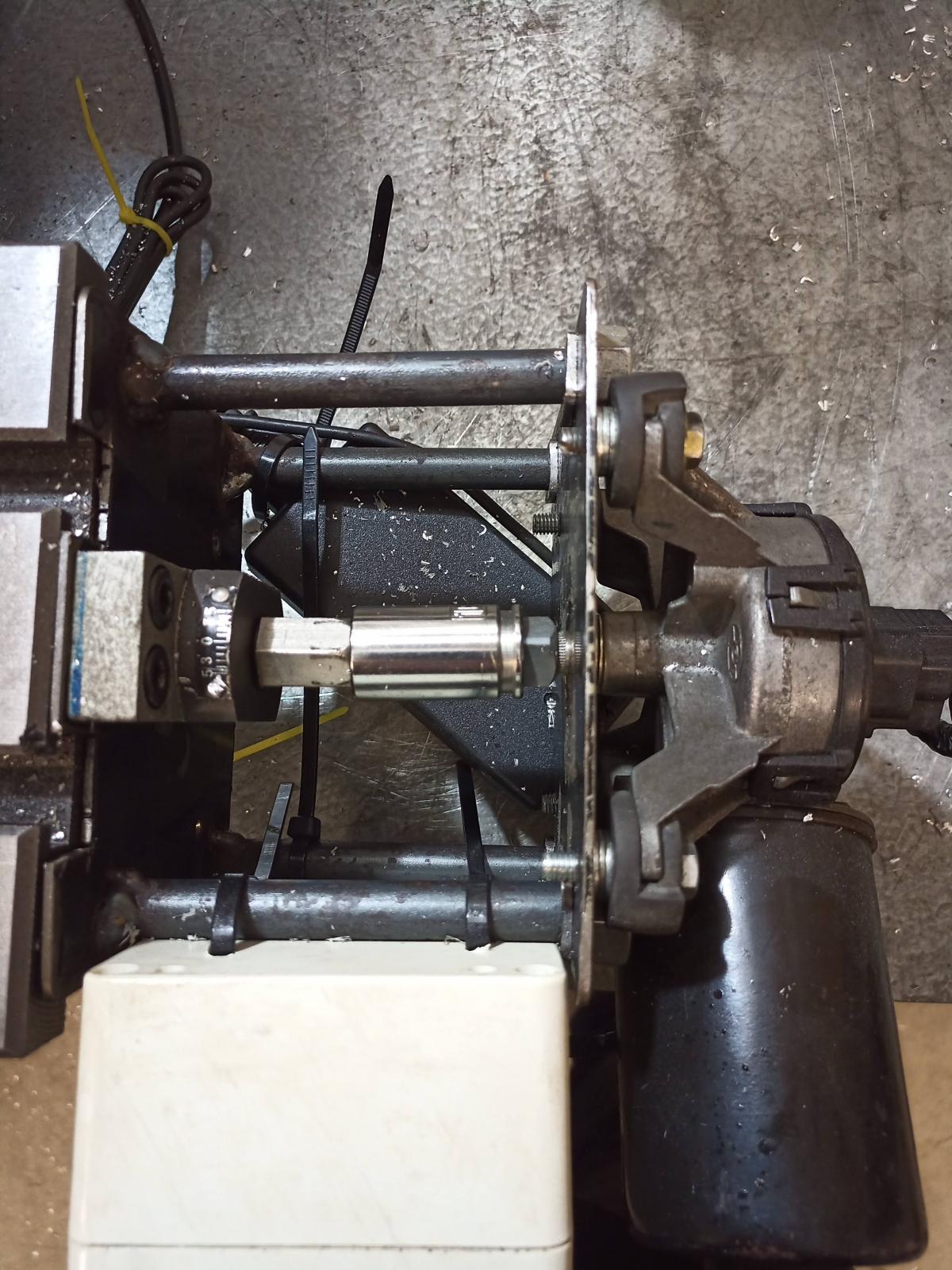

The X axis (left and right) power feed motor is a 12v window wiper motor from an old car - the speed control is a 12v 20amp PWM circuit. The power feed is manually engaged by using a 19mm 12point socket that can slide back and forth connecting the powerfeed drive to the table using a hex head on once side and square on the other, once engaged the table will move back and forth at the desired speed. Please see photos attached

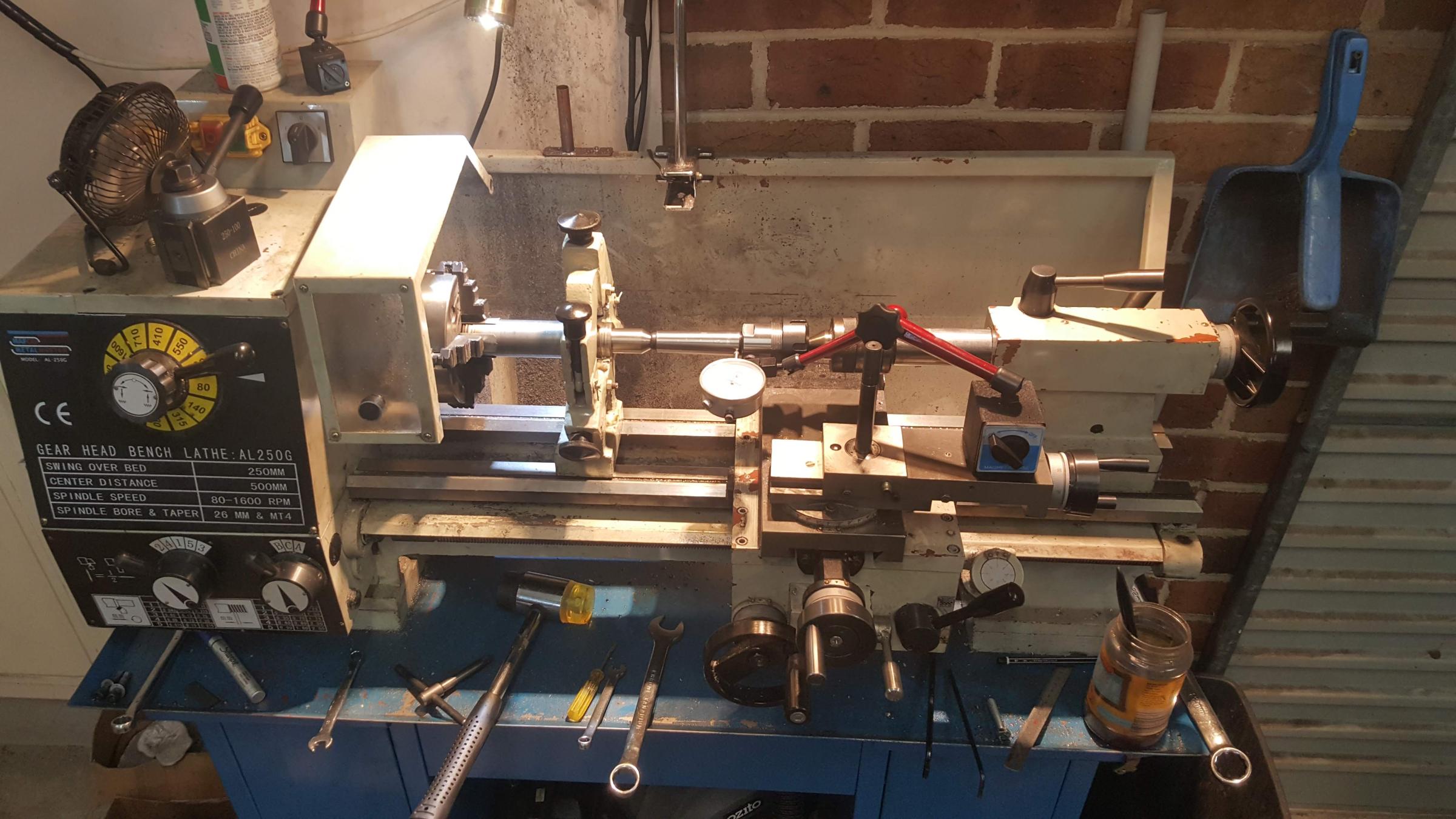

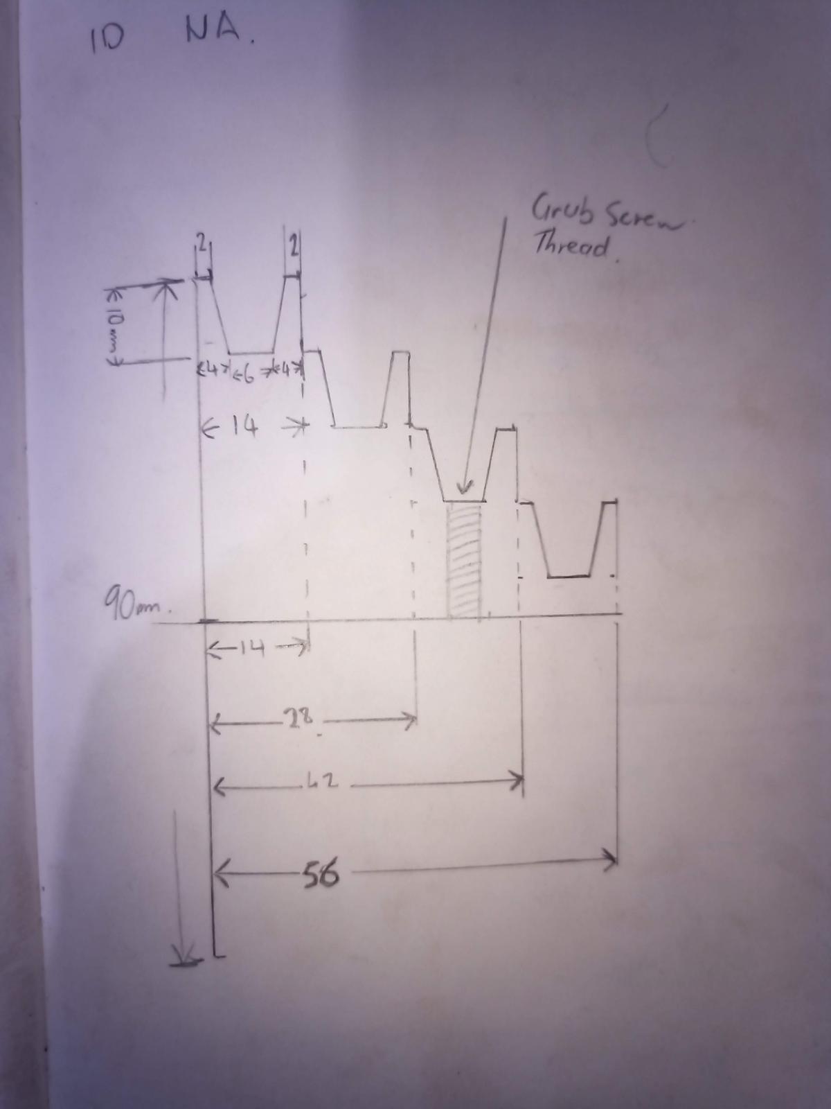

The pulleys were all hand using the lathe made as they are quite expensive, the switches, plastic boxes, bearings and machinist vice were all purchased from eBay in an attempt to keep the cost down.

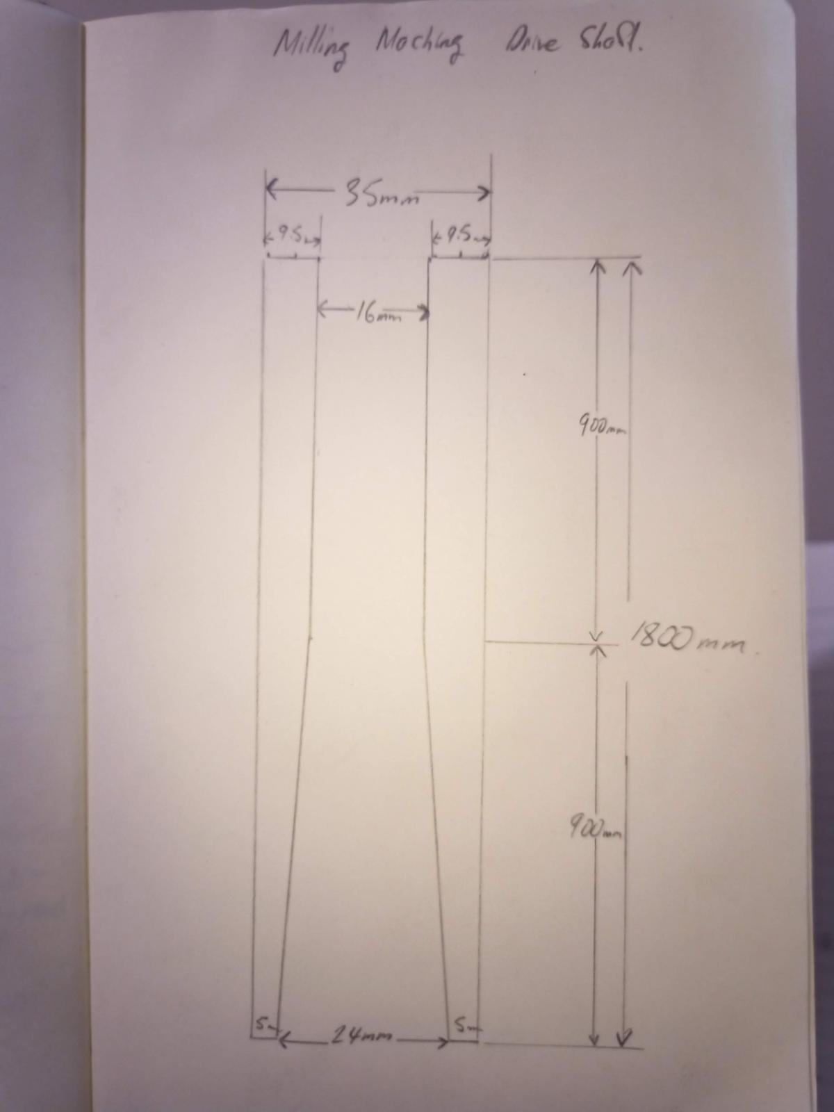

The main support column was made from an old bench grinder stand - I placed it on the lathe to square it up and it worked perfectly. There are various other parts that were made on the lathe such as the main shaft, this is a 35mm steel shaft that uses an internal M3 taper to house the cutting tool which is held in place by a head bolt connected at the top of the spindle shaft.
This is tried and tested method on professional machines to prevent the cutting tool from leaving the machine due to vibration.
Spindle: The spindle was hand made on my lathe out of Bright Steel from memory it was 40/40 cold rolled steel.
Taper: The taper is an Morse3 taper, I decided to use this shape as tooling is quite cheap and will also fit my lathe tail-stock.

The home made spindle has a run-out of 0.004mm which isn't too bad for a DIY job.
