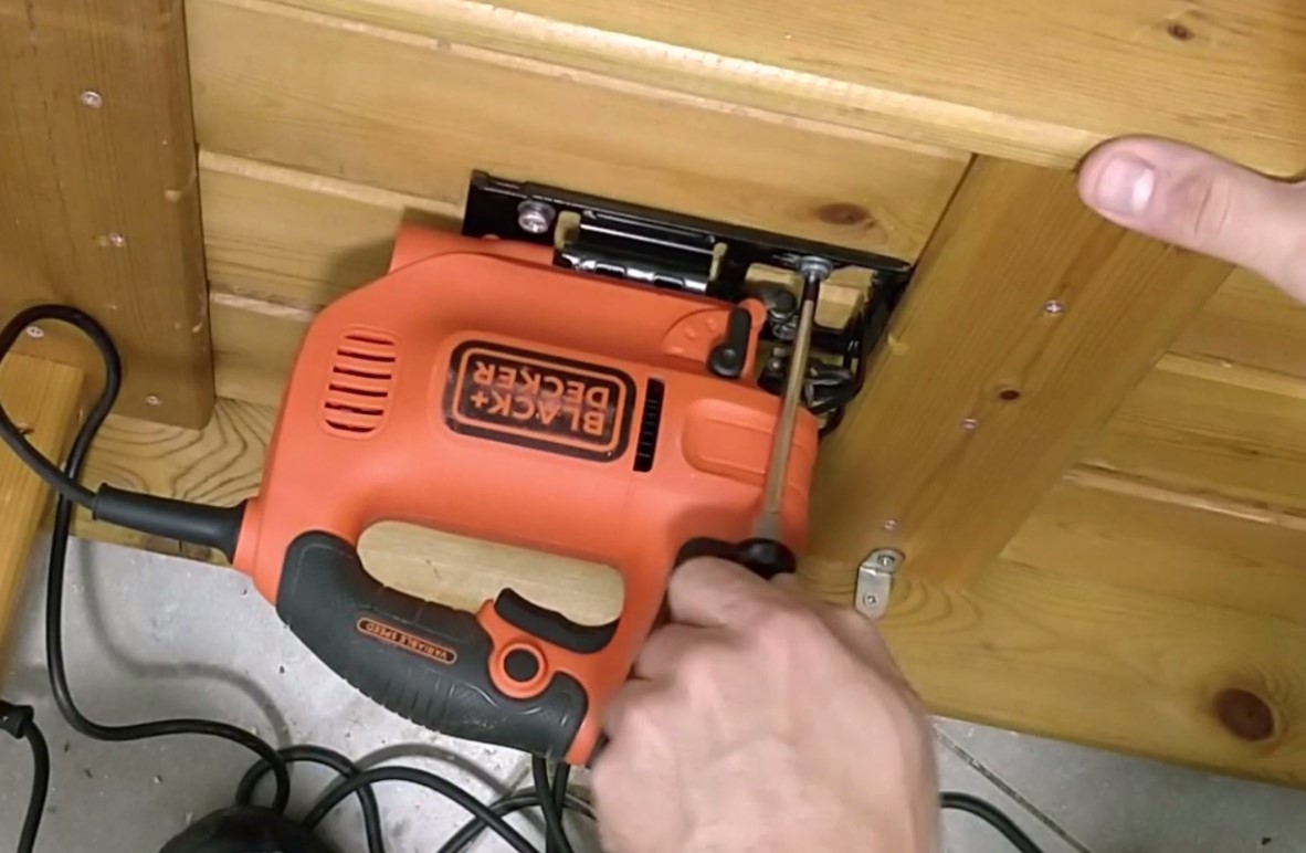

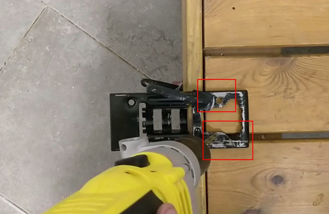

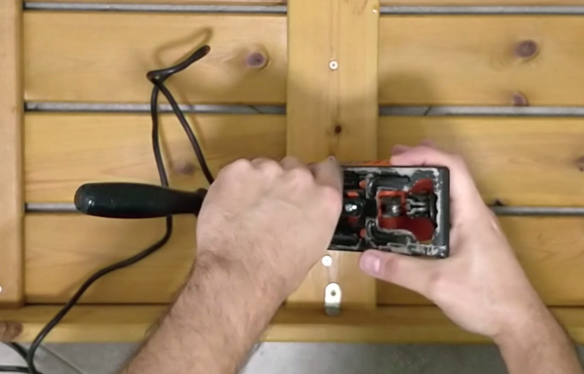

I started with removal of the Jigsaw bottom base.
I disassembled the screws holding it and positioned it on the bottom of the table to check the location for its conneciton.
Attachment 28852
The base already had 2 holes.
After marking the position with a hammer, I drilled 2 additional 8mm holes using a metal drill.

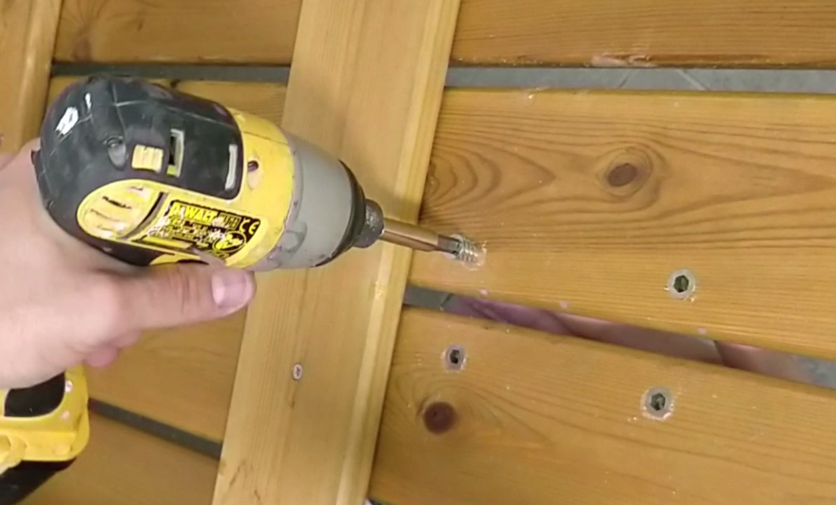

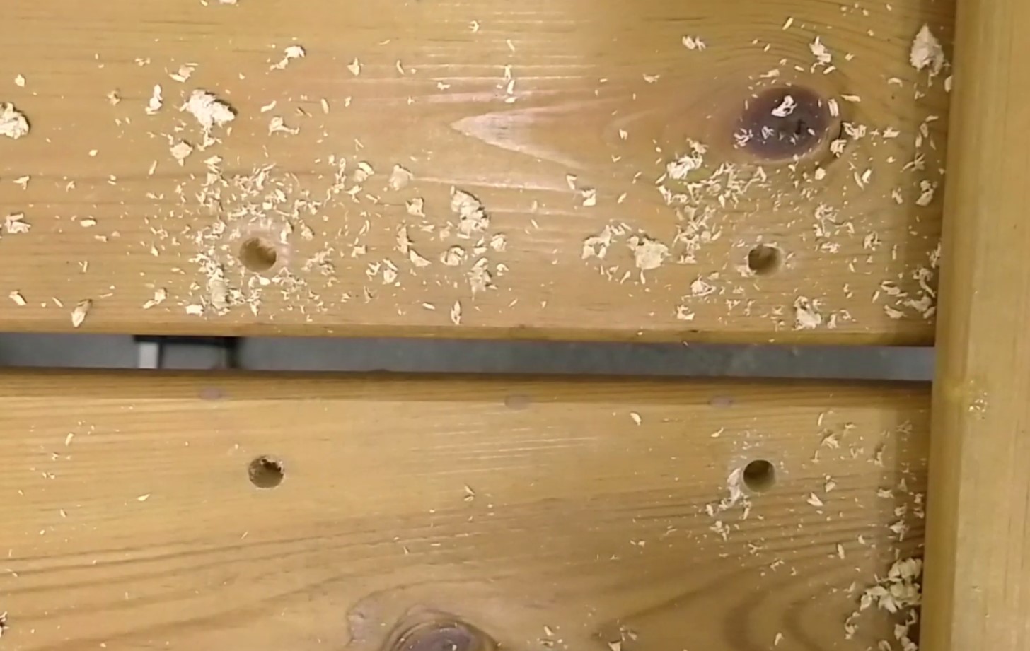

Attachment 28853

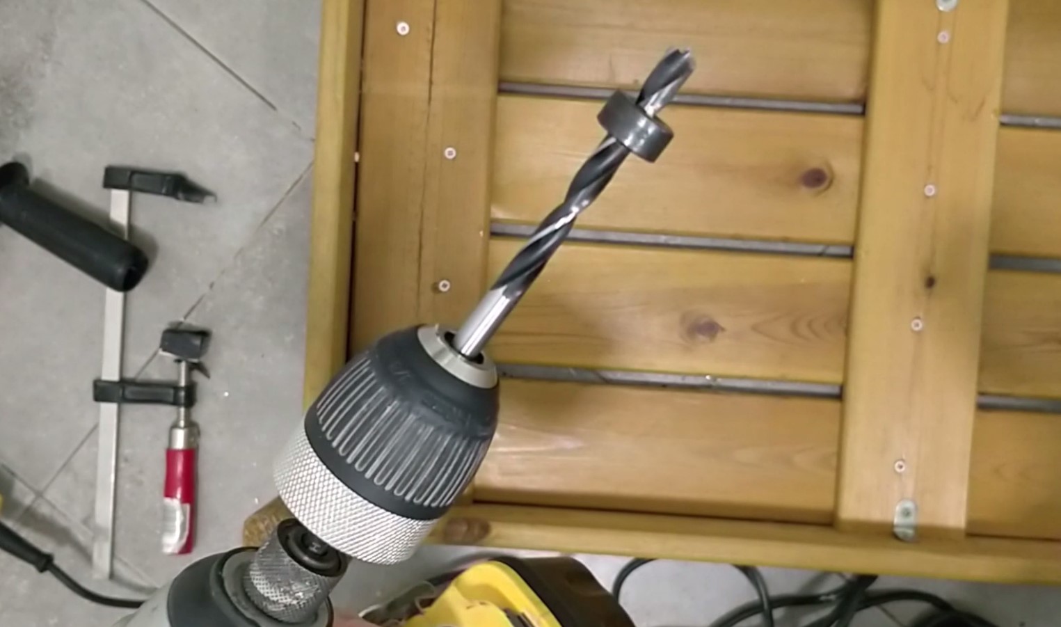

I marked the positions of the 4 base's holes, on the table bottom and drilled with 7mm wood drill and a stopper for 14mm depth (in order avoid getting to the other side, in the 18mm wood).
Attachment 28854
Attachment 28855

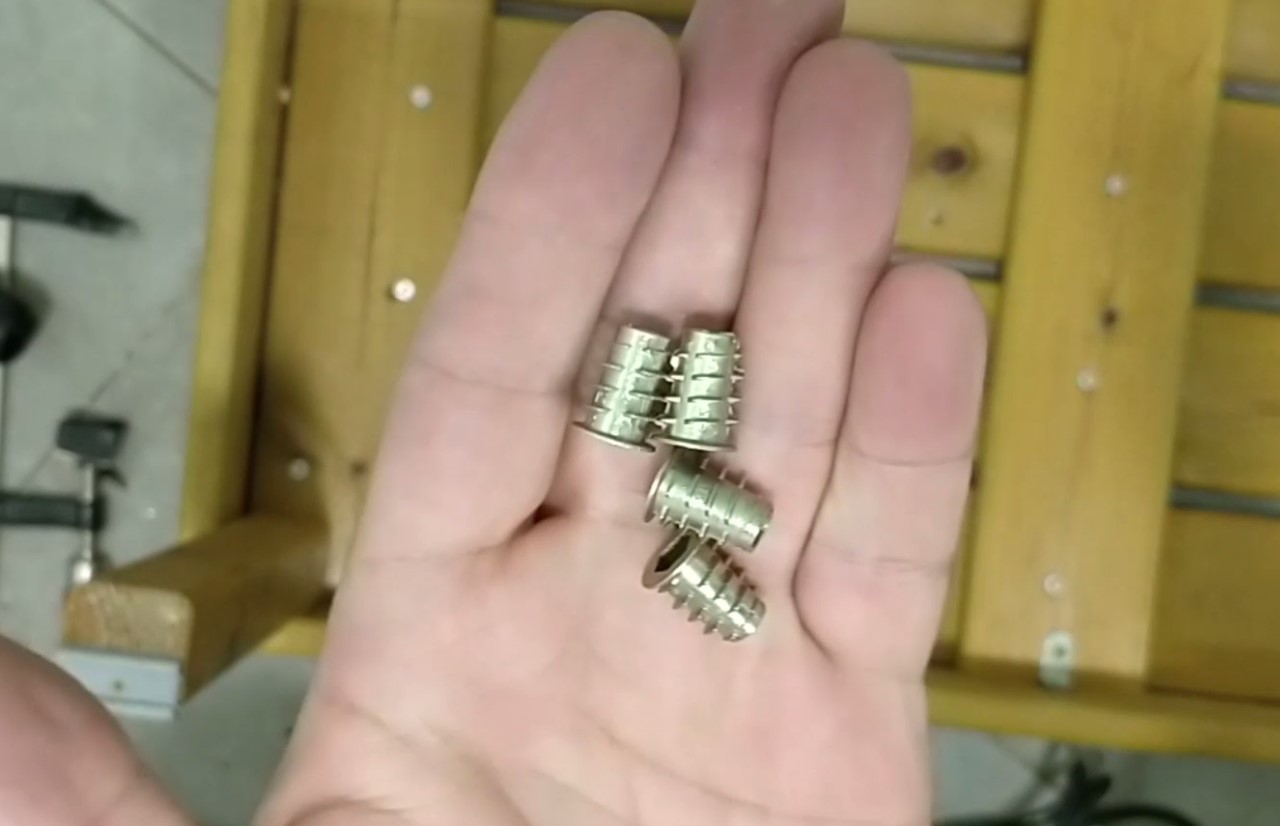

I took 4 threaded inserts / insert nuts and matching screws and metal rings.
These inserts, allow easy removal and re-connection of the screws and the Jigsaw to the table.
If I would use regular wood screws directly to the wood board, it won't hold too much reconnections...
Attachment 28856

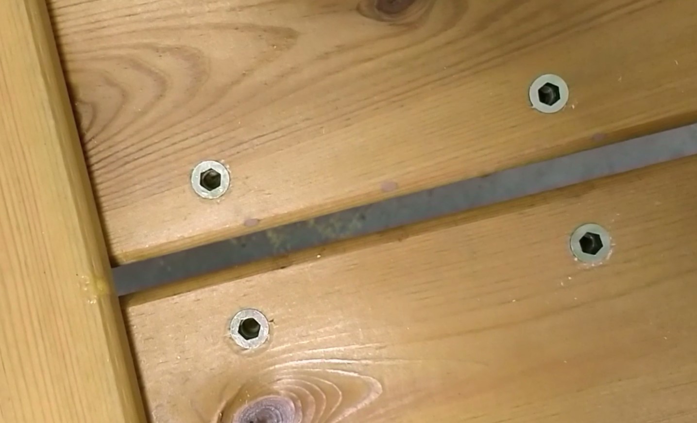

I connected the inserts into the previous step drilled holes. I did it carefully so the insert won't be passed to the other side of the table top.
Attachment 28857
Attachment 28858

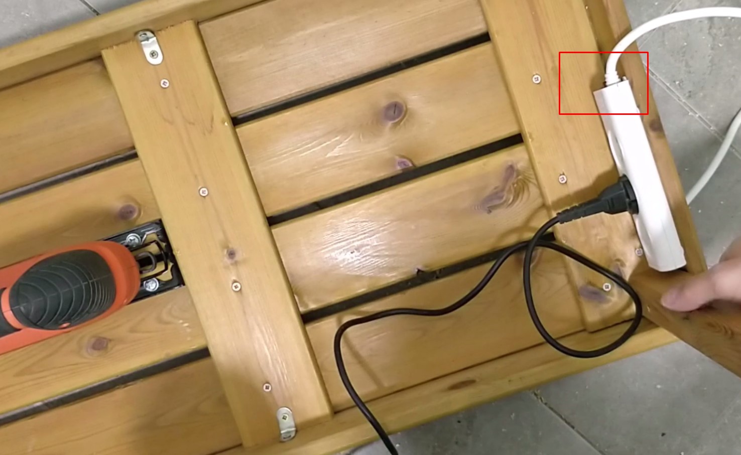

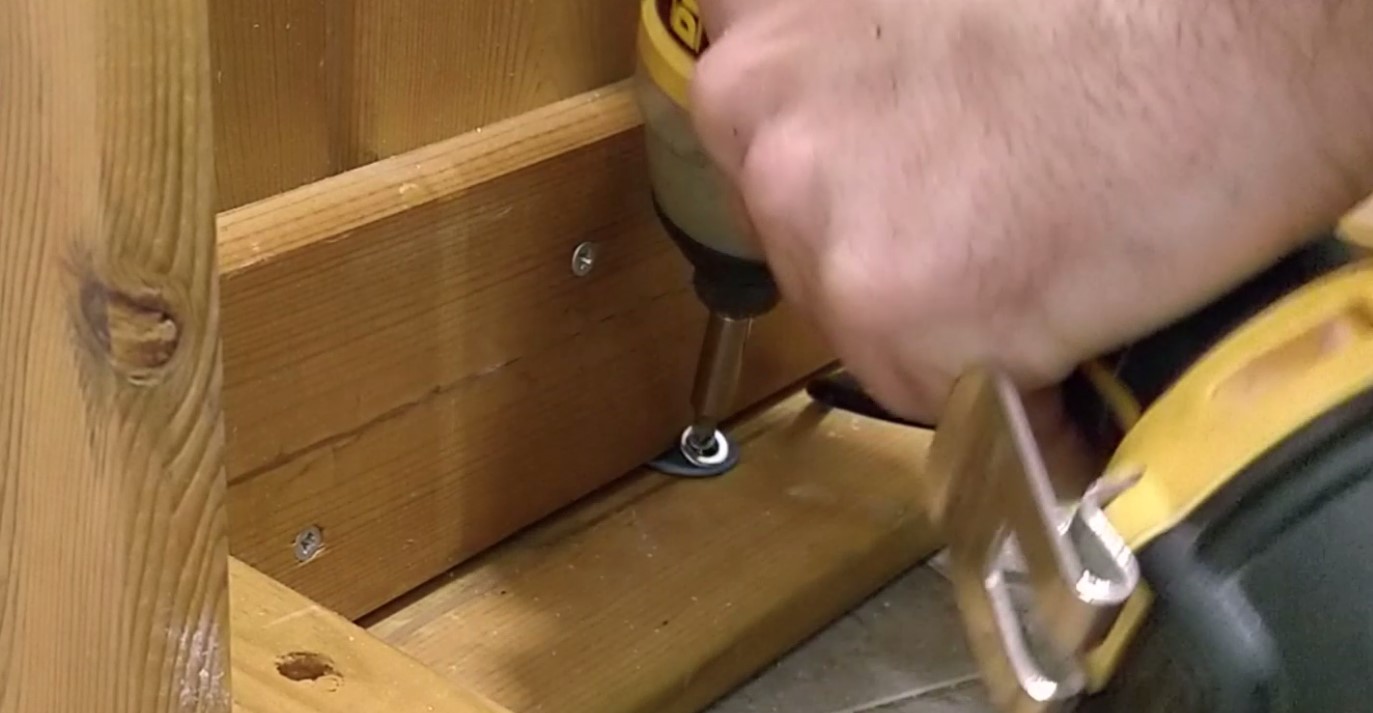

I connected the metal base back to the Jigsaw.
Later, I connected the Jigsaw to the table using the screws and metal rings to the inserts.
Attachment 28859
I pressed the Jigsaw switch and locked it using the lock button, so it would work without pressing it.
Finally I connected its power cord to an extension cord with a switch.
Attachment 28860

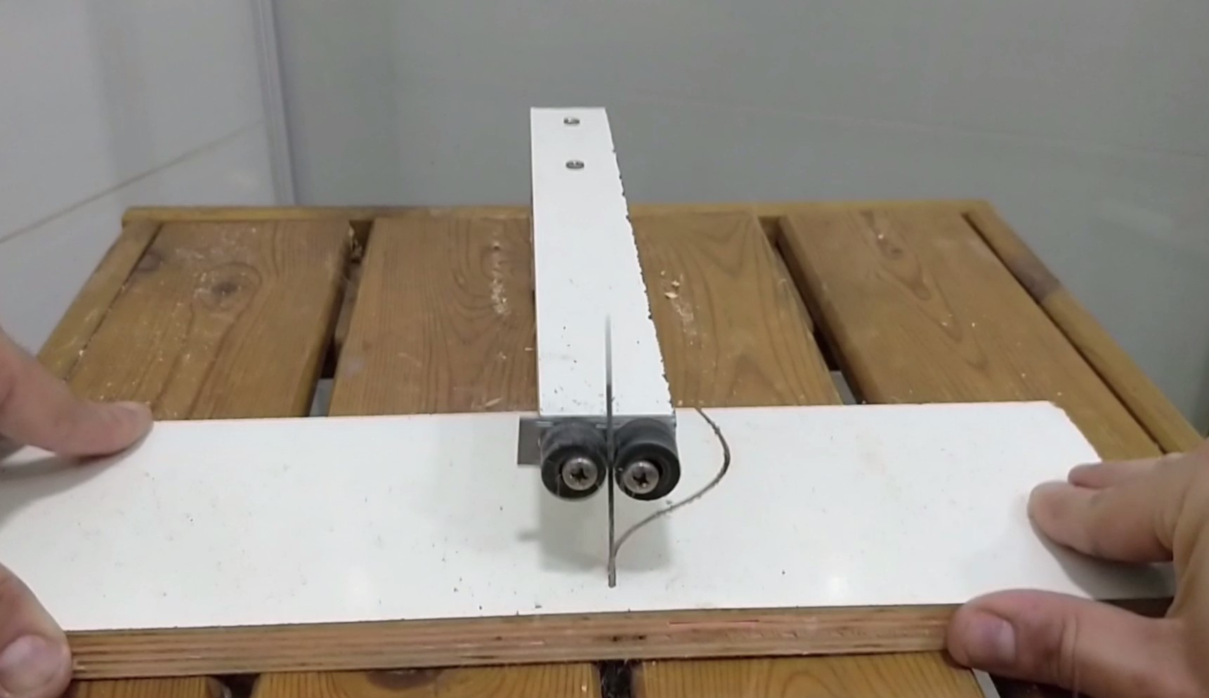

At first, I tried to cut without a special guide for the blade.
Attachment 28861

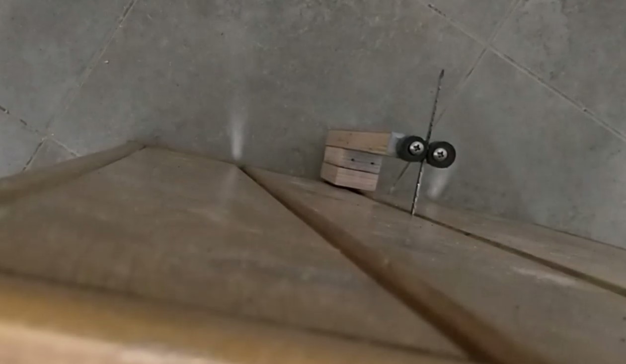

As you can see in the video, It cut well but the only issue is that the blade moves from side to side and I decided to add additional guide for the blade, in order to stabilize it.
In addtion, it was hard to see the blade without any mark on the table (although I could see it well from the side while cutting).
I took the cylindrical plastic parts I had (I assume it's made of Aokolon), and connected them side by side, leaving a space for the blade.
Usually, people are using bearings for such projects but I couldn't find ones.
I decided to use the plastic parts although they can be worn out after some time, but I don't plan to use it intensively and I can replace it later for any other parts.

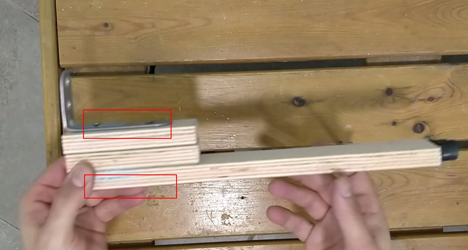

I cut some wood pieces for making the guide holder.
I connected the wood pieces together as you can see in the image. I made it high enough for the wood I need to cut.
finally, I connected a metal angle at the bottom, in order to connect it to the table.
Attachment 28862
I connected it with screw below the table.
Attachment 28863
Attachment 28864

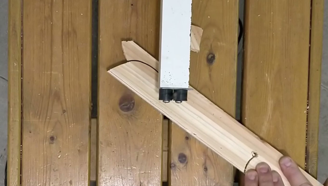

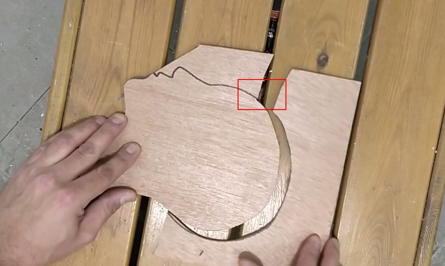

On the second try with the blade guide, the blade was much more stable, as you can see in the video.
Attachment 28865
Attachment 28866
