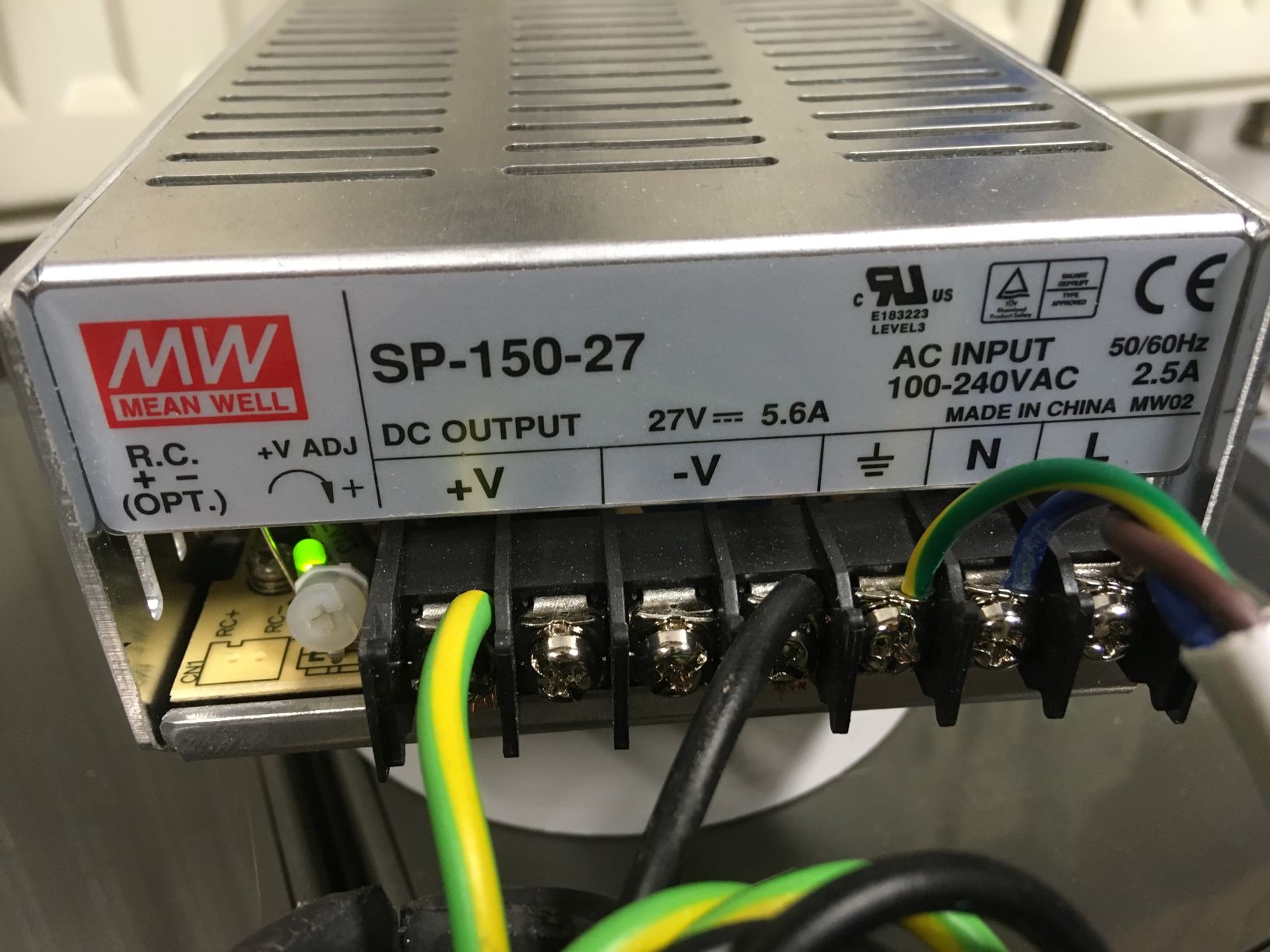

Raiding my stash of squirreled-away stuff I started out at the PSU end with a "liberated" SLA charger @ 30VDC and 5.6A tops:
Attachment 37656
it has since been improved with a smallish, silent cooling fan and its 12 V regulator and been bolted out of the way, to my bench side,

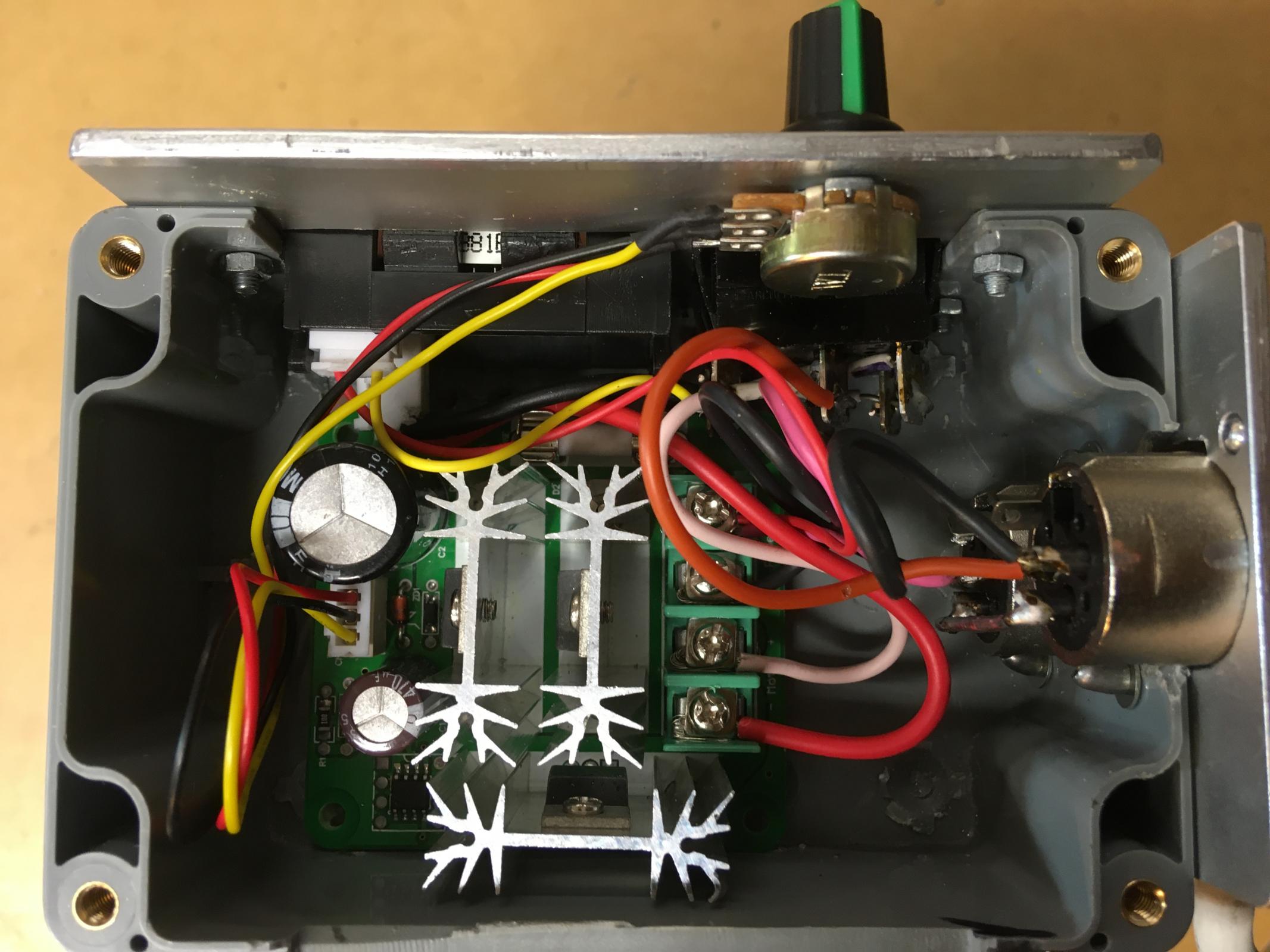

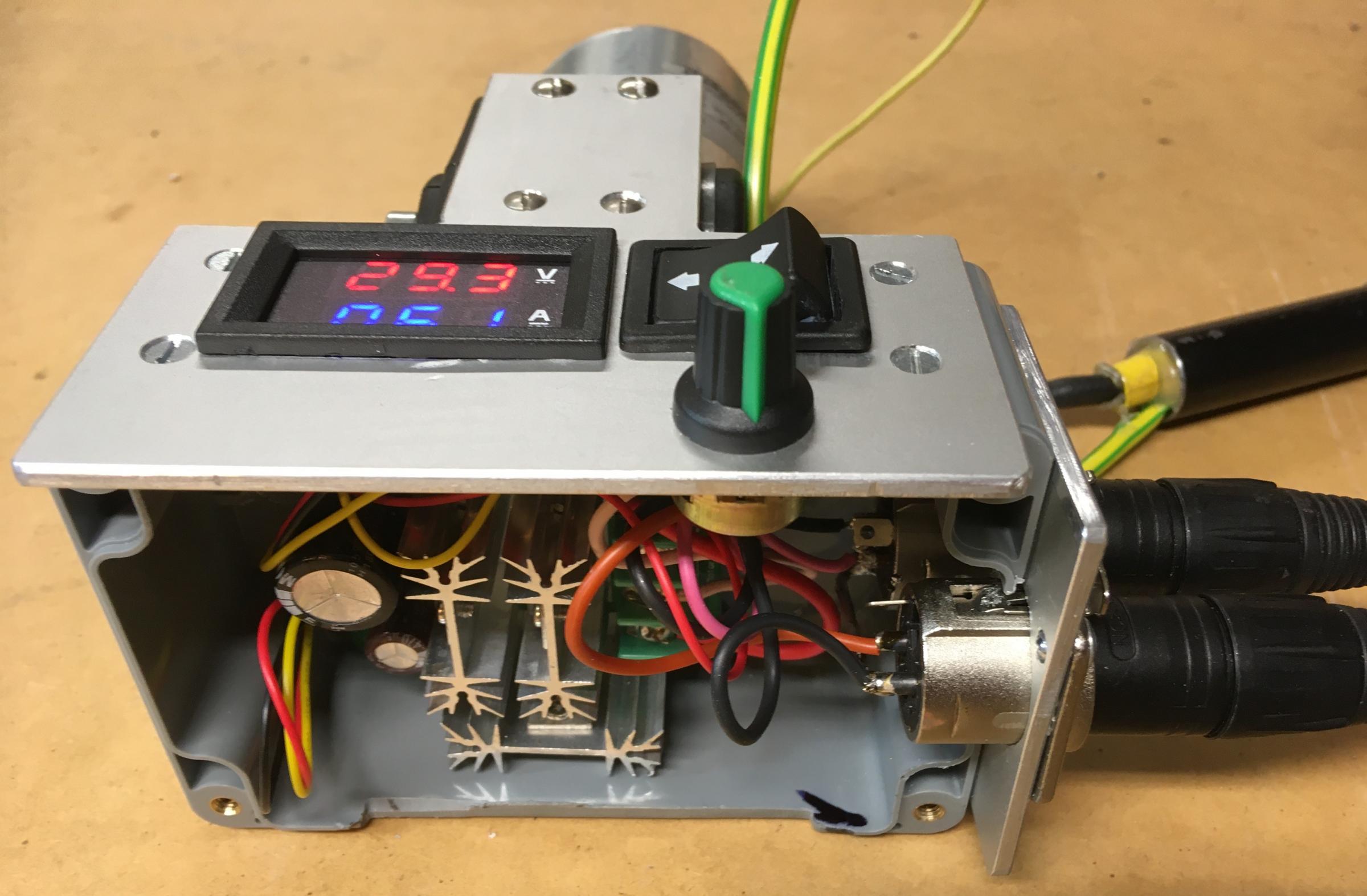

Having some salvaged electronic boxes, Al plates from scrapped computers, some recycled connectors, switches and fasteners,

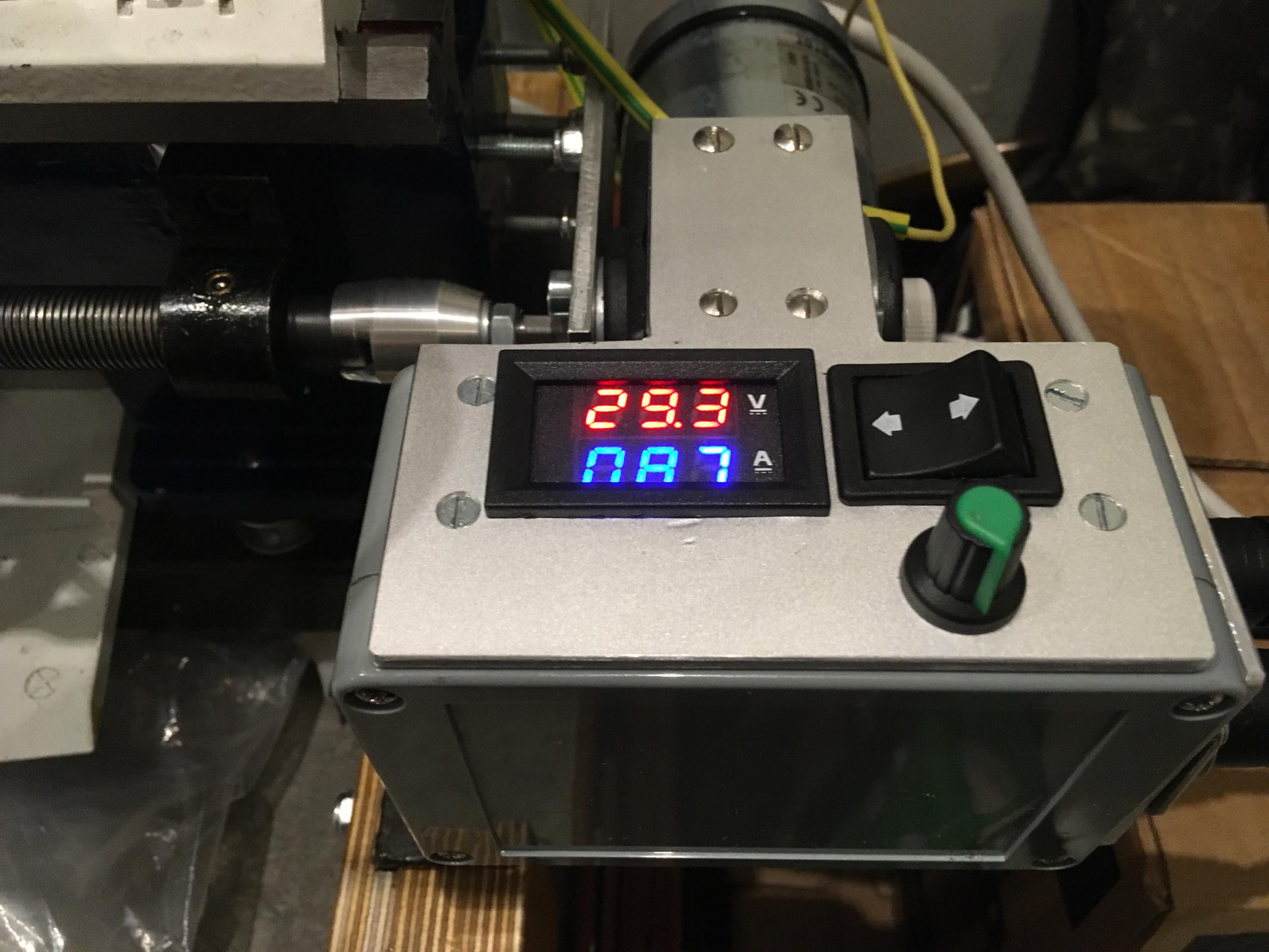

I started out by ordering a 7 buck PWM regulator and a V/A-meter for another five dollars:
Attachment 37657 Attachment 37658
Box slotted at bottom and drilled up top rear for some ventilation, full plate cover on top and RH side,
where a couple of XLR chassis connectors sits, where PSU output/ motor connector is seen next to the motor snubber/ EMI filter.
Easily hooked for driving the TPMDGM, or hooking up another, separate MCU when TP milling with power feed.
All driven low voltage peripherals are, and will be having XLR connectors.

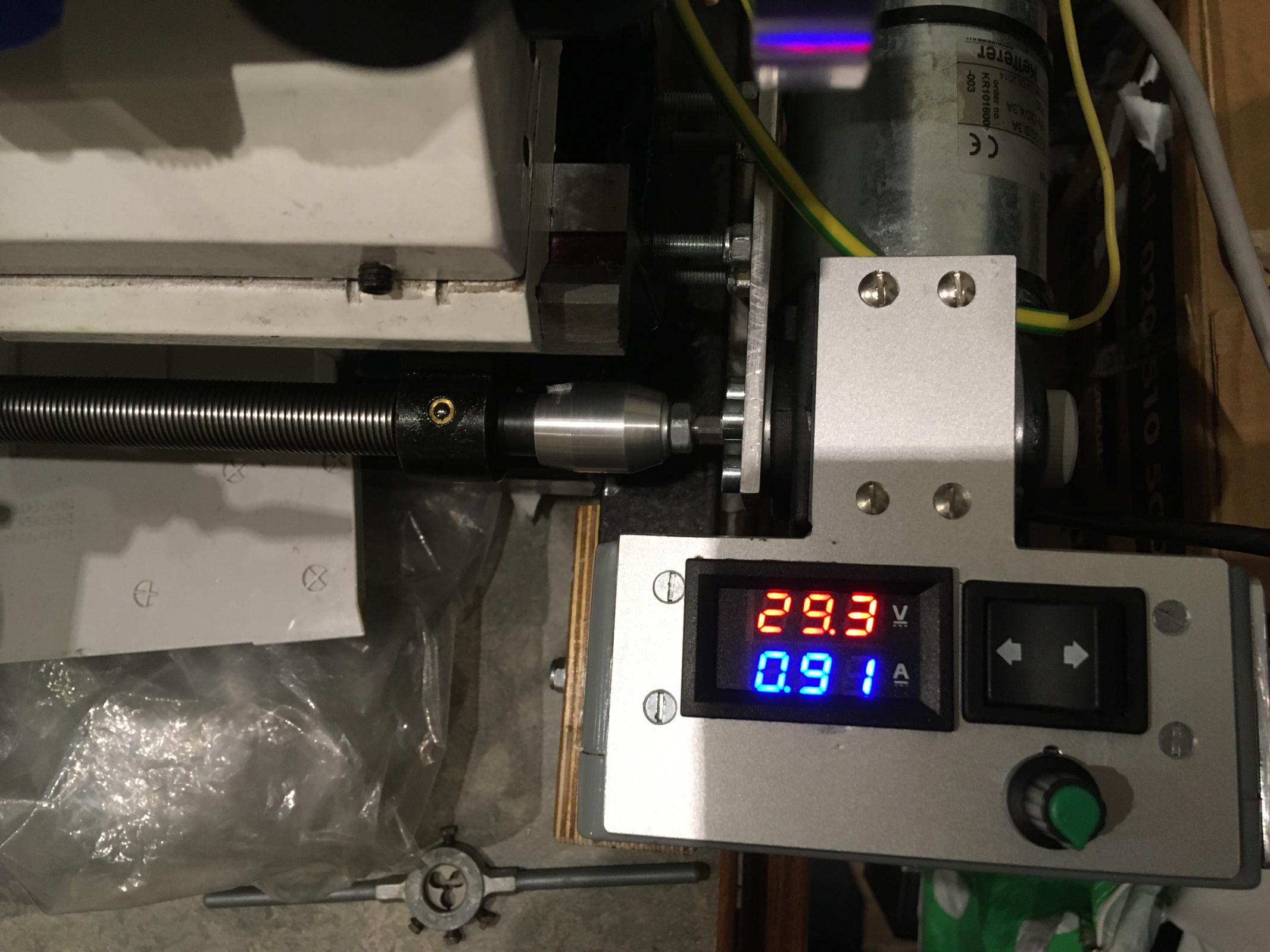

The whole shebang bolted to the motor gearbox, easy to see and reach but still out of the way.
Here at nominal drive power with closed half-nuts:
Attachment 37659 Attachment 37660
Not that much to it, really - but perhaps some food for thought?
