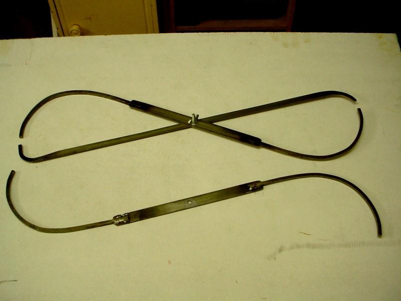

Hi,
Here is my big size thickness caliper, for measuring the thickness of the walls of a woodturned vessel for example.
http://www.labellenote.fr/file/Woodw...nde_taille.JPG
With this kind of caliper, you need to hold the tool in place on one side, while measuring or simply appreciating the thickness displayed on the other side.
I have made an optional branch more flat, to be used for narrow vessel necks, whereas the two rounded branches will be more suitable for measuring the bottom of a bowl for instance.
The cross is made of flat steel, the bended parts are made of square steel.
Overal length is about 50 cm.
