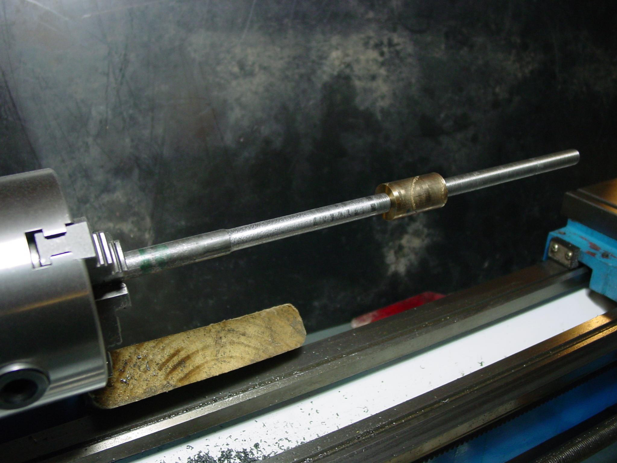

I am in the process of making a down feed screw and hardware for Edelstaal Machinex5 Mill lathe combo.
I made the screw from 1/2" cold rolled steel. In the photo It is only half completed. I still have to turn down the diameter for the 7/16"x20 tpi left hand die up to the green mark on the left and then complete the rest of the threading. Also the partially completed nut for the feed screw is threaded on the rod. :
Attachment 8650

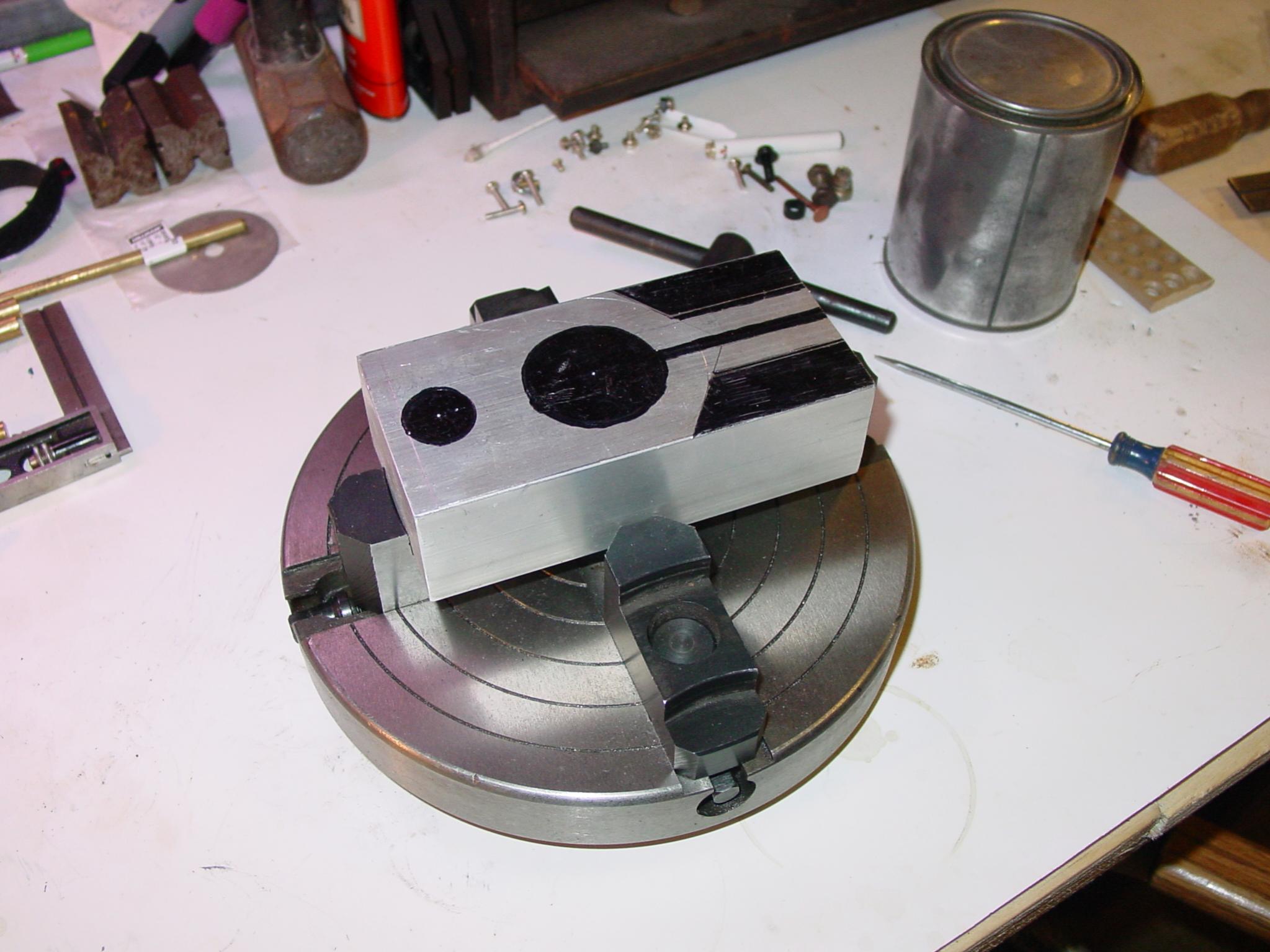

The next photo shows the blank marked out and kind of set up in the 4 jaw chuck. The bigger hole is 1.5" an will be bored. The smaller 3/4" hole I think will be drilled as I don't think it can be centered on the chuck and bored without shortening the other end of the blank. I haven't decided yet which way I'm going to go yet. Then cut the slot for the clamping section and trim and file off excess stock:
Attachment 8651

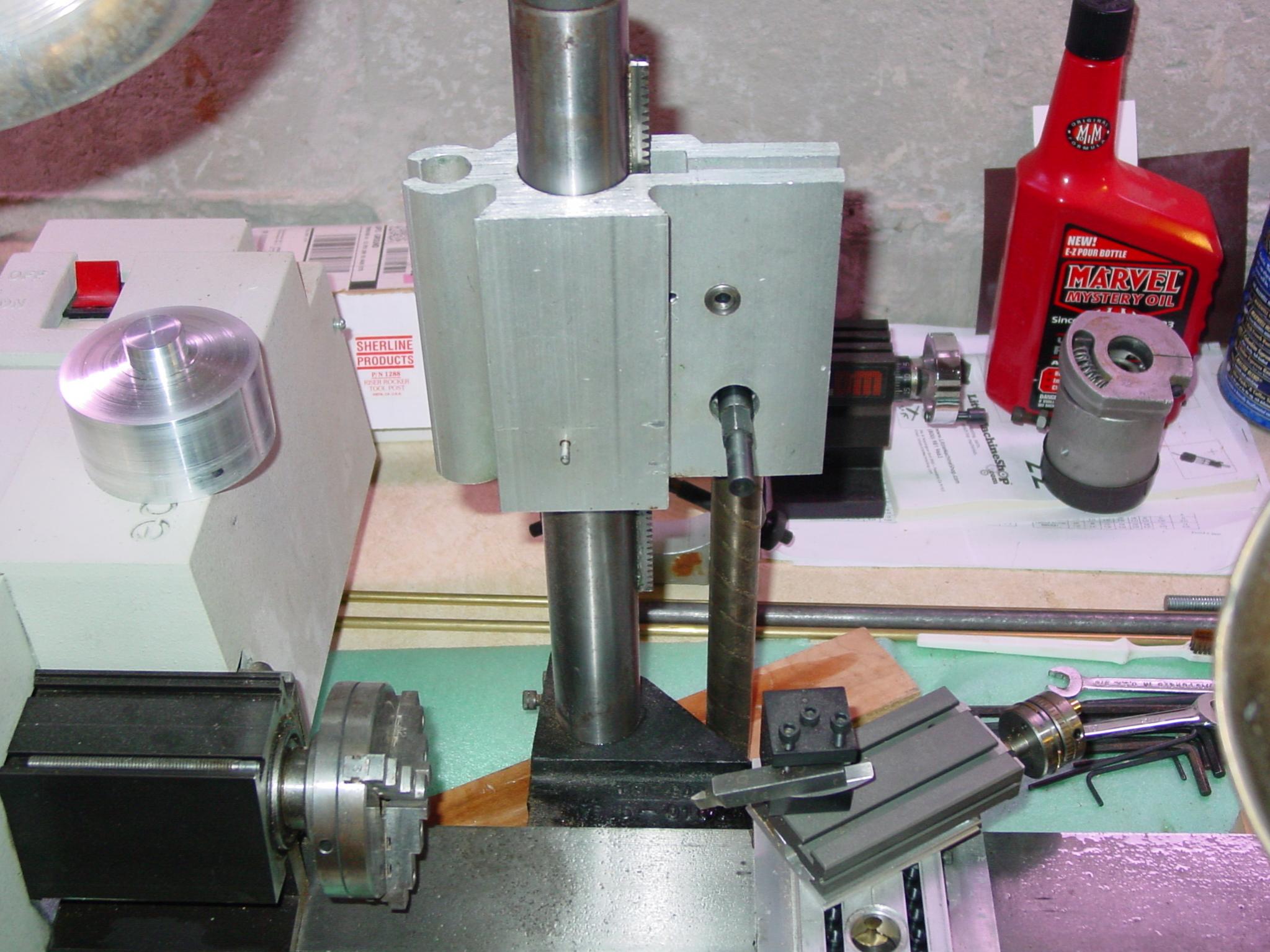

The third photo is a shot of the Edelstaal with the mill column and the milling attachment minus the spindle\drive. the attachment is being held up by a hunk of the bronze stock used to make the feed nut.
all of the hardware I'm fabricating goes through the hole at the left of the attachment with the hunk of aluminum at the top which will clamp to the top of the column:
