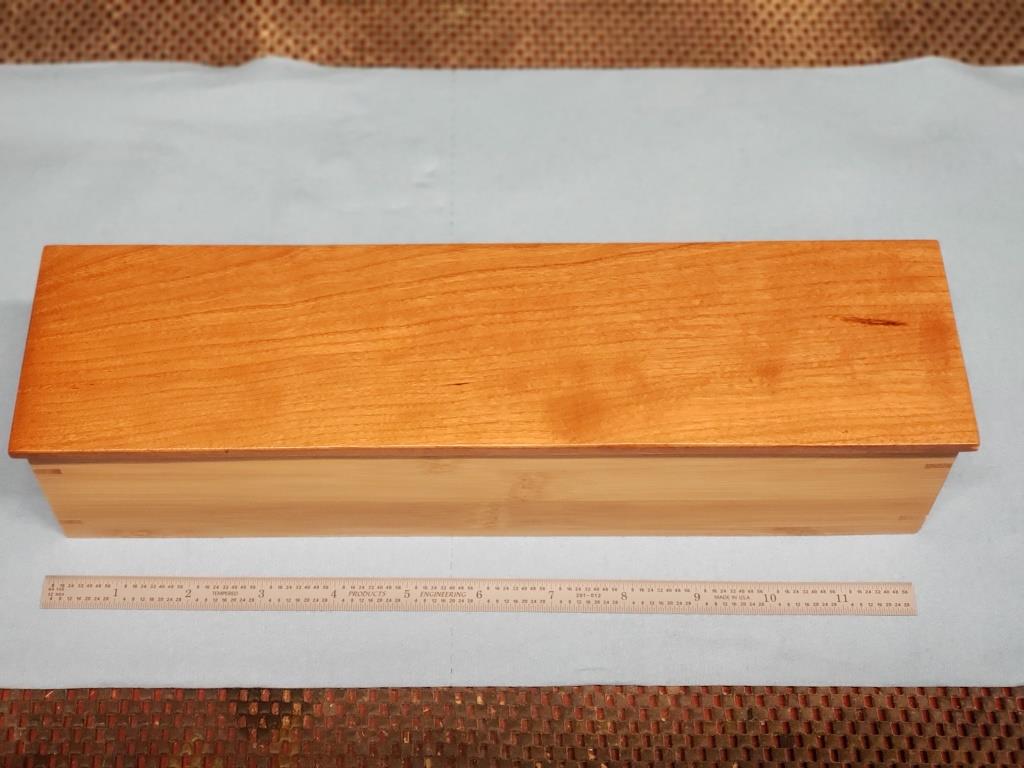

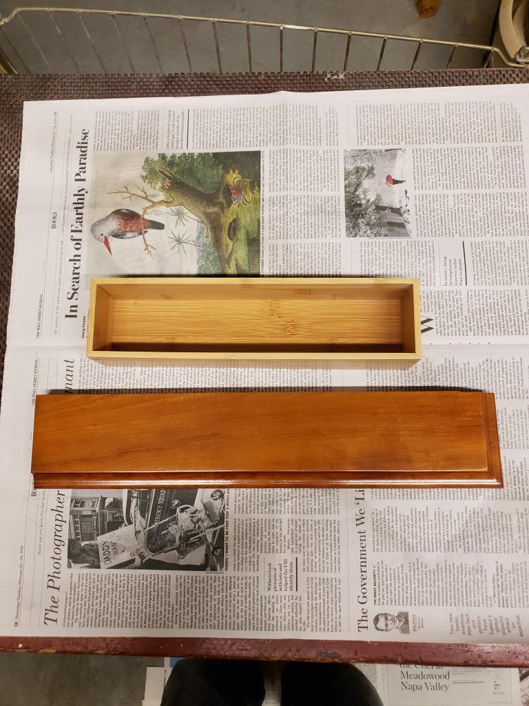

    During the last 20+ years I have accumulated several bins of custom wood molding scrape parts thinking these small wood parts might be useful for something else. Rarely did this ever happen. I started burning the wood parts in our fireplaces and last week saw this beautiful piece of cherry wood cabinet part cut-out to accommodate a Viking gas cook top on a kitchen center island. I don’t know what happened to the other half of the front molding set but thought what a shame to burn this piece of wood. I had to use it for something in the shop.
    Finished Dremel storage box shown below.

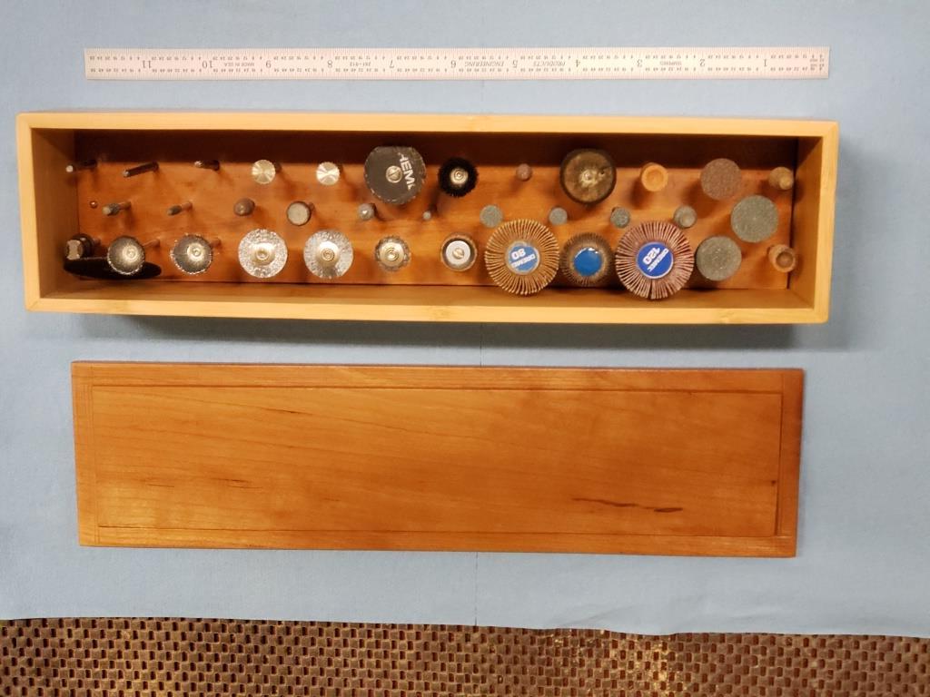

    I used the cherry wood scrape to create a Dremel tool cutting/grinding stand and box top. The 12”by 3” box from a local box store is made of bamboo and far less expensive than anything I could make. I have many of these inexpensive bamboo boxes for storage in the shop. Previously I had kept my Dremel cutting tools in a cardboard box and never knew exactly what cutting/grinding tools I owned. Over the years I have made several wooden tool boxes and many wooden tool stands/racks and now get to see these every day in the shop. Here is another one of these. I find these wood creations are one of the small pleasures for me working in the shop.
    I wanted to make a custom storage box for the Dremel tools. First step was to rip two 0.25” thick pieces from the scrape cherry wood for making the box top and the inserted rack stand.

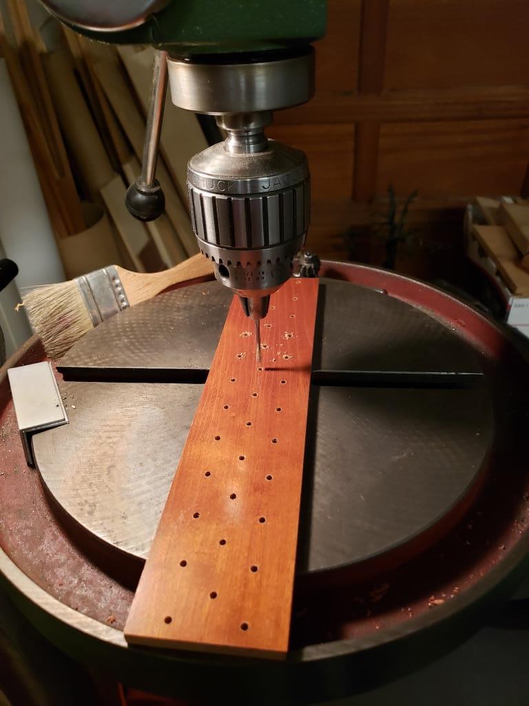

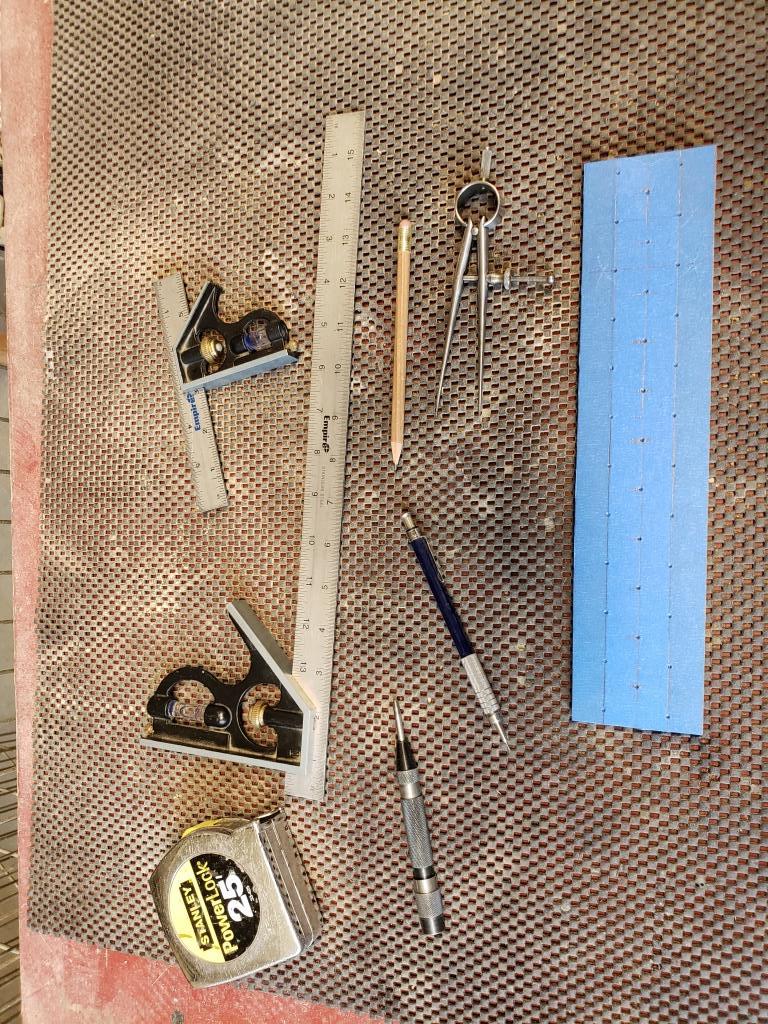

    Using blue tape, I laid out the holes for the rack, drilled, and then reamed to 0.126” (oversized) to fit the slightly smaller Dremel diameters and make it easier to insert and remove the shafts.

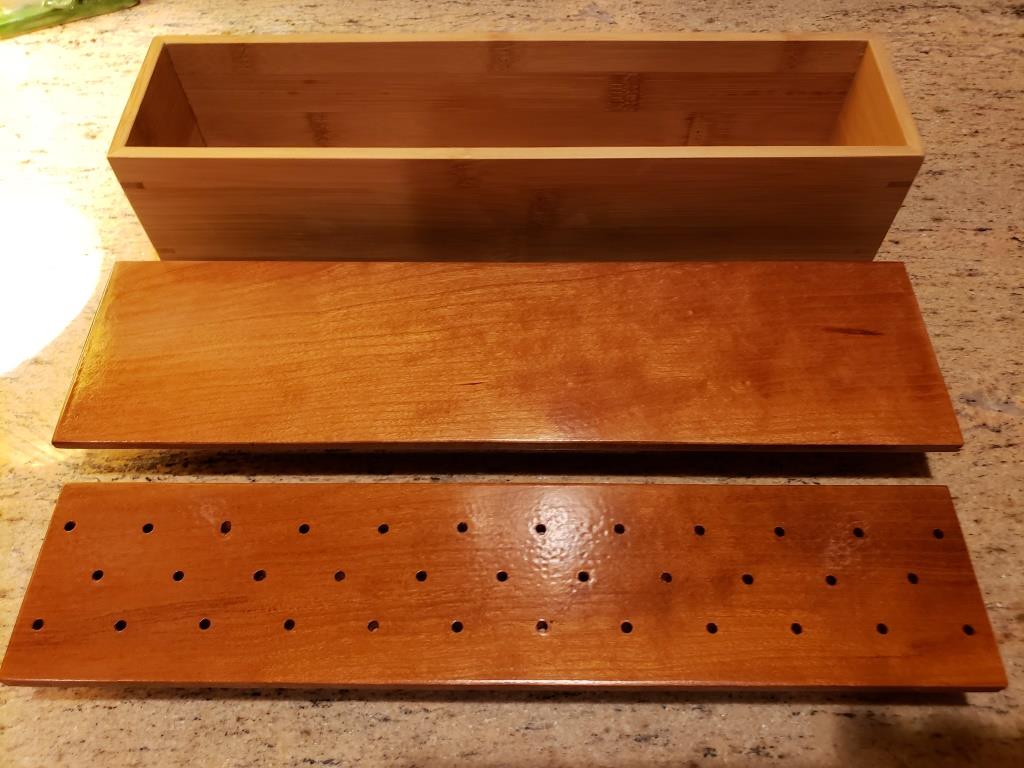

    Finally, I used a couple coats of Delf Semi-Gloss lacquer spray to finish the wood (and not shown using a final sanding with ether 220 or 320 grit sandpaper produces an ultra-smooth wood finish by removing the "bumps" from the spray finish).
