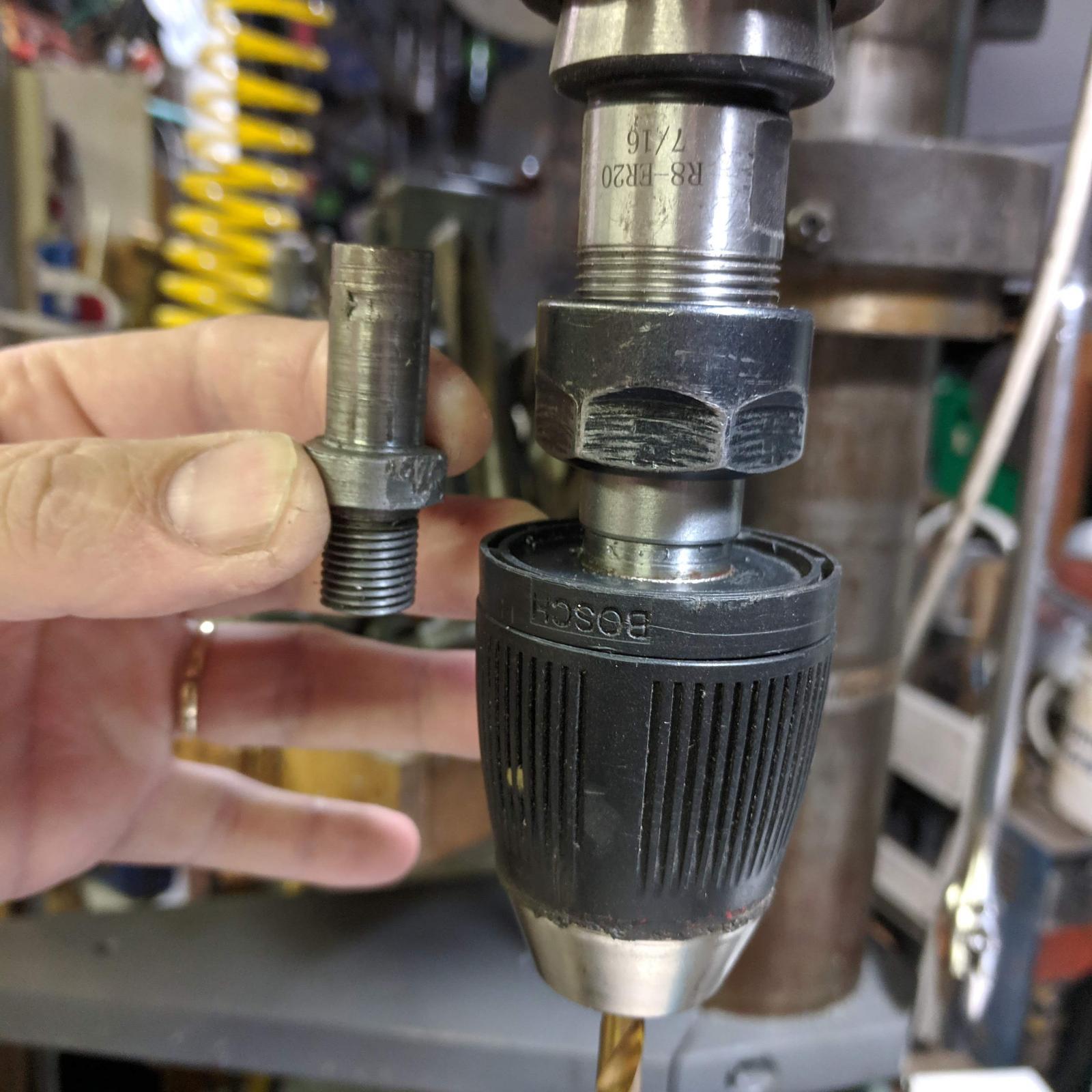

    Threaded drill chuck arbor, allows using a discarded cordless drill's chuck in a drill press or mill
