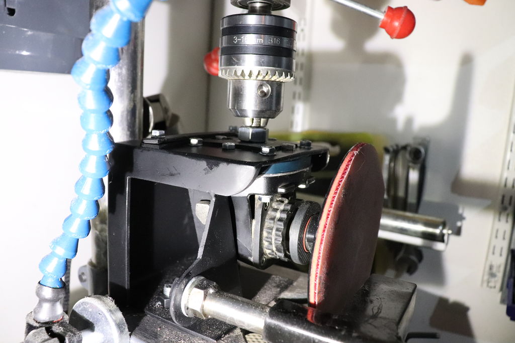

Here is couple pictures.
If you watched the video.. you might wonder why there was that plate stripe bolted to the casing?
Its for holding the rubber flap that keeps dust away from the bearing.
Attachment 25423

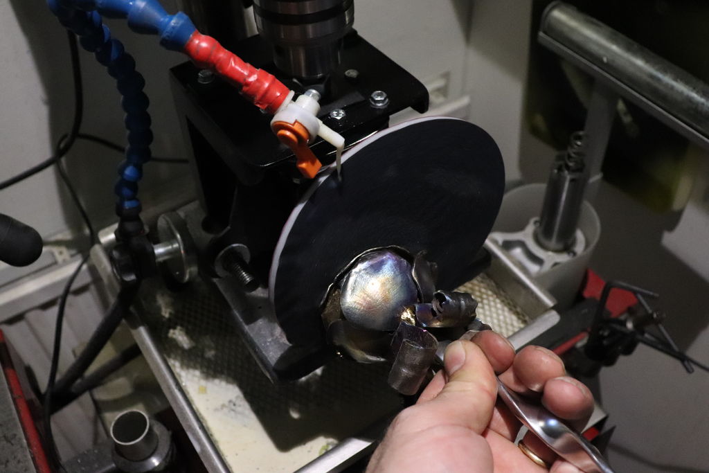

And here is where i use it mostly..
Attachment 25424
I can use my cutting fluid system for wet sanding too.
I had no suitable machine for this purpose before. Now i do.
Too high rpm ruins sanding pads and throws water everywhere..
Low rpm needs bigger torque, this gives it.
I can use this with rpm 50-600 with my drill press ( drill press spins 250-2700rpm). Its suitable for accurate and precise working. Imo.
