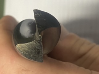

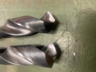

When drilling brass there are several things to be aware of when using a standard 118 degree twist drill. Cutting speed 90-210 m/min, Coolant, drilling to required diameter in one pass (not stepping drill sizes) But most important is drill point preparation.
A standard drill tends to snatch at the brass and drag itself into the workpiece.

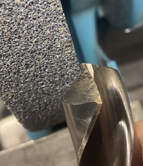

To prevent this the cutting edge can easily be modified with either a oil stone or my preferred way is a offhand grinder.
The photos below show the drill point for brass.

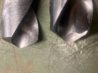

Attachment 43989
Both drills are 20mm diameter. The lower drill is a standard drill and the one above has been modified for brass.

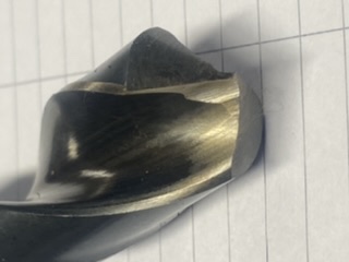

Attachment 43990
Right drill has negative rake for brass.

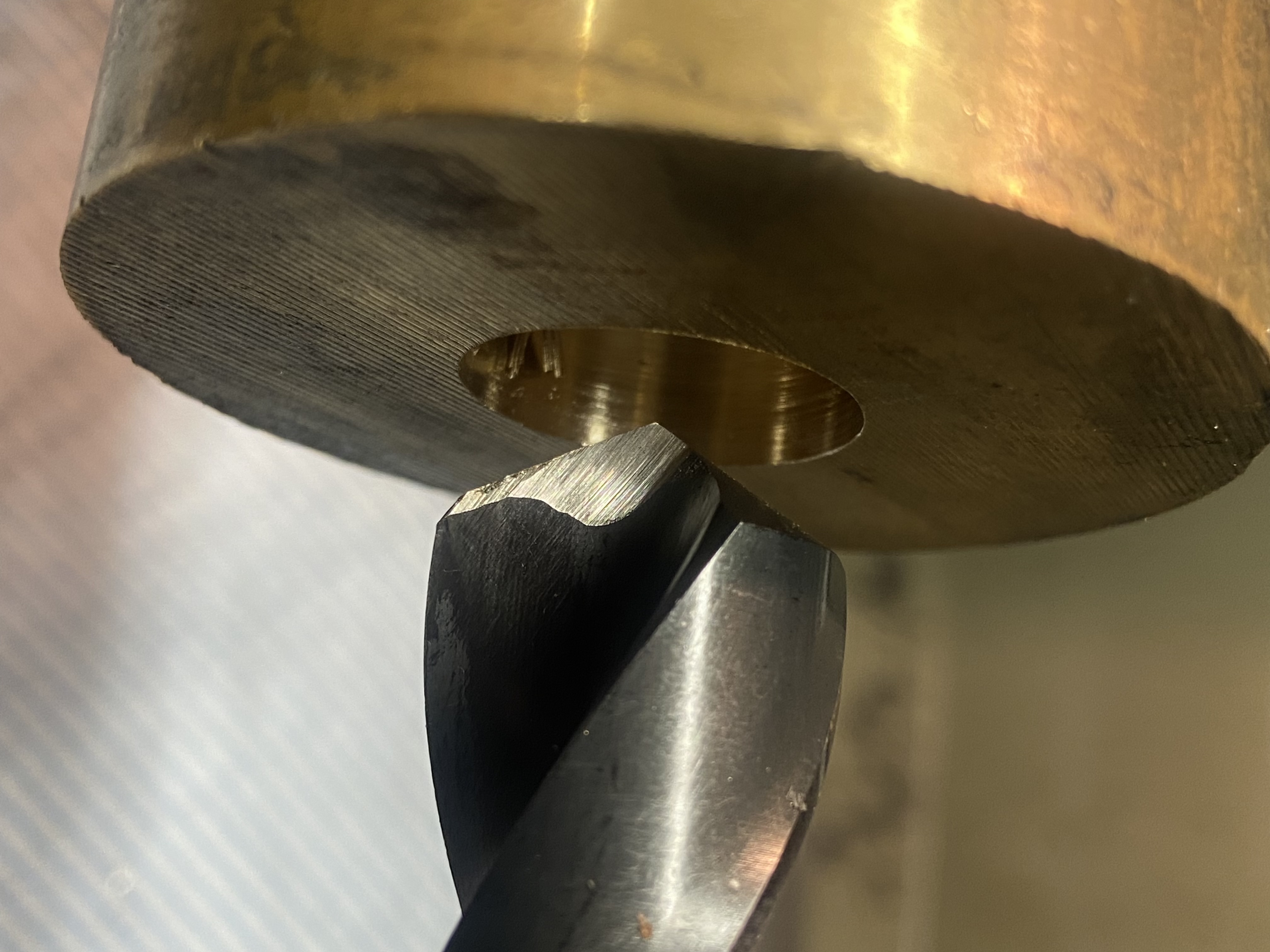

Attachment 43992
Centre drilled and drilled at 20mm so the drill has less chance of snatching. If the hole was to be 30mm diameter a 30mm drill would have been used after centre drilling.

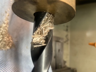

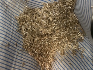

Attachment 43994
Drill chips are removed like small needles.

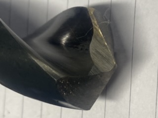

Attachment 43995
Brass swarf collected on a rag to aid clean up.
