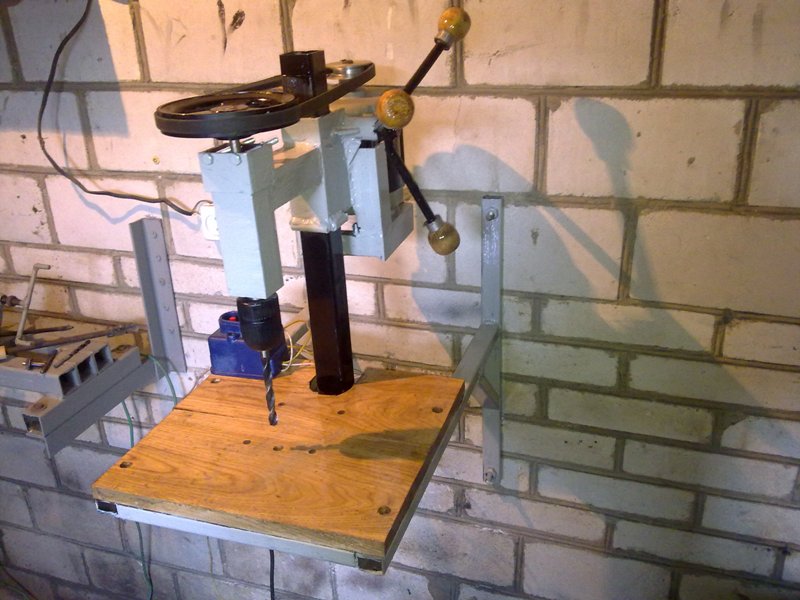

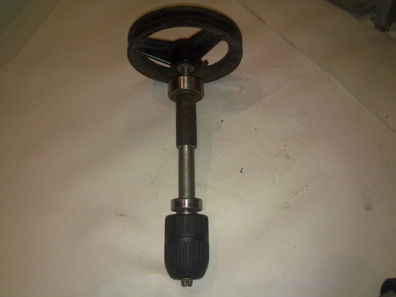

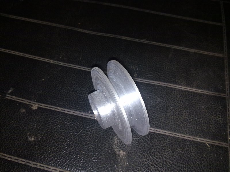

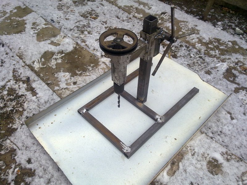

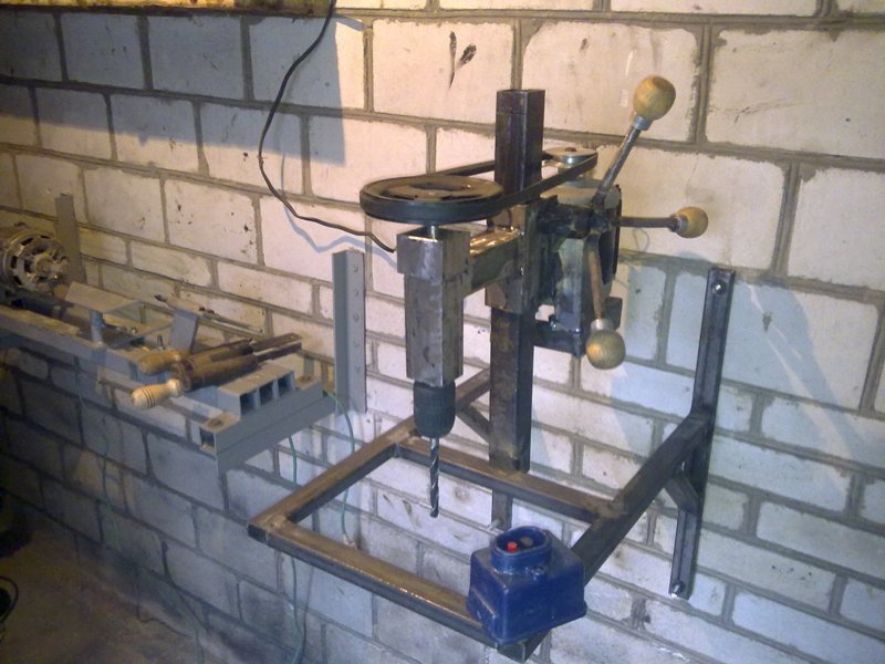

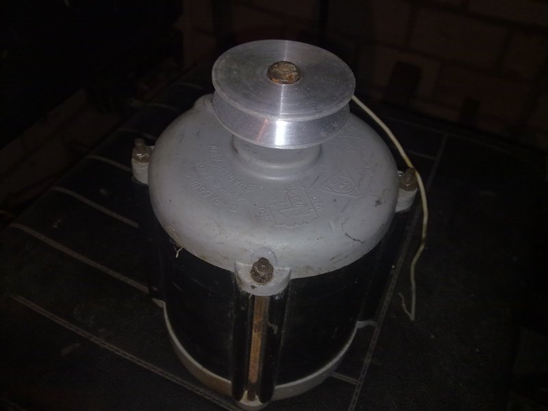

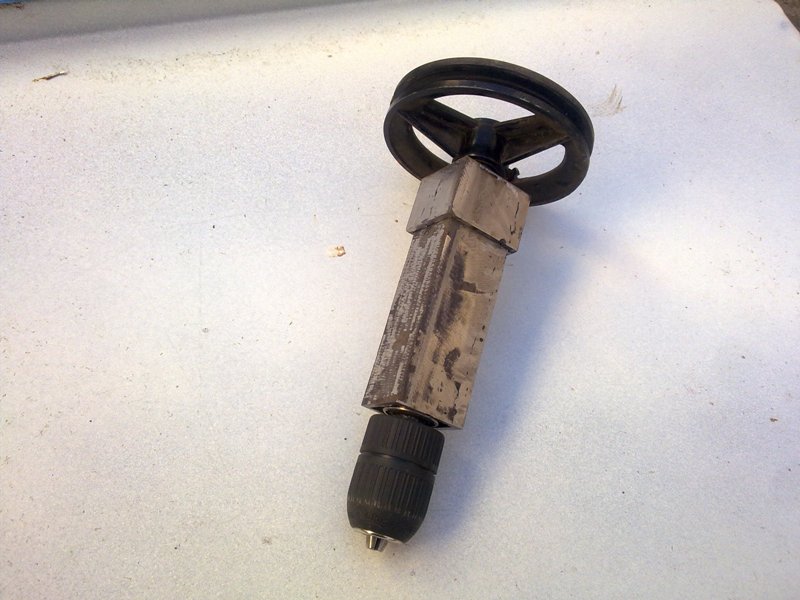

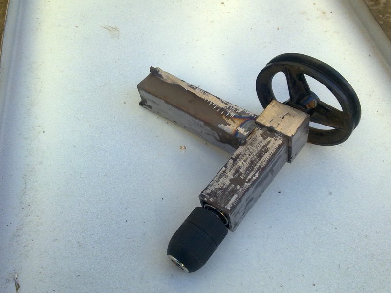

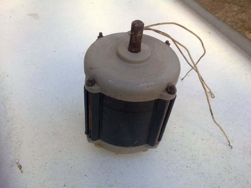

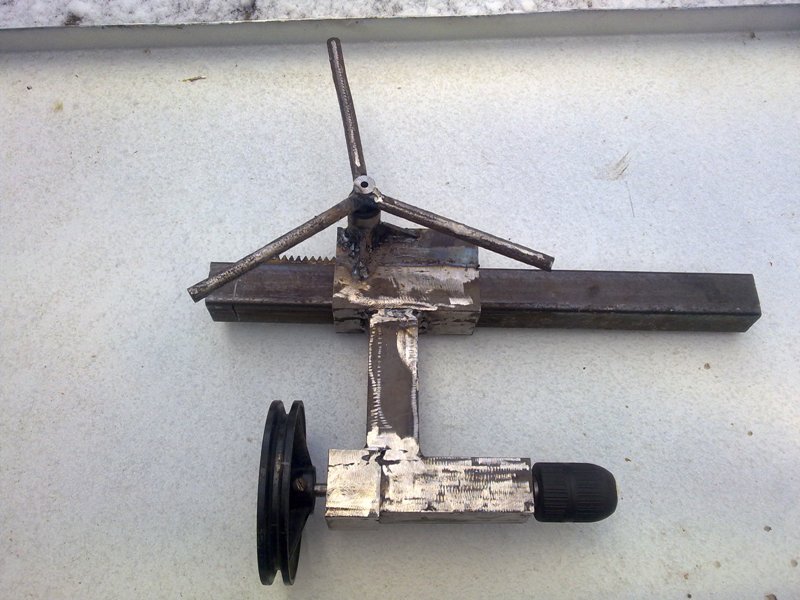

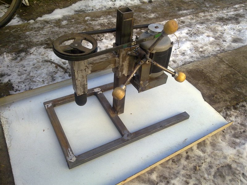

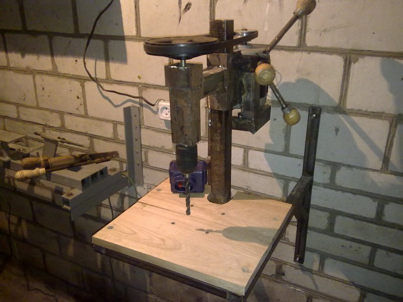

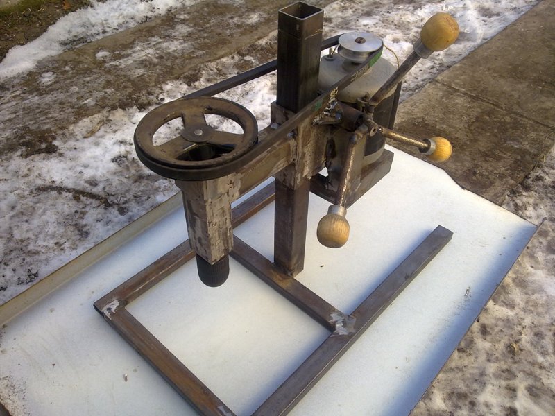

Hi. My homemade drilling machine. The motor of the washing machine 180 watts.
Attachment 9422 Attachment 9423 Attachment 9424 Attachment 9425 Attachment 9426

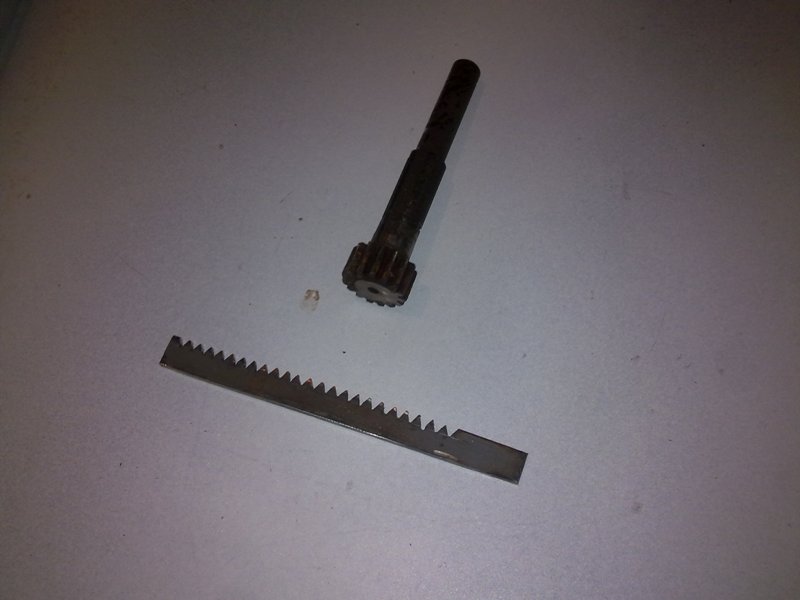

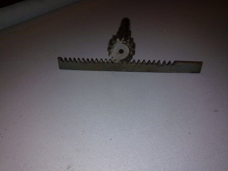

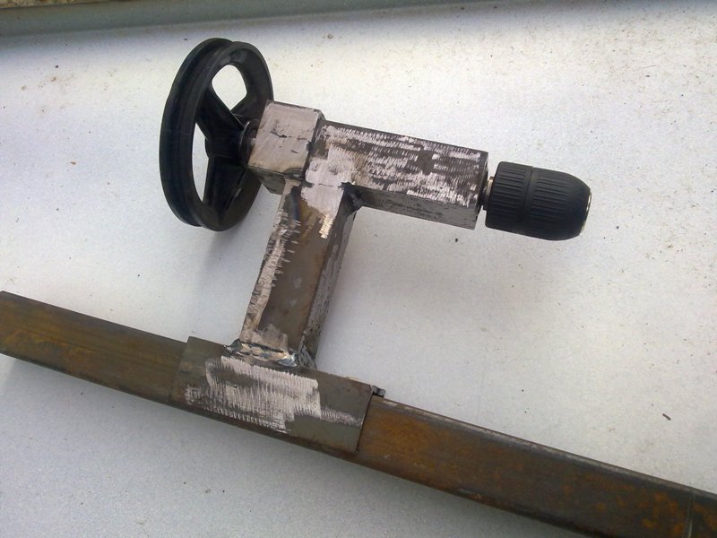

Rails with teeth produced by this tool
Attachment 9427 Attachment 9428 Attachment 9429

How well does your gear rail work? Did you make the spur gear as well? That is pretty good work with a grinder!
Greetings from Canada
That is super work. I like the design, simple but elegant.
Bob
Gracias Vyacheslav, muy posible haga una copia, espero concretar el proyecto.
Great idea, and doing away with the need for a quill too.
Only thing I would do different is to add a second cross brace behind the upright but I may be over engineering again. I just don't like relying on things welded at only one side, but that comes from being a retired class one welder, people were always trying to break welds to show us up. ;)
Love the build though. Hmm no quill. I might have to build one with a really massive chuck and motor just for the sake of it now. Just got to find that old Jacobs 1" chuck now, can't be far, I saw it in my shed about 20 years ago!! lol
Regards, Al
