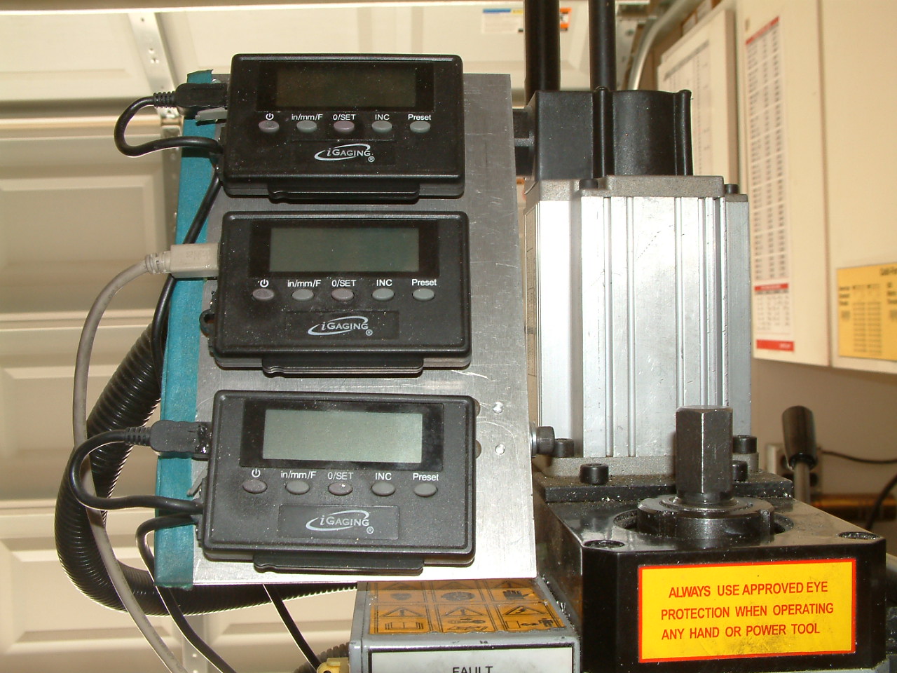

    One of the first upgrades for the Mini Mill was a set of 3 DROs. They are not expensive on ebay and work just fine for my use. I did have to replace one cable and I do have to remember to turn them off when not in use.
    The standard mounting brackets were used on Z and Y axis but the X axis required a custom bit of aluminum to hold the transducer. Works like a champ.

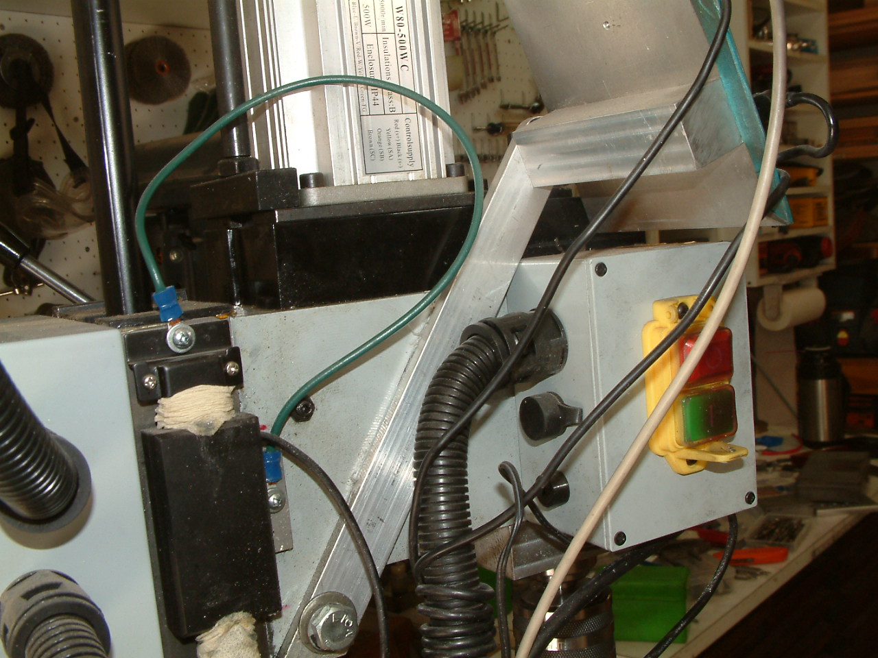

    I found the best place to mount them out of tool and chip harm by making an aluminum panel and arm. I used the hole in the mill head that was for part of the spring counter balance. I had removed the original counter balance and added an air spring. That gave me more height by about 2" and I need that almost every time I use the mill. So far the air spring is working flawless. It has been use about 2 years.

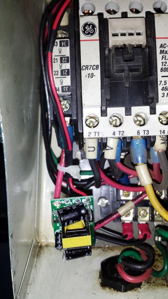

    Thanks for your tip on eBay for the inexpensive DROs. I wonder if you could retrofit inexpensive 120V to low voltage DC power supplies for the power sources. I discovered some on eBay for $5 and have used them to power my mini and 12" geared head lathes' tachometers. Here is a photo of these tiny power supplies (in lower left-hand side of photo) and these work well for low power demand devices.
    Dro Mounting Panel for the Readouts Mini Mill-110vac-9vdc-power-supply-wired-line-.jpg
    For safe use this would have to be placed in the some enclosure for the power electronics to the mini milling machine so the 120VAC is covered and then feed three pairs of small gage wires to the DROs. In my example, it is in the power supply and relay box to the lathe.
