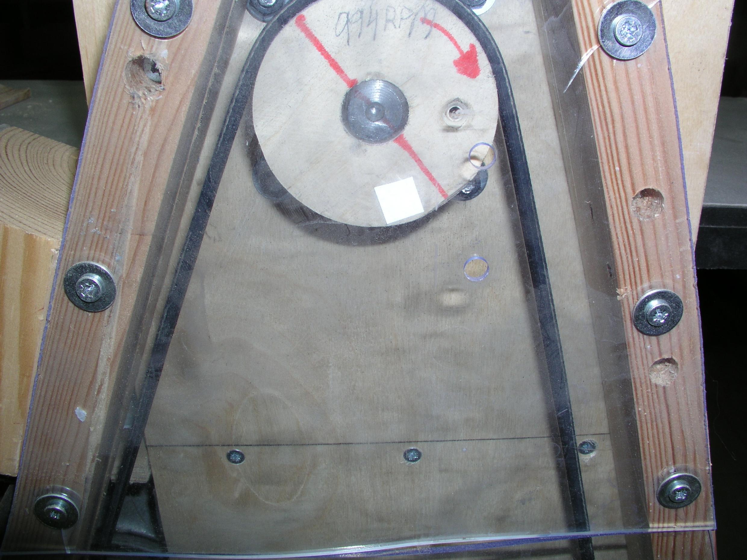

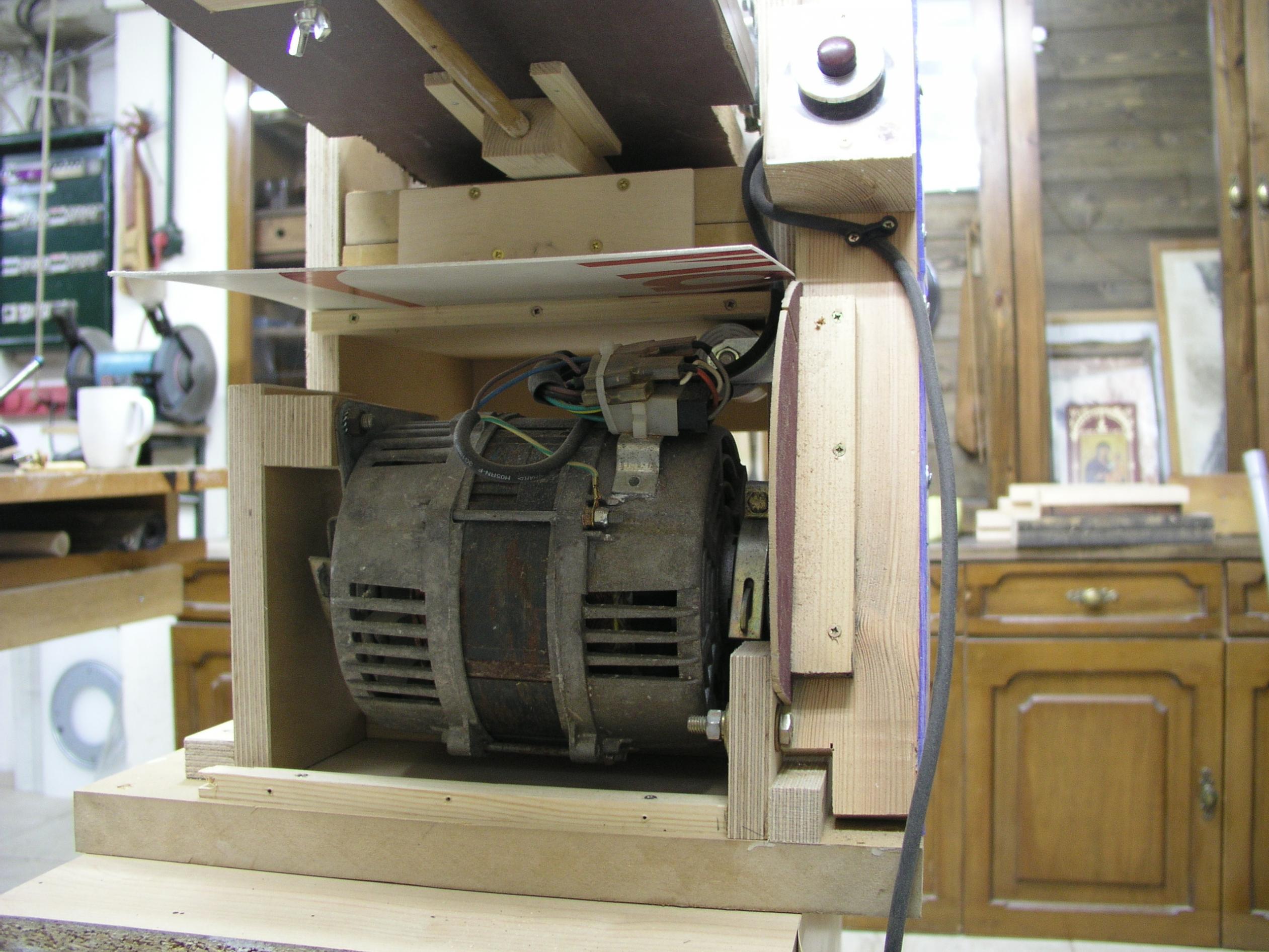

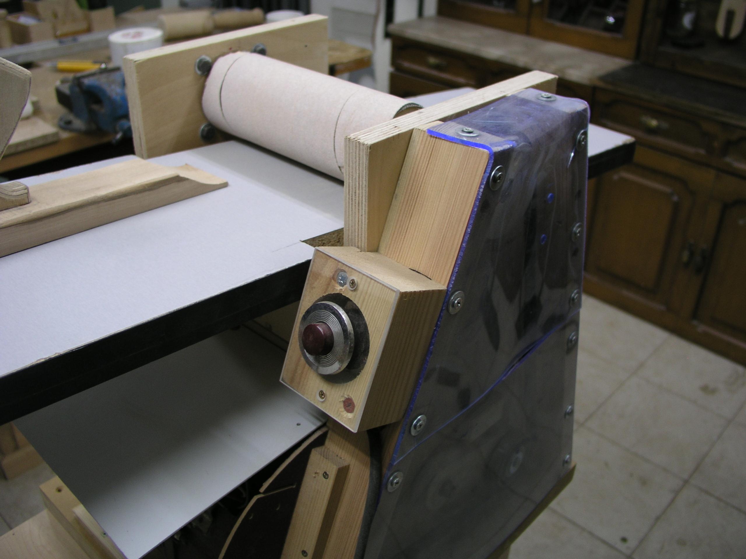

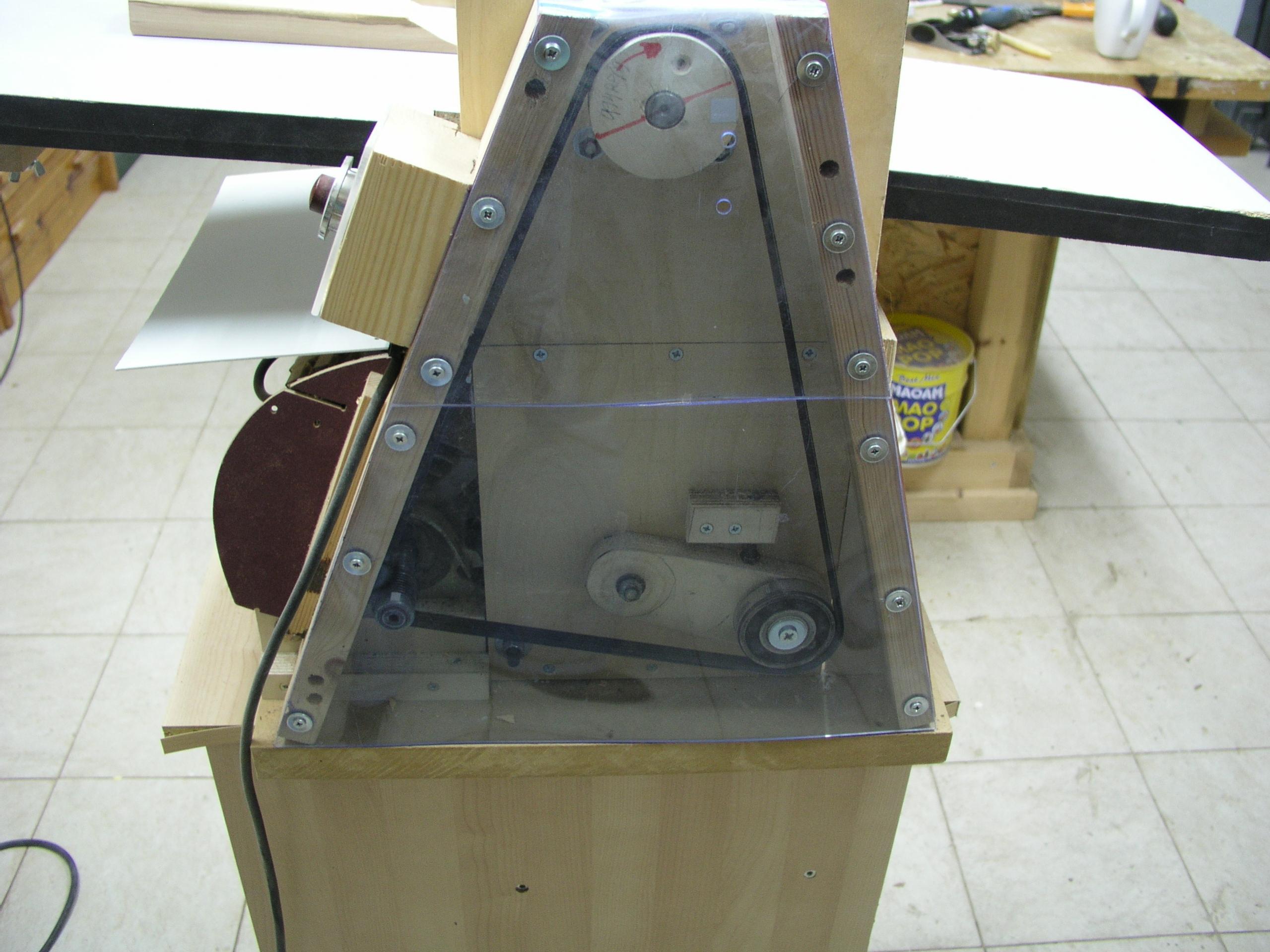

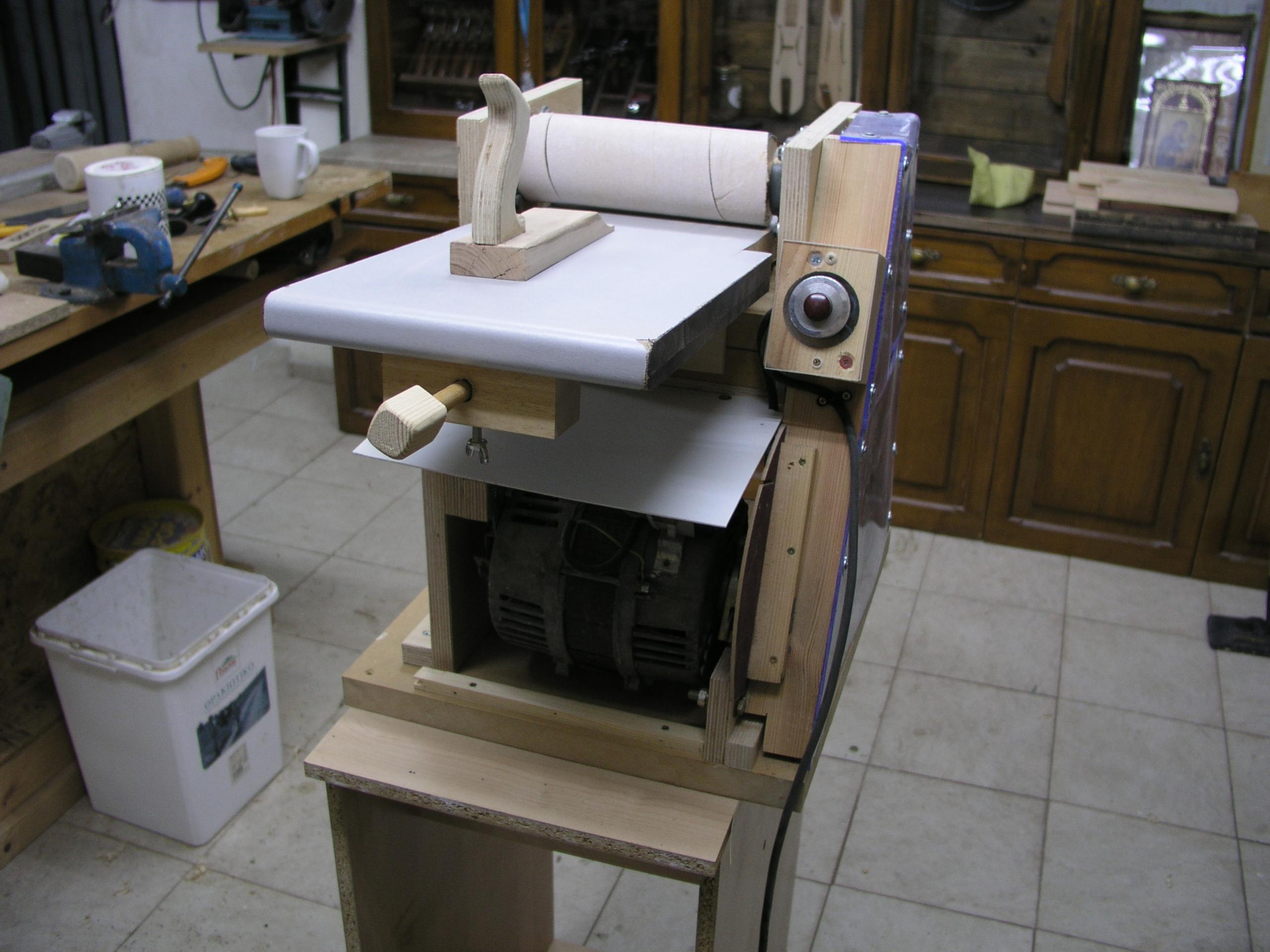

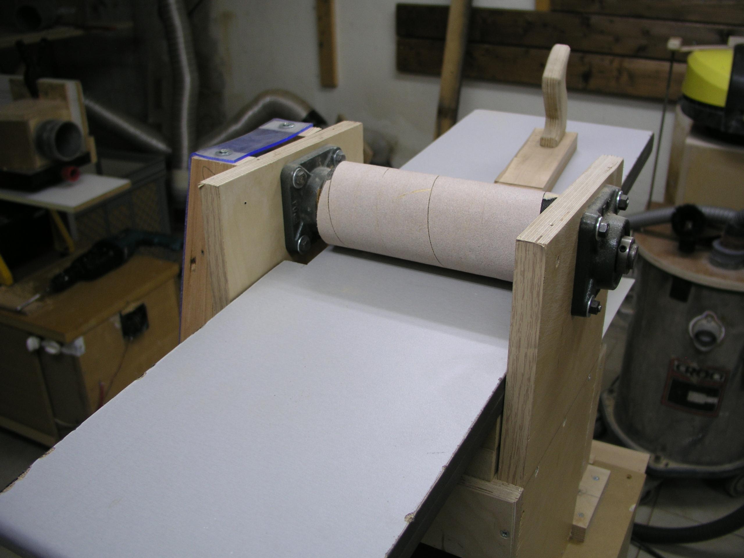

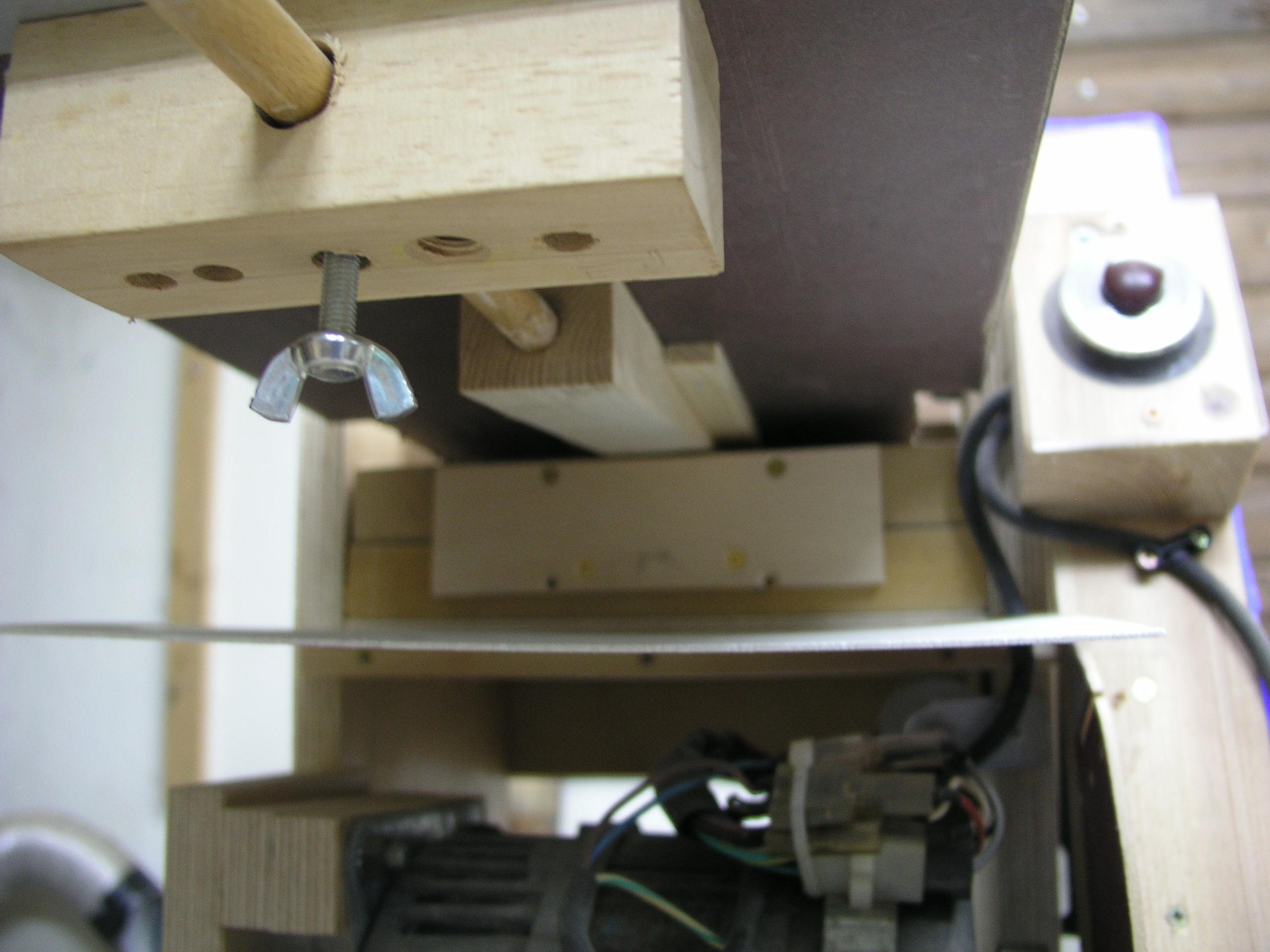

    this is the drum sander i made

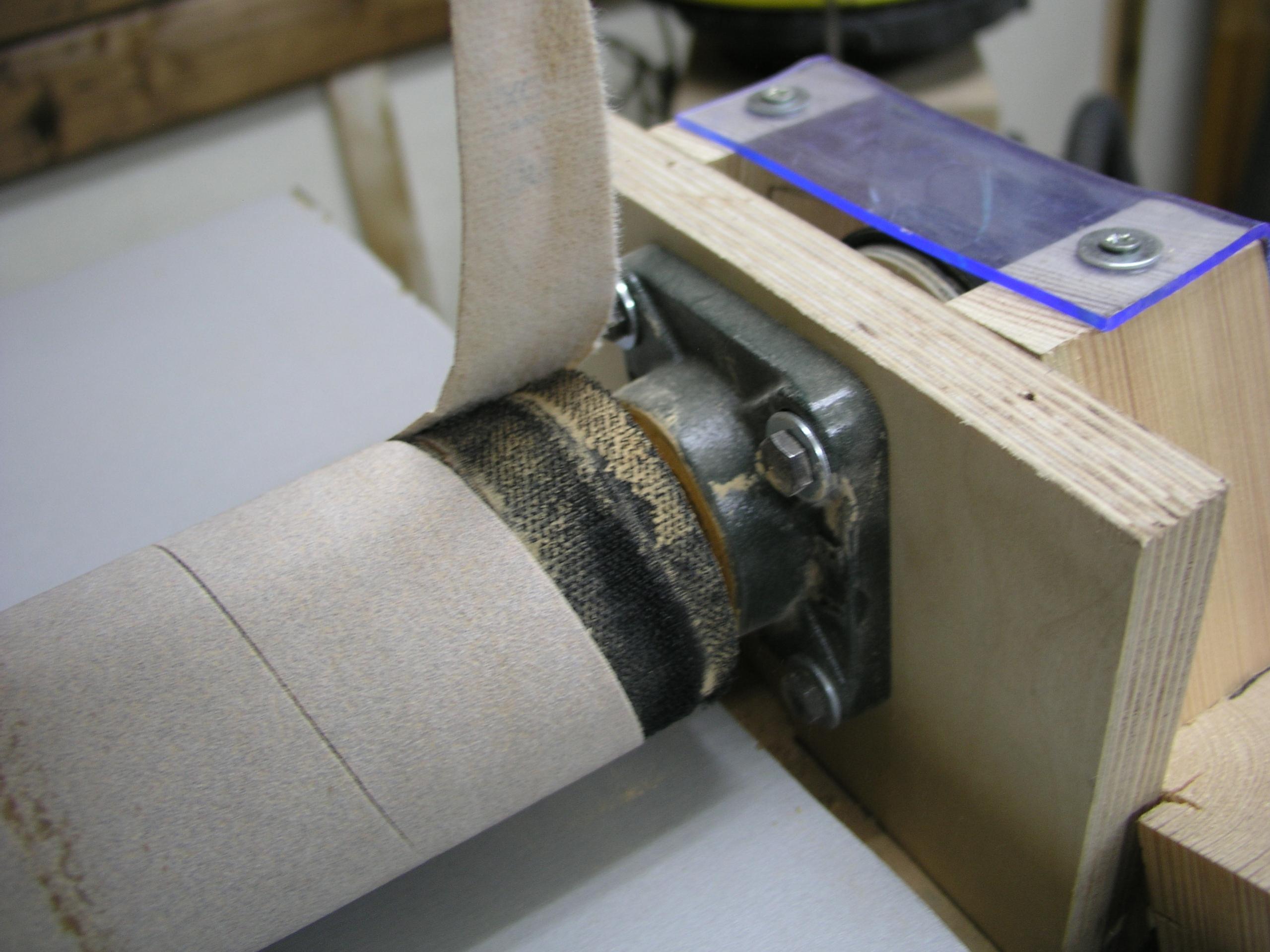

    Nice build, panosam! What's the roller made from?

    Quote Originally Posted by DIYer View Post
    Thank you. I cut cycles and glue them together on the axis. I also put two pins, to prevent spin. Then i run it and make it straight wtih a chisel and a block ( like lathe)

    I like the idea of the wedge for tilting the table, but you could have put a long threaded rod to push of pull the wedge ? (easier for fine tuning ?)

    Quote Originally Posted by Christophe Mineau View Post
    thanks
    as the angle of the wedge is small and the wedge long, it is easy to fine tune. Thanks for the comment
