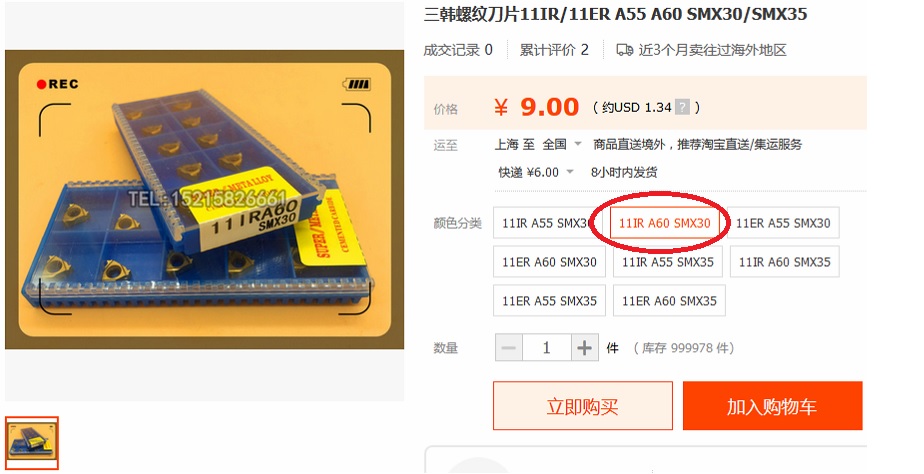

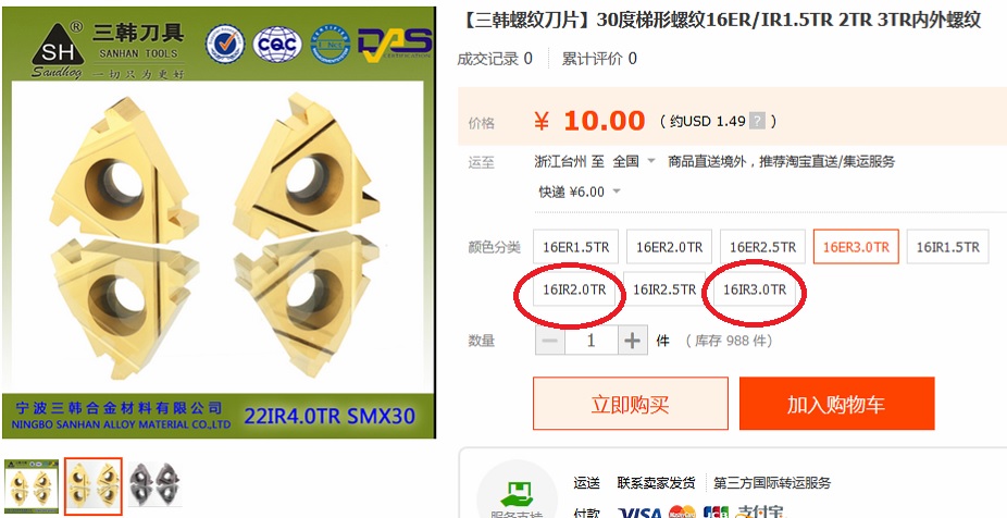

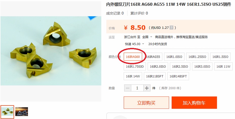

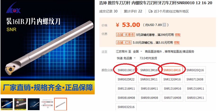

    Hi,
    I also spent too much time searching for threading tools, bars and inserts, but I have good excuse.
    Can't speak Chinese. And I found them all at www.taobao.
    So, these bars for threading inserts are called SNR Indexable Internal Threading Tool.
    But I think that these can't be used with 60 deg boring inserts. Will check if possible once I
    am home again. I already collected all information and placed order for 3 different sizes
    of above and also for threading inserts. Here below is what I will get soon in China.
    Best regards
    LMMasterMariner
    Attached Thumbnails Attached Thumbnails A dumb lathe threading question-snr-tool-holder.jpg   A dumb lathe threading question-16-ir-tr.jpg   A dumb lathe threading question-16-ir-ag60.jpg   A dumb lathe threading question-11-ir-a60.jpg
