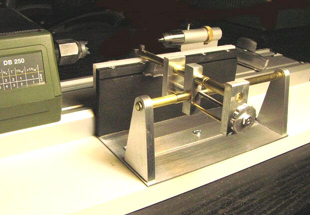

I built this duplicator accessory for the Proxxon DB250 wood lathe. It is essentially a half-scale version.
Attachment 22736
Attachment 22736
Looks good, hope it serves you well. May i ask what you used for a cutter? Thanks ia advance.
Eric
Thank you, Eric
When I sold my Jet mini-lathe it had the Penn State Universal Duplicator. I had forgotten I had an extra cutter for that duplicator and it fit my tool quite well. The cutter is available from Penn State.
Thanks, how smooth is the finish from the cutter? Thanks
Eric

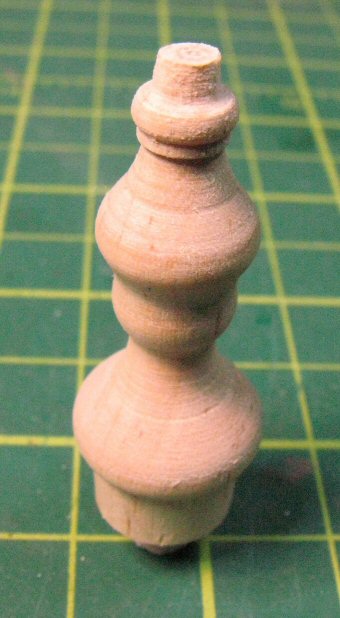

Because the cutter has to be sharp to follow fine detail, the finish will occasionally require a little sanding. If the template does not have fine detail, the cutter could be shaped with a small radius on the end.
Attached is a typical piece showing a very light sanding. It would require more finishing to be usable.Attachment 22752
