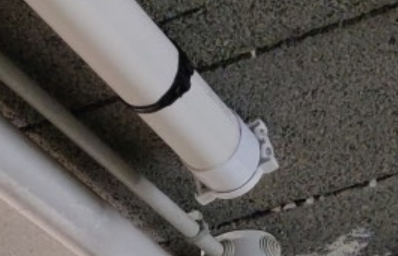

Connection of the CNC hose to the port just above mounted on the ceiling :
https://www.labellenote.fr/file/home...stShoe_019.jpg
View of the PVC hose network, heading towards the shop door, where the remotely activated shop vac is installed.
