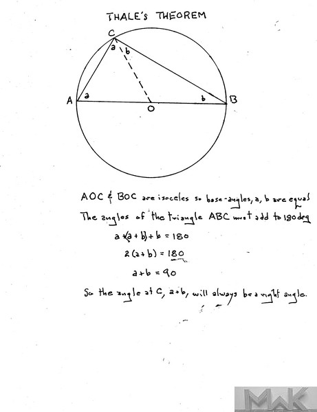

If YOU pick a random point on the circumference of a circle and from it draw straight lines to the ends of a diameter you'll find that the vertex angle these lines form at the circumference is ALWAYS a right angle.[A proof of this follows below.]

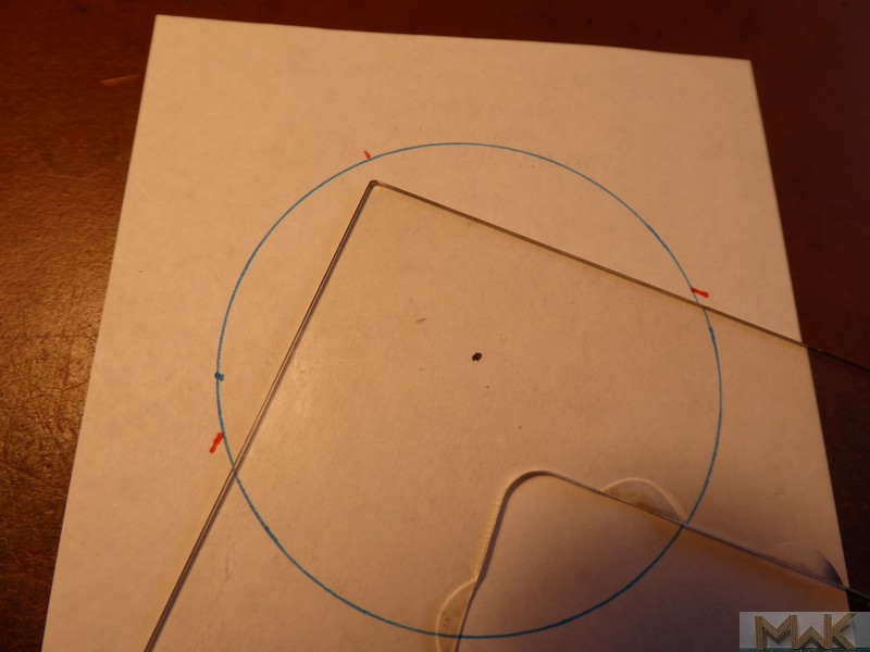

Rather than start with the diameter and construct the angle on the circumference, let's place a right angle on the circumference and mark where its legs contact the circumference. Those two points should lie on a diameter and, if you can find two (different) diameters their crossing point is the center of the circle.
Attachment 48506
I've positioned the right angle of one of my drafting triangles on the circle and marked the three points where it contacted the circumference.

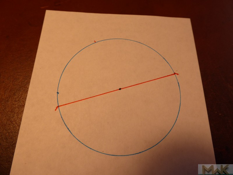

Attachment 48507
After connecting the points defined by the legs of the right angle with a straight line, we note that the line passes through the middle of the circle; therefore it is a diameter.

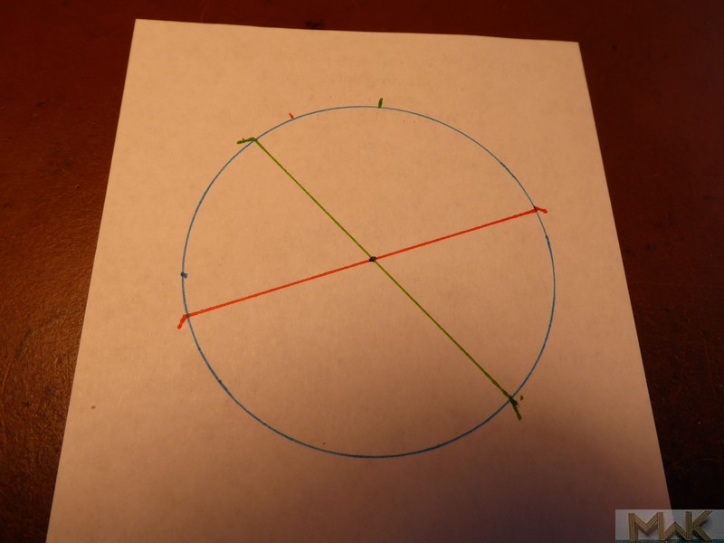

Attachment 48508
Repeating the process with another randomly chosen point on the circumference yields another diameter that intersects the first diameter at the center of the circle.

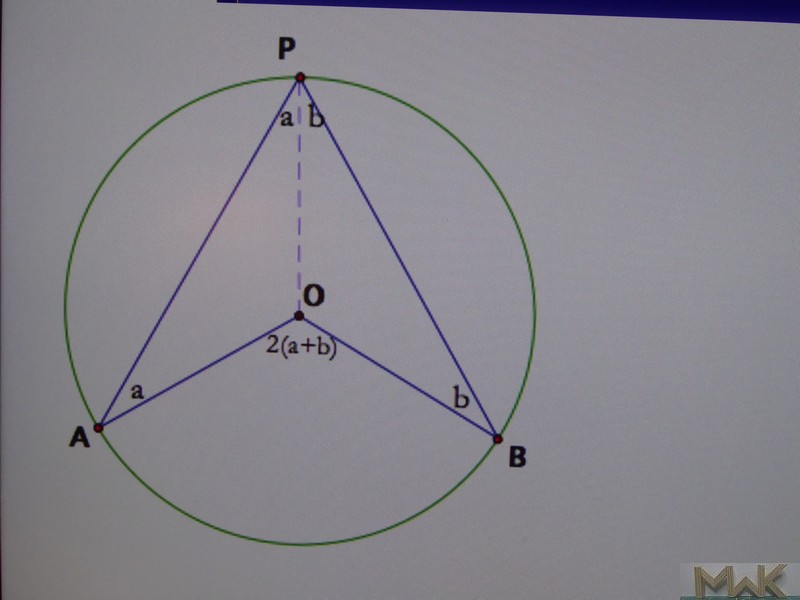

APB is termed an "inscribed angle"; its vertex lies on the circumference of the circle.
AOB is termed a "central angle"; its vertex lies at the center of the circle.
Both of these angles intersect the same arc on the circumference, AB

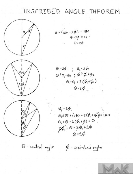

We want to prove that, under these conditions, the central angle is always twice as big as the inscribed angle.
By drawing the radius, OP, we create two smaller triangles, POAP and POBP
Each of these triangles are isosceles so their base angles, 'a' on the left, 'b' on the right are equal.
Then the angle POA = 180 - 2a and POB = 180 - 2b
Along with the central angle, AOB, these angles must add to a complete circle, 360 degrees.
(180 - 2a) + (180 - 2b) + AOB = 360
which reduces to:
AOB = 2 (a + b)
The inscribed angle satisfies APB = a + b
So, the central angle is always twice the inscribed angle if they both subtend the same arc on the circumference. QED

If APB = 90 then AOB = 180, i. e. a straight line, and divides the circle into two equal 180 degree halves. Thus it must be a diameter and, if it's a diameter, it passes through the center of the circle.
