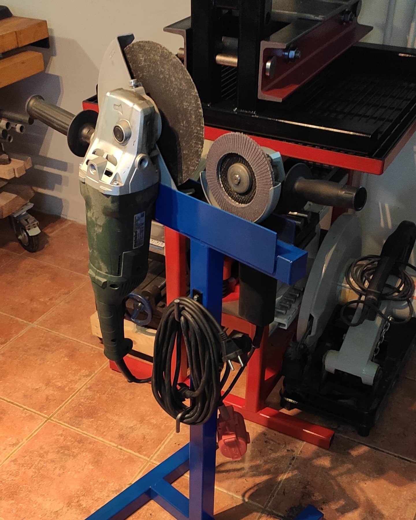

I usually use angle grinders outsides.
And i hate to lay them to ground between cuts.
I made this simple stand / rest.
Where i can put grinders to rest, meanwhile i weld or do something else.
Attachment 39697

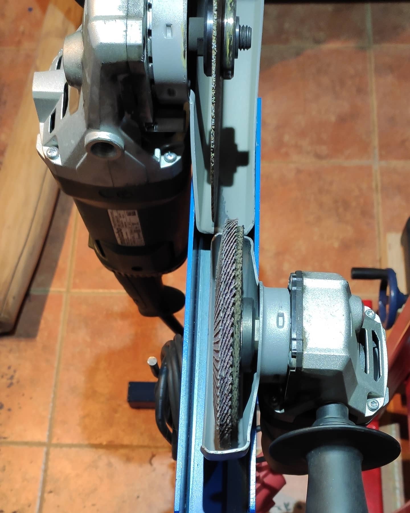

Stand is made from 40 x 40 x 1.5mm square tube.
To the upper part i weld pieces of plate to the sides of the tubing.
Attachment 39698
This creates a groove that holds grinders from the guard / or wheel.

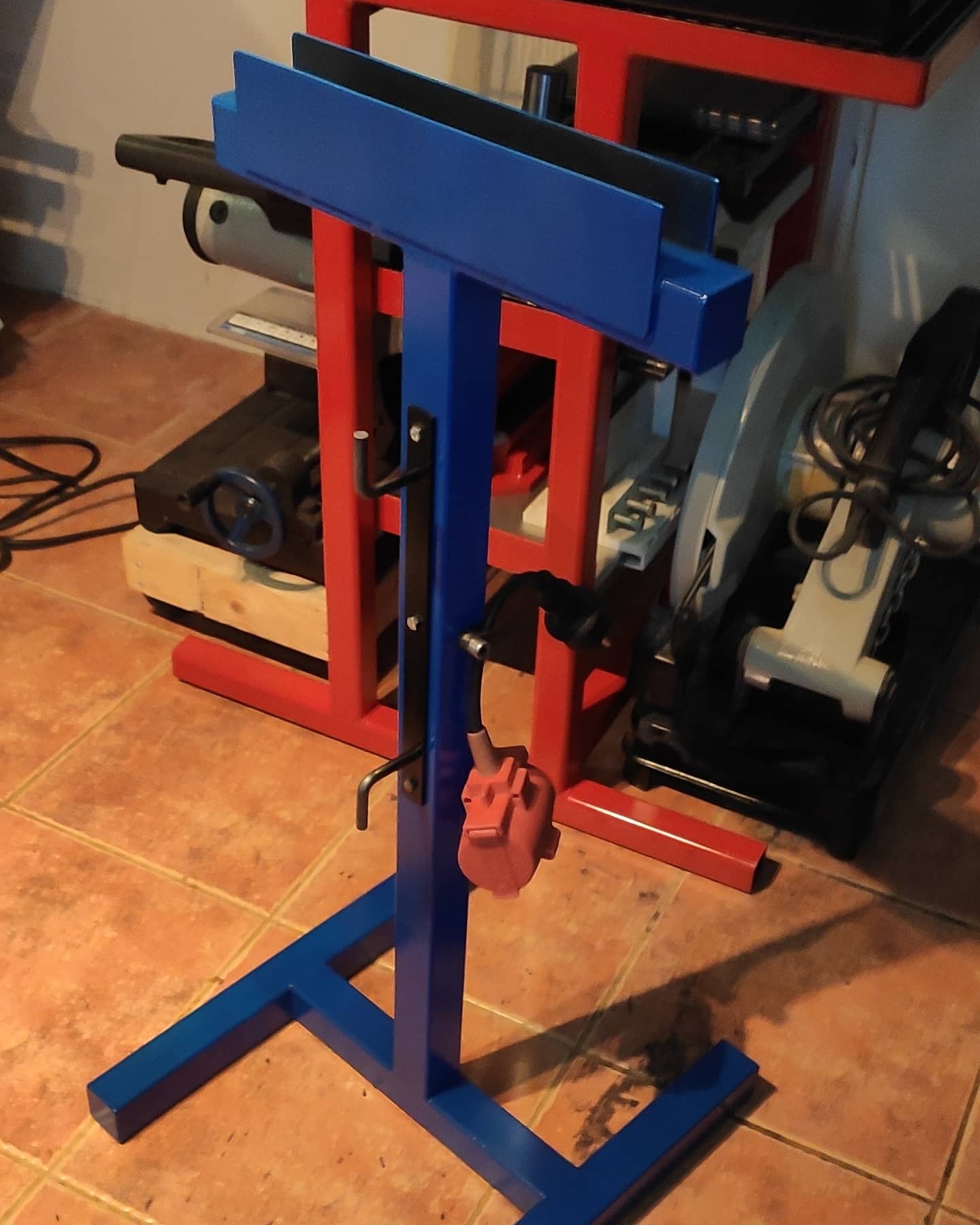

Attachment 39699
When not in use, there's hooks for the cords, and grinders are nicely stored. When i go outside, i grab the whole set with me, and im ready to work.
