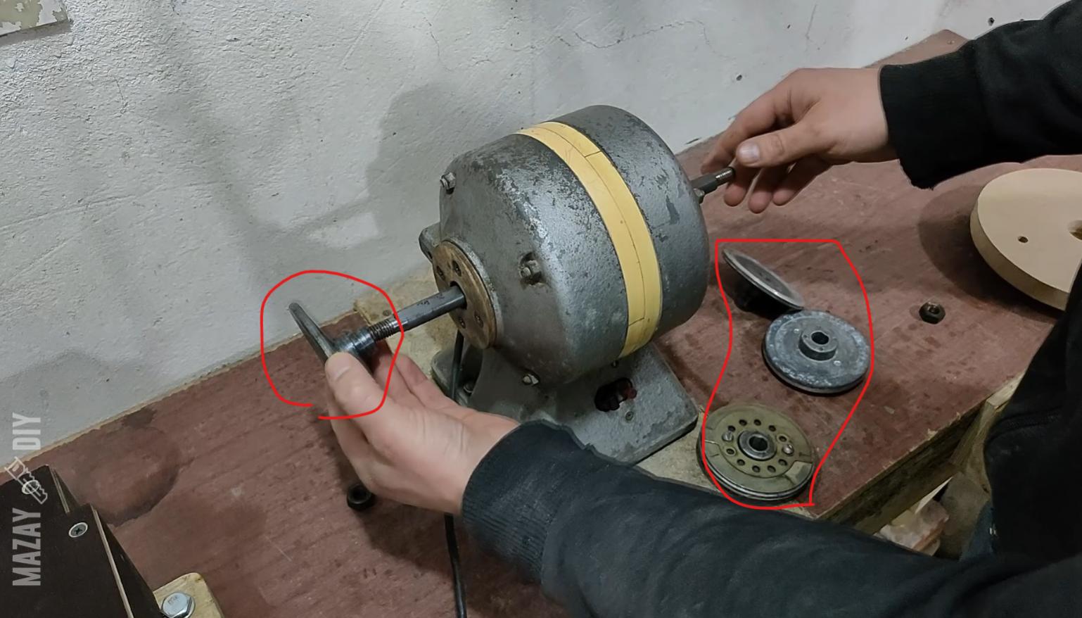

    Do you mean these plates?
    Easy way to Sharpen a knife within a minute with Paper Sharpening Wheels-_2021-05-18_191702.jpg
    If so, these are the parts (flanges) of the bench grinder. I recommend using flanges that are part of your model's grinder, even if they look different
