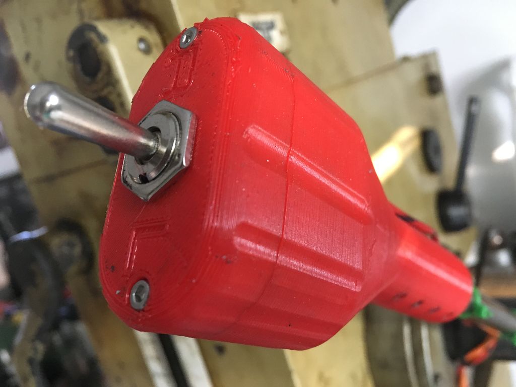

Hi all
in my first post I want to show you my ideea of a drill press handle. It containes a 3 position switch with central "zero" for selecting the desired direction, "fwd" or "rew". I designed it mostly for tapping.Attachment 25329

Nice idea and very nice 3D printed part.
Thanks !
it took about 5 hrs to print it because of 75% infill and solid layers every 2.5 mm.
very easy to use. In some future I will redesign it, just tot make it a little bit slimmer.
I had this garbage drill press at work. I set up a foot switch to go.
But this foot pedal switch can be expanded to this idea . Forward and Reverse.
Cool idea .

That's a really good ydea! My old 1950-something Craftsman drill press has the switch in a very hard to find location on the left side up fairly close to the belt. I never thought of extending hte switch on a "dongle" (that's what we would call it in the computer world)
I admire this project. I power-tap frequently on various machines, our drill press being the least accommodating. This would solve it.
I'm interested what means attain a convenient "o'clock" position. Table height is a good start, with tapping a relatively shallow operation. Could a clamp substitute a knob, readily moved to any of the three arms, or 3 half-knobs?

Back when I had a drill press that had the adjustable rotational speeds to do power taping I had 3 different sizes of the tap o matic style self reversing devices. No need to reverse the drill press.
