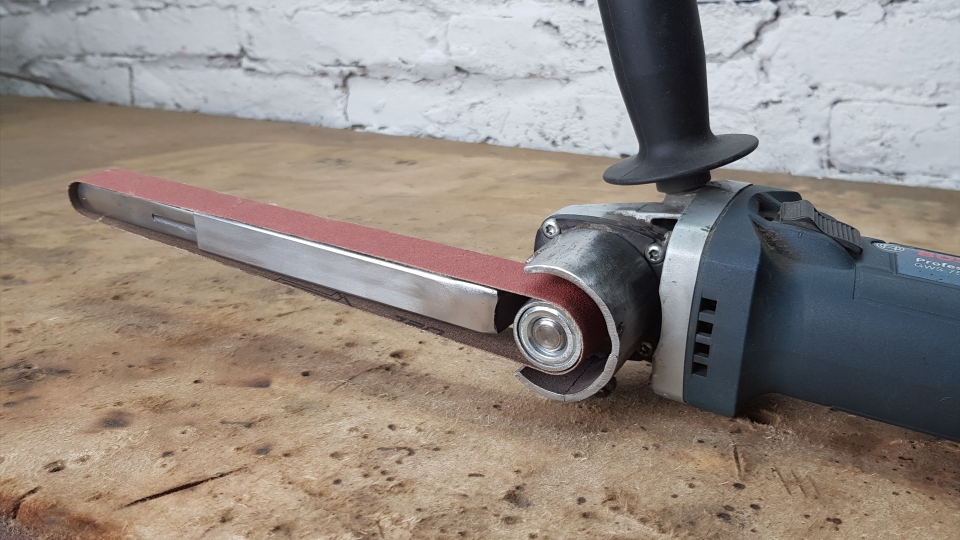

Electric file from an angle grinder
This time a device that I put off until later, but I missed it many times.

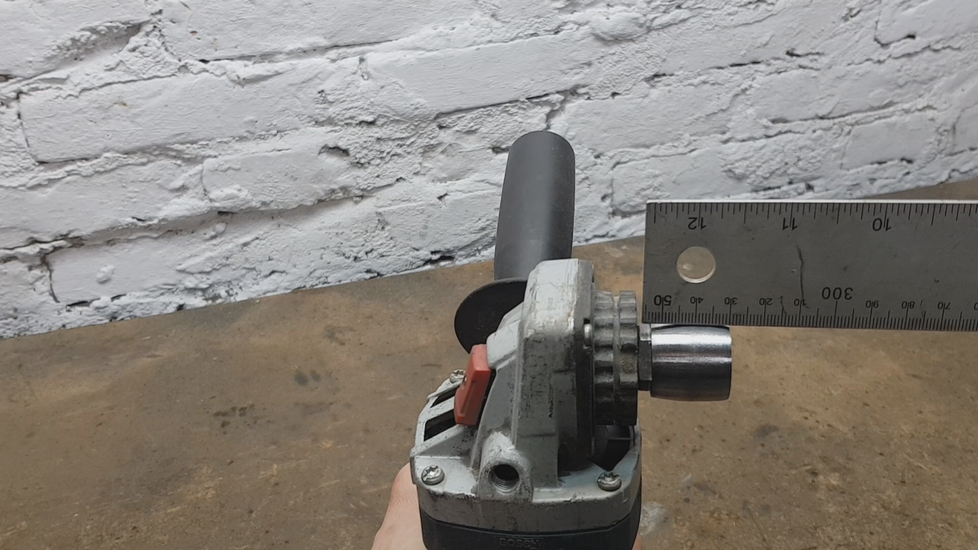

The barrel-shaped roller is made of an M14 bolt and a tube.

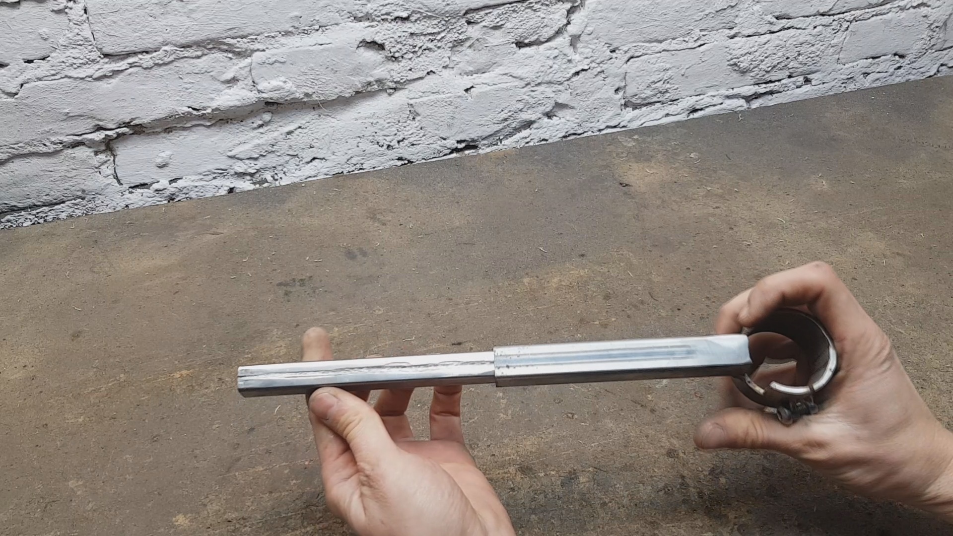

The guide is made of two profiles that are perfectly matched so that there is no unnecessary play.

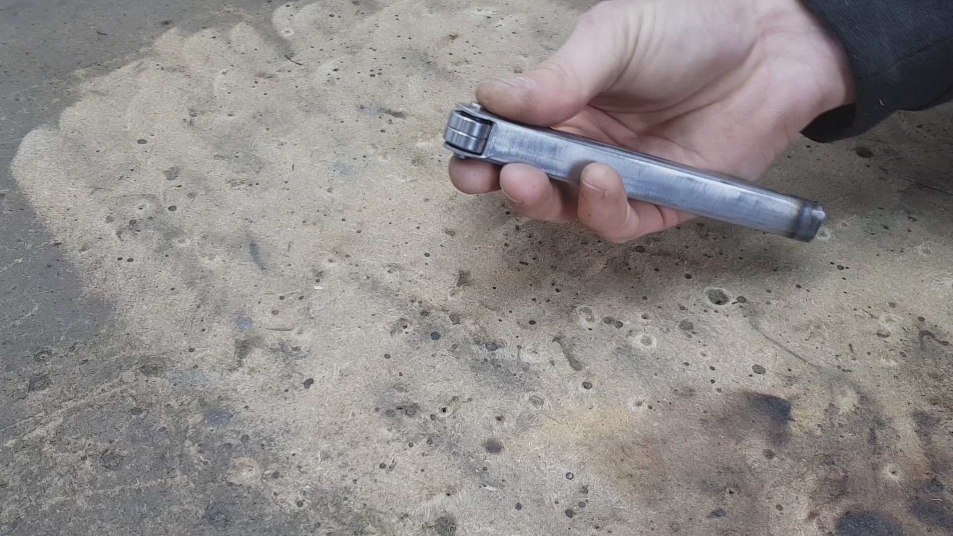

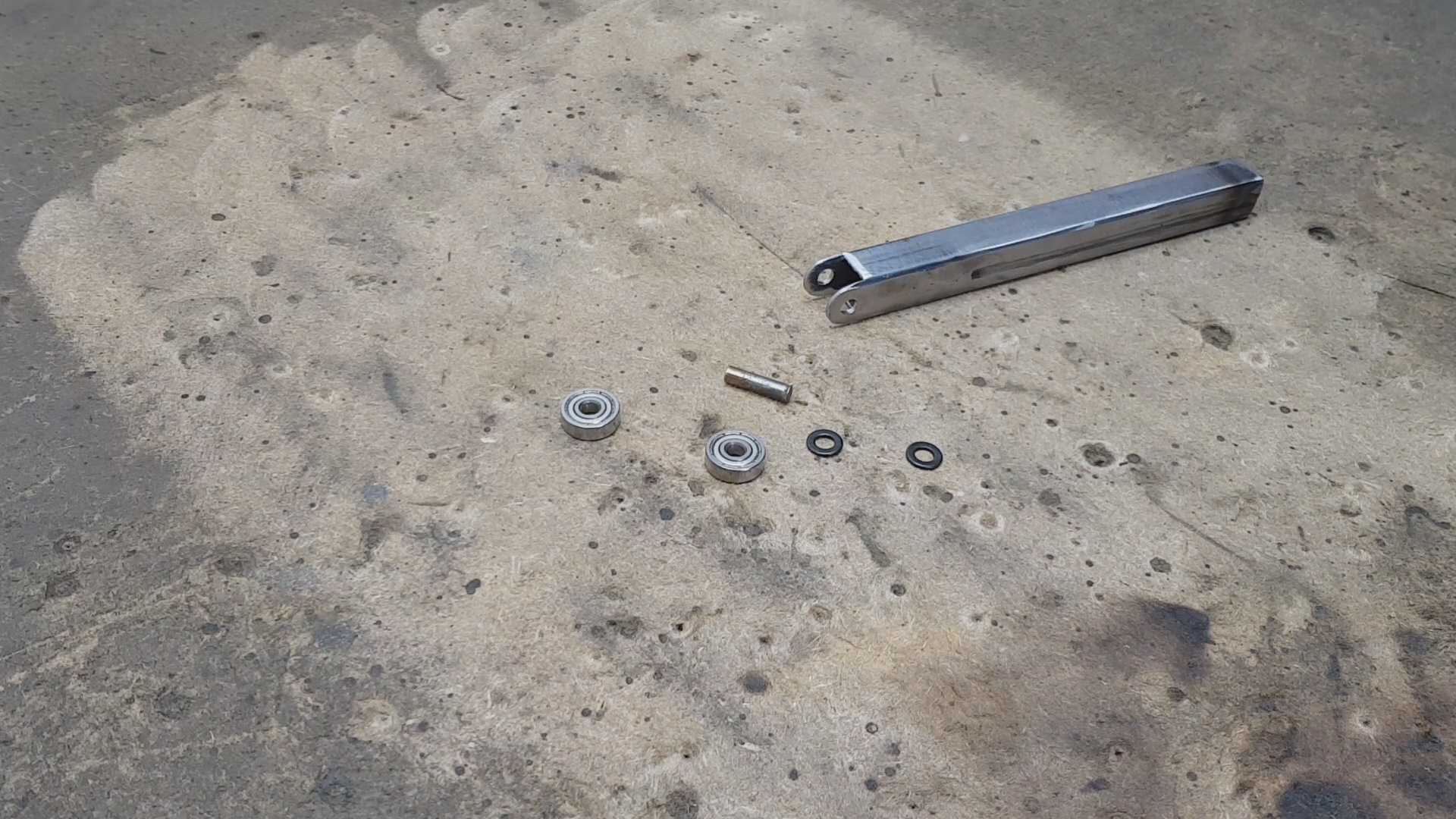

The front roller consists of two 625 bearings, two washers and a 5mm rod.
Attachment 37741
Attachment 37742
