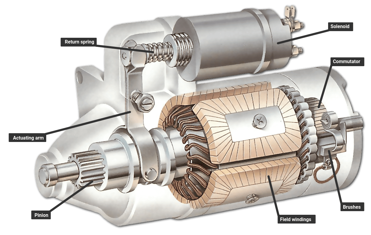

Can you provide the mfg & model number of the solenoid used. I'd like to see the specifications.
Nice idea. Looks like a solenoid off of a starter!
Thanks for the interest rayh__! The code I have is 933A081039 BOSCH, but I don't know if it is universal. It is an automotive solenoid found in scrap metal.
That's right, it's a car starting solenoid. Mmwmkravchenko, thanks for watching!
The solenoid works in the same way as the car: carcass (-) + line 15 (+) = retention. Smaller pin (-) + line 50 (+) = overheating (caution).
