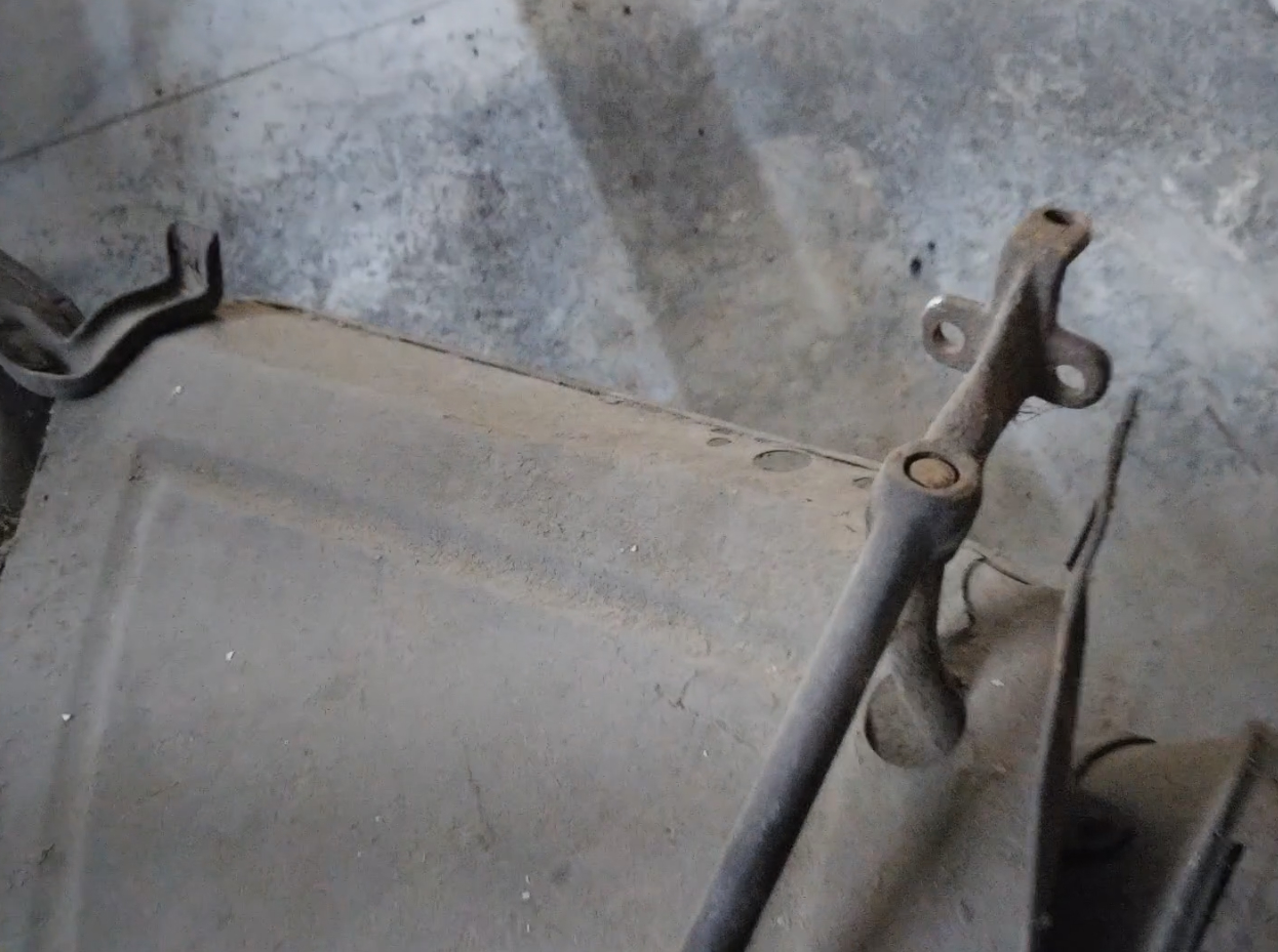

    This photo is the underside of the removed left front fender. The iron forging is the support bracket. There is a threaded portion that is gone, as the two kids that removed this from the truck in 1972 twisted (the hex nut that pulled the taper joint closed on the threaded) stud off. Notice through the hole in the fender, the head light bracket (electric, but truck also had kerosene side and rear lamps major restoration of them needed). That is the damaged part I'm trying to remove, and just did heat yesterday, but not enough. I purchased a 1KW hand held induction heater. But it needs a O-A torch to get this done, just was hoping I could do it easy.
    I'm trying to remove that head light bracket, so I can weld back on the fine thread stud that used to be there (and replicate the hex nut). I've not found these brackets on any after market or used for sale, (just started), but would like to repair, as that's the real hobby, fixing broken stuff, a hoarding sickness fed problem in my life.
