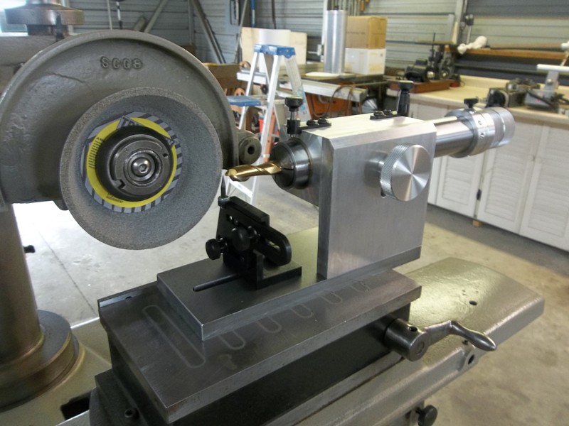

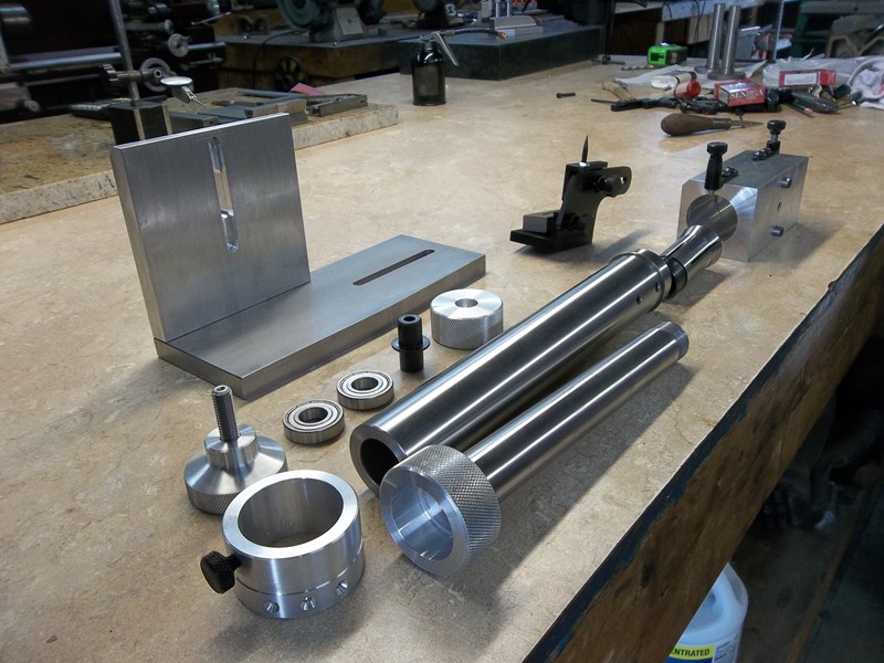

Hi all,
Here's the final part to my Endmill cutter/grinder series......

Very good job building your end mill sharpener MachineNZ
I watched all 4 of your videos they were very well executed, this fixture will save you a lot of money, I built a fixture to use on my surface grinder few years back and it's saved me quiet a few bucks.
Great Job Doug
Attachment 30120 Attachment 30121
Nice, Thank You. I have a problem with grinding the flutes grinding the top reduces the diameter of the end mill seems like you should
grind the face of the flute.
Ralph
Ralph I can see your way of thinking but grinding the flutes of an end mill is a whole new ball game for the home workshop and even that will reduce the diameter to a lesser degree and would not restore worn out lands. Reduced dia end mills do not affect their main use and can actually be quite useful to machine a slot to a size.
Yes BUT!!
Ralph, working on it!!
