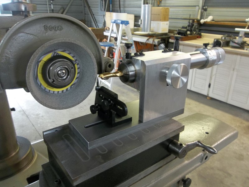

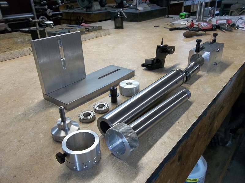

    Hi all,
    Here's the final part to my Endmill cutter/grinder series......

    Very good job building your end mill sharpener MachineNZ
    I watched all 4 of your videos they were very well executed, this fixture will save you a lot of money, I built a fixture to use on my surface grinder few years back and it's saved me quiet a few bucks.
    Great Job Doug
    Endmill Sharpener - Part 4......Final - Sharpening & Testing-4.jpg Endmill Sharpener - Part 4......Final - Sharpening & Testing-8.jpg
    Comments are always welcome
    Doug

    Hi Doug,
    Thanks....
    All whats left to do is find some sort of rigid base for it to sit. That will have to wait as I have other projects I need to complete.
    Regards
    Kevin
