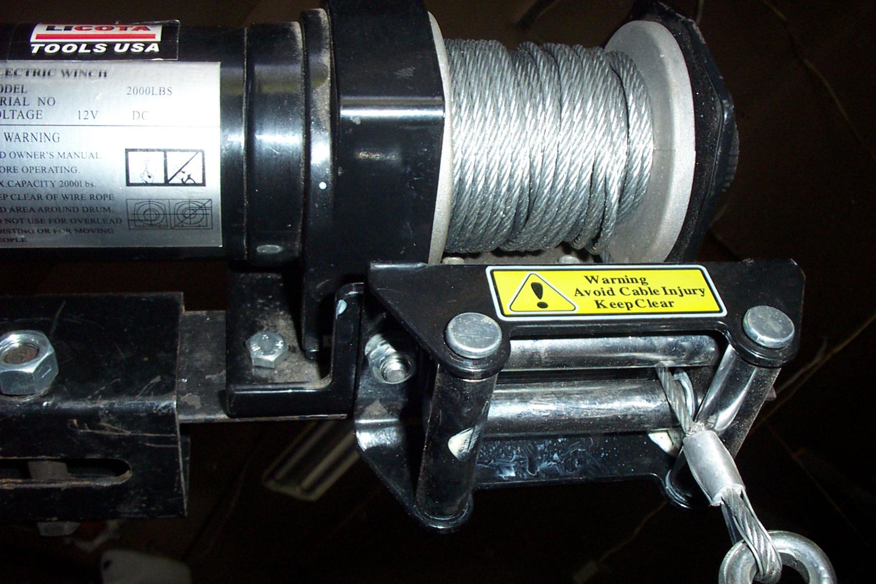

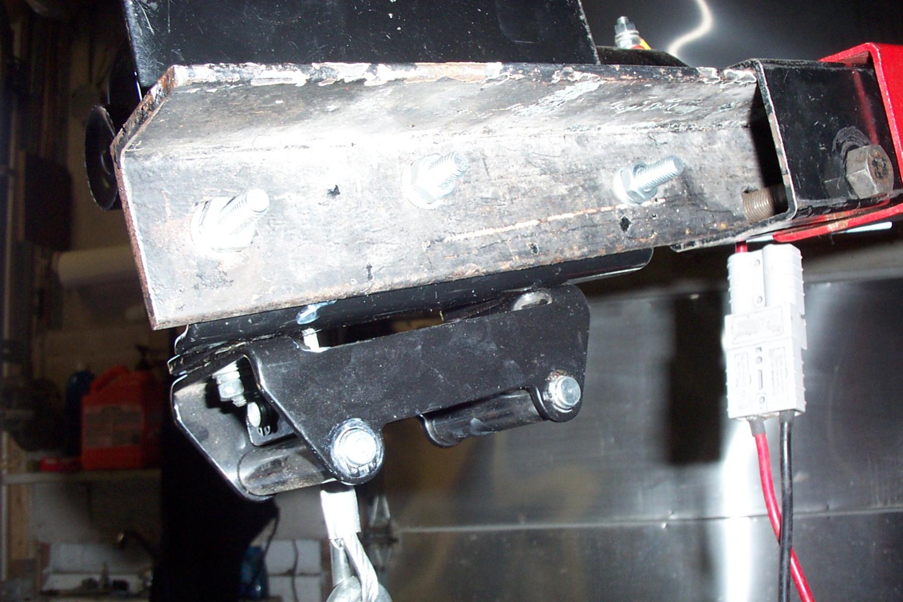

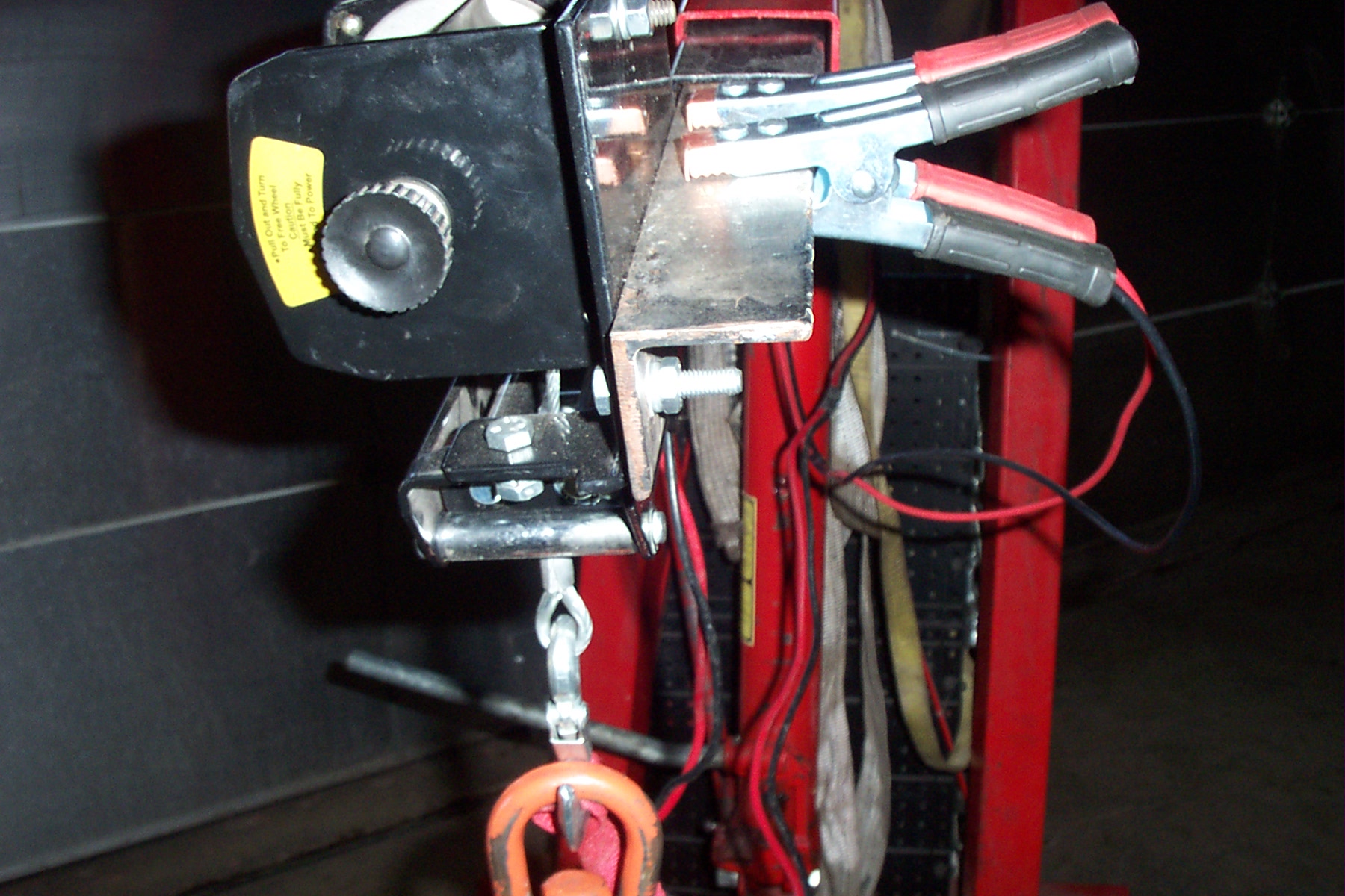

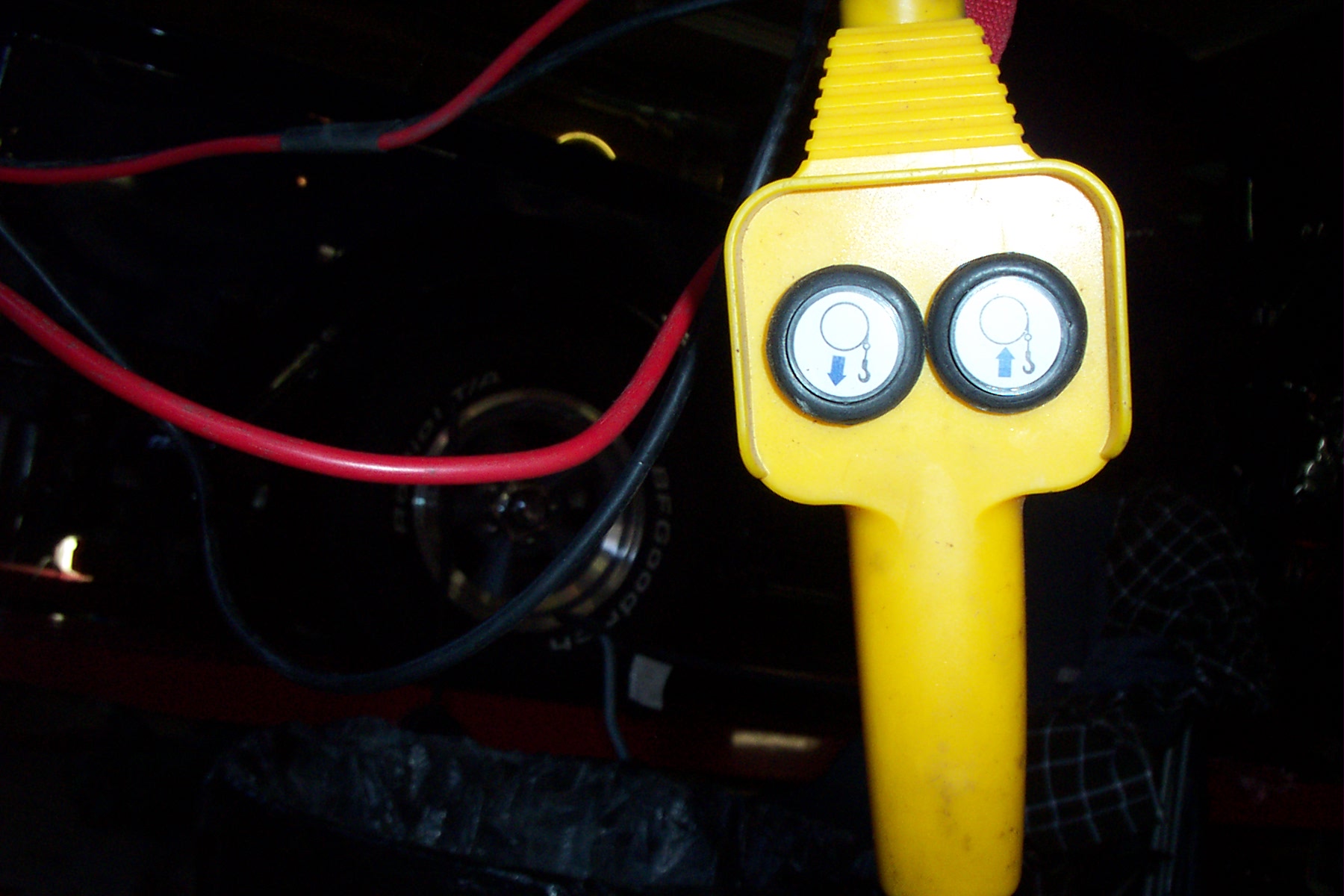

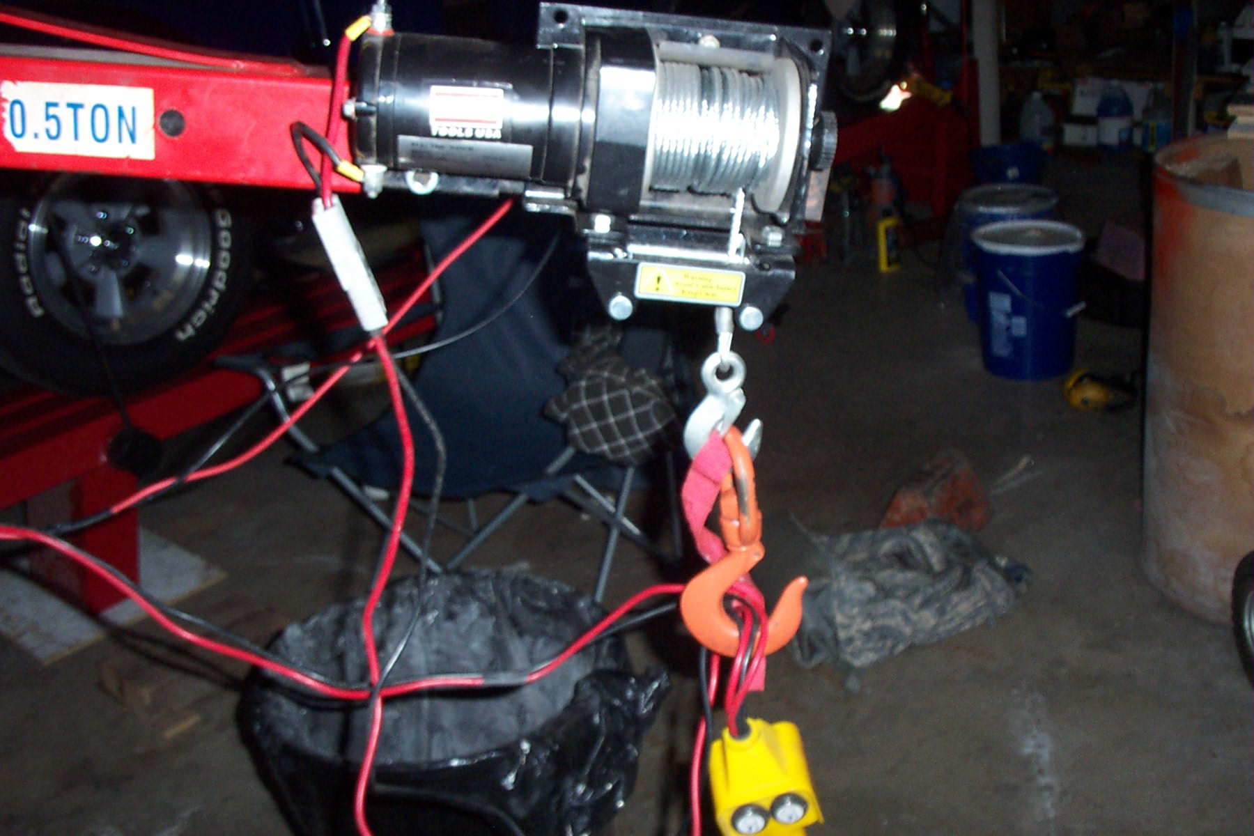

I usually work by myself. So when I needed to change my transmission I needed a way to lift and hold it. I could crawl in and out of my truck to pump and release the hoist, that was not happening, I had a winch laying around the shop and I got an idea. I found a piece of angle iron that would fit into the square tube on my hoist and mounted my winch to it. Raising and lowering the transmission was as simple as pushing a button.Attachment 10598Attachment 10599Attachment 10600Attachment 10601Attachment 10602

Those cheap winches are amazingly useful. I use one to lift a homemade snow plow behind my Suzuki Vitara.
A winch on a stick, I like it!.
Bob
Thanks Bob. I like it myself I wish I would have thought of it sooner. It beats struggling with a transmission over your head. It saves on headaches in more ways that one.
