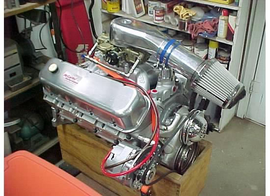

Cool Jig Mark. Did I read that right, a merlin 509 crate motor in an astro van? Oh my, no wonder the suspension!
Yup, it's a Bowtie block out of a boat. 502 bored to a 509. All forged bottom end so it is stout.
https://im1.shutterfly.com/media/47a...D550/ry%3D400/
The van is getting a full chassis with the custom front and rear suspensions. I've moved the engine back 18" and down 6. It is more like a mid-engine now. :)
Mark
Oh My Mark, Forged crank and marine grade too! :clapping: This is quite the build to say the least and fully understand the frame and suspension stuff now. That looks like an 850 on there by the size of the bowls? May need ladder bars to hold this thing on the ground. :p:bow:
Thanks for sharing parts of this with us...Truly Cool! :cool:
