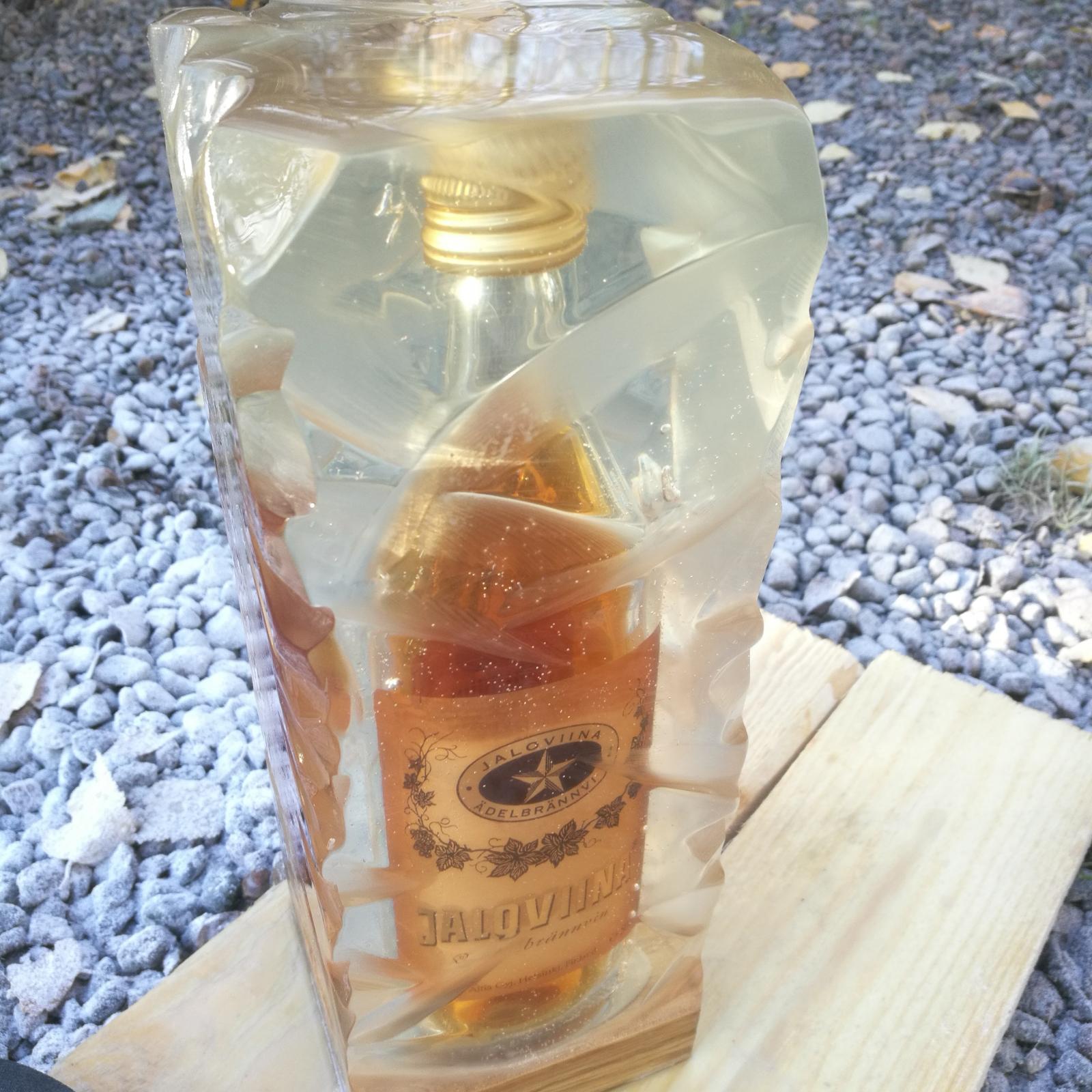

    I made this kind of gift for my friend.
    Its a bottle inside epoxy resin.
    I tried to shape it to look like ice block.

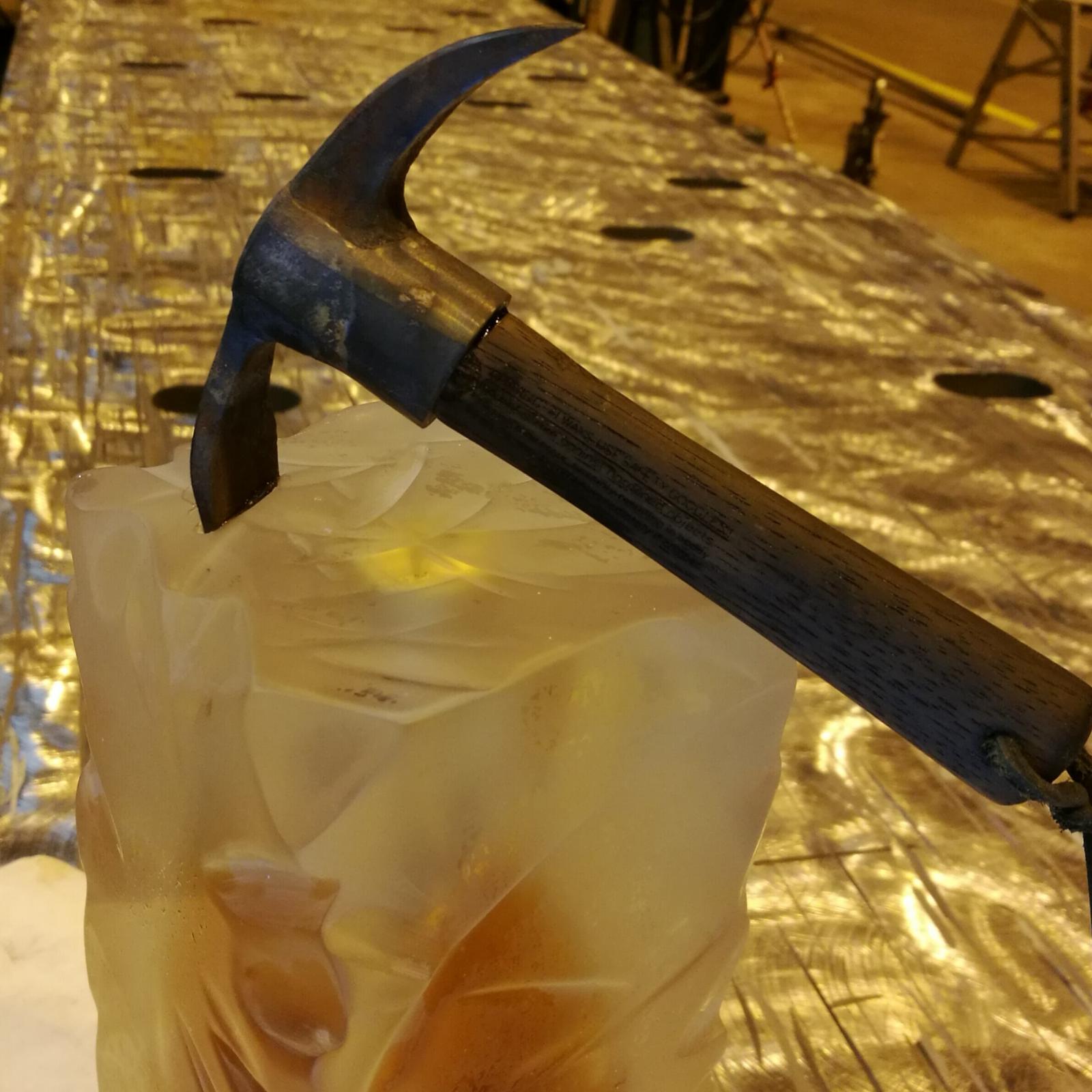

    I also made this small ice axe to it, so he can dig the bottle out. ( Try to dig )
    Handle is about 3 1/2" long.

    Here is the "ice block" after polishing.

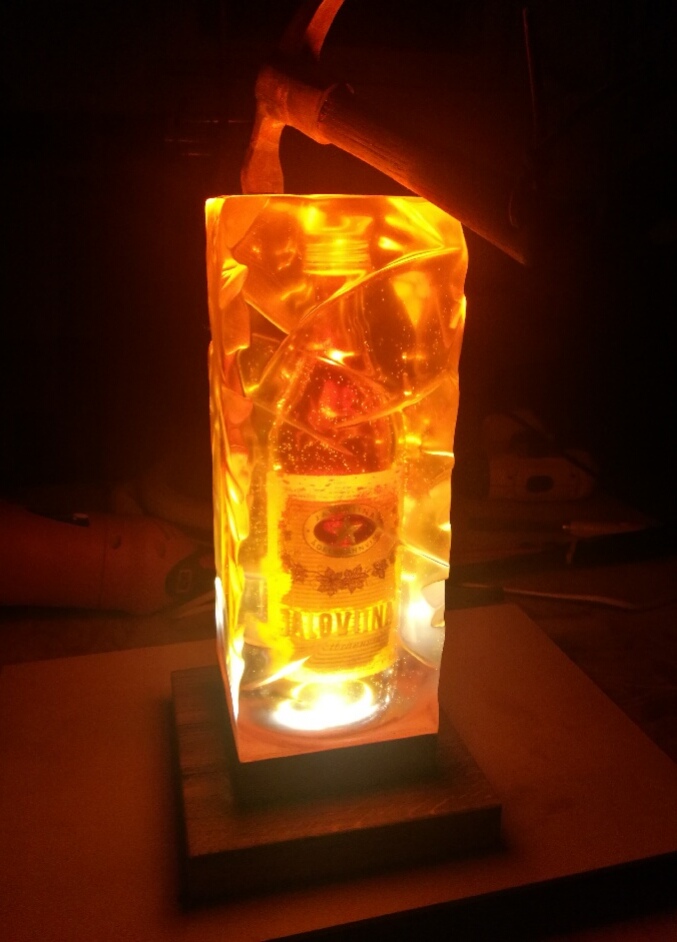

    Here it is with lights on.

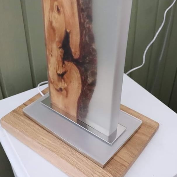

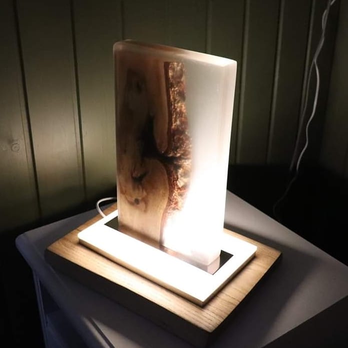

    Here is another one.
    Simple night light.
    Epoxy resin, acryl, stainless steel and oak.
    Lit up with two led stripes.
