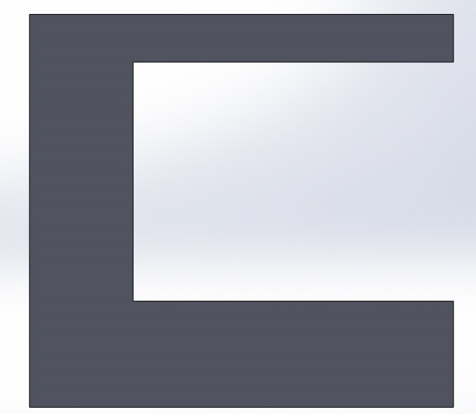

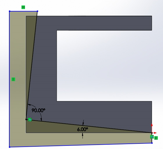

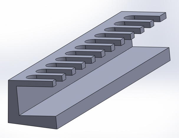

you could always make a 5 or 6° cut to the back and bottom of the rack then no matter if it was sitting on a bench an dgot knocked around or mounted on a wall the collets would have a natural tendency to stay in place
Attachment 19388
Attachment 19389
Attachment 19390
