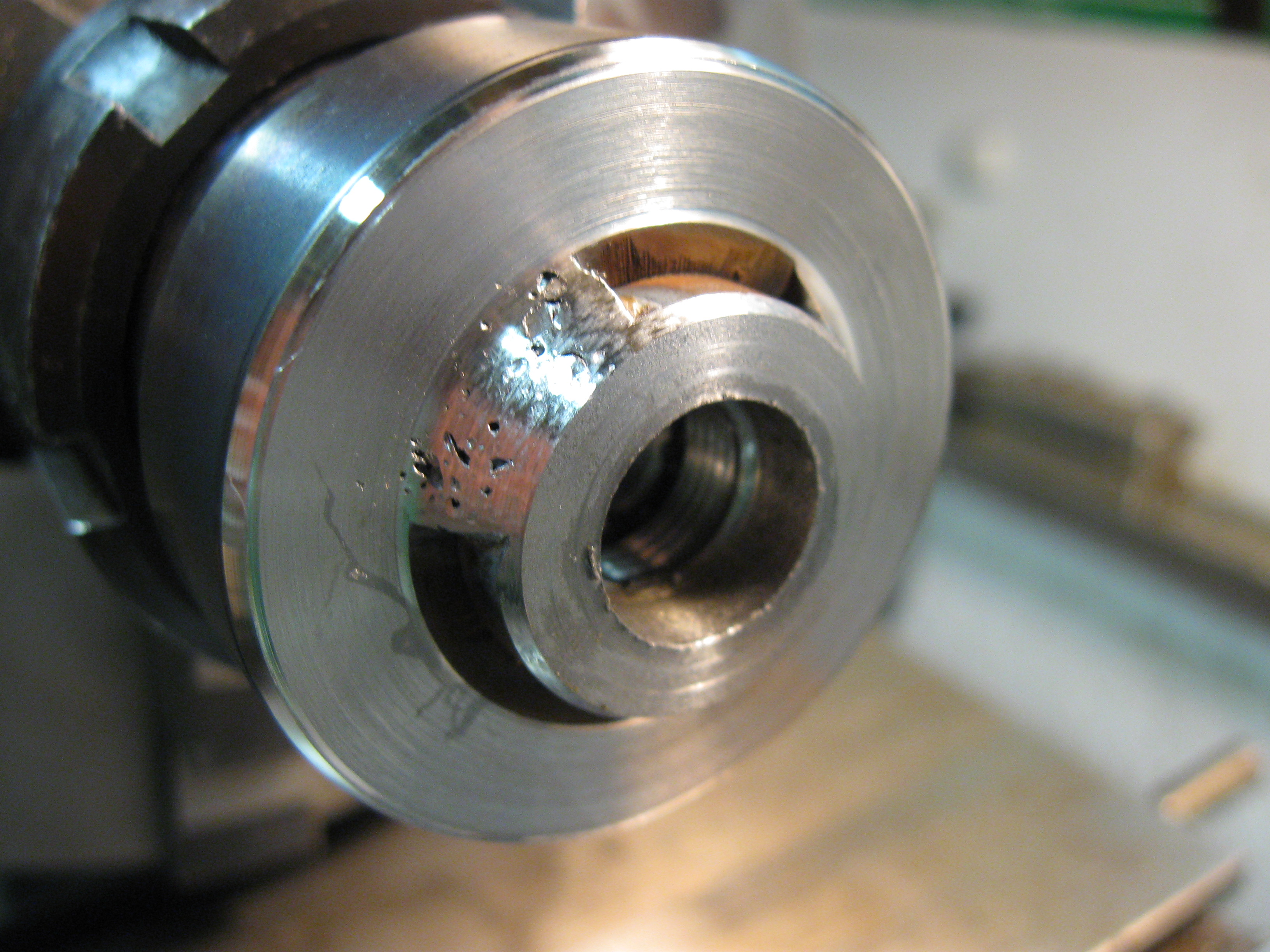

Hello Paul:

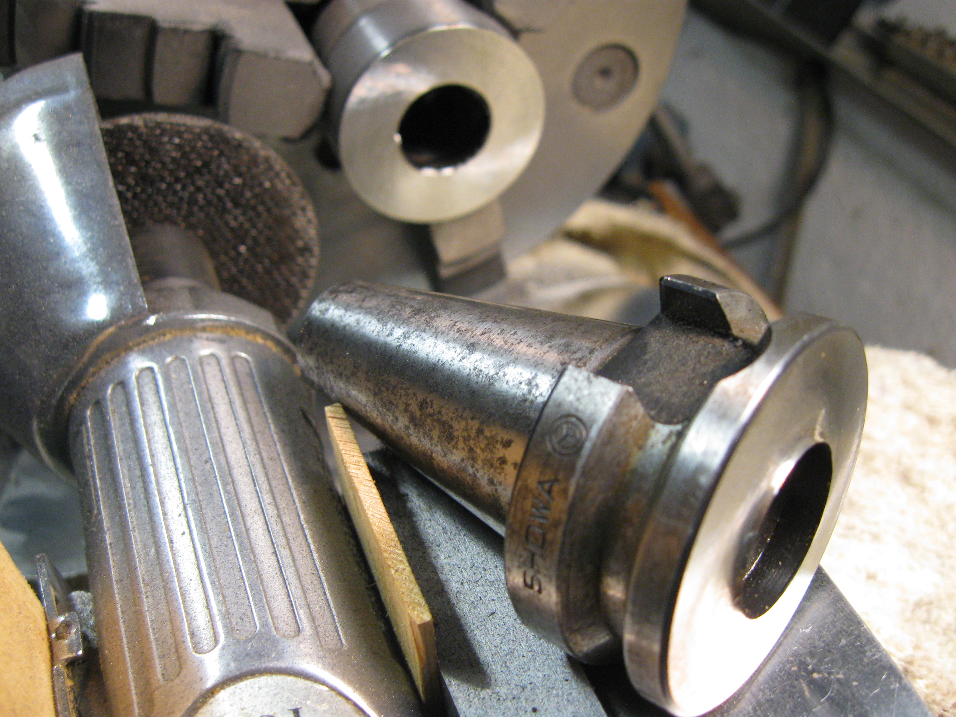

I have a full set of ER-32 collets and decided I wanted a chuck for my Unimat too.
So I bought a Cat40>ER-32 chuck and cut the Cat40 end off:
Attachment 47104

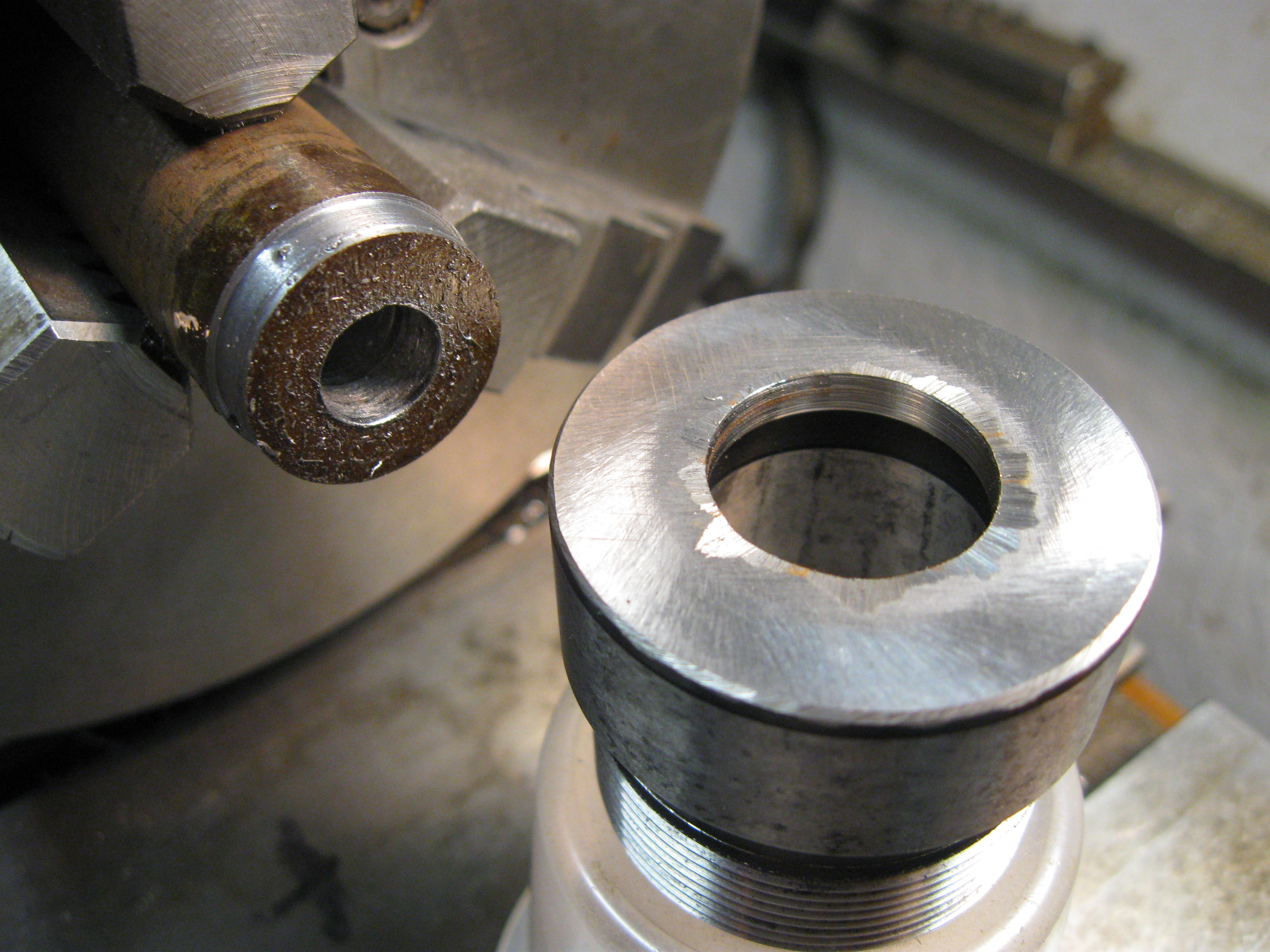

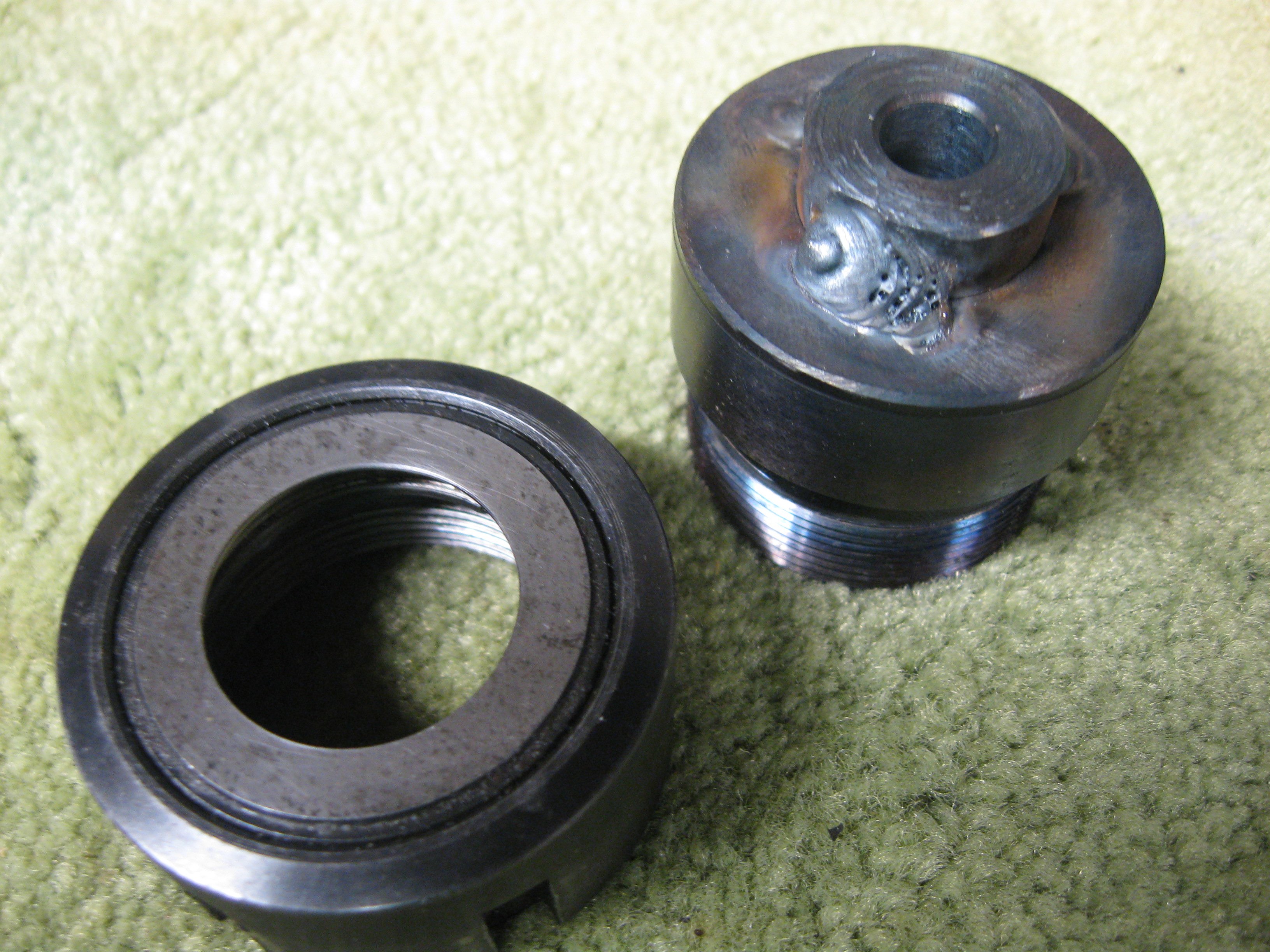

Then I bored the back of the ER32 section for a new bushing and welded it in:
Attachment 47105Attachment 47106

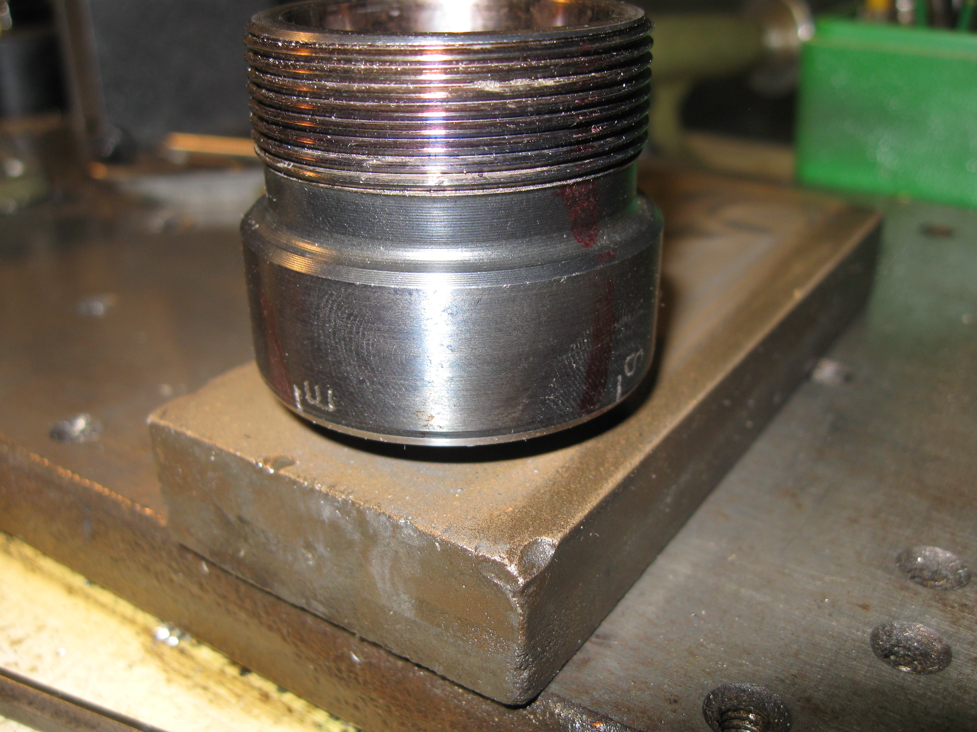

I clamped the ER32 collet on a trued shaft in the lathe and tapped it M12x1 for the Unimat:
Attachment 47107

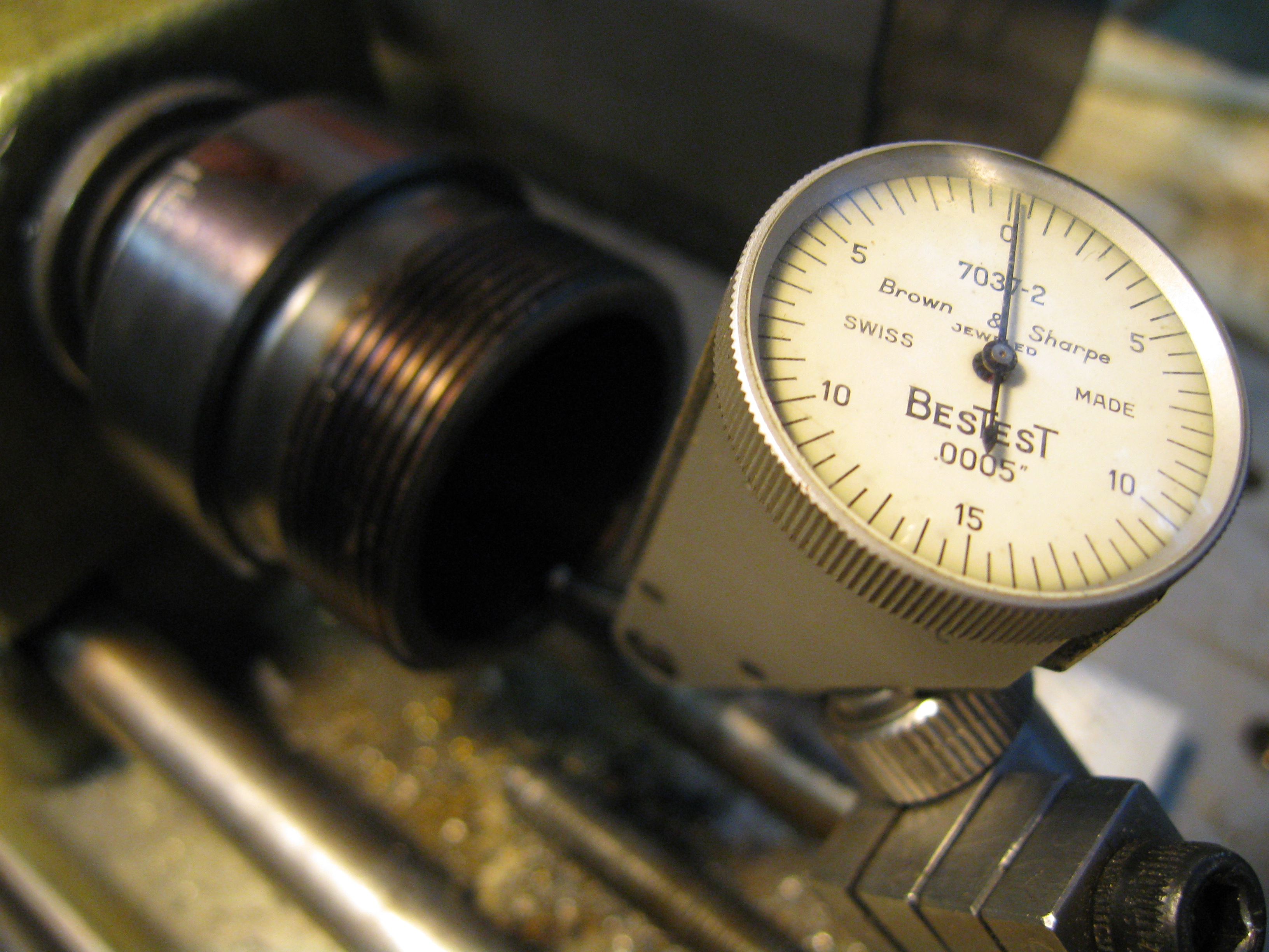

Then with some checking and stoning I had it running true:
Attachment 47108Attachment 47109

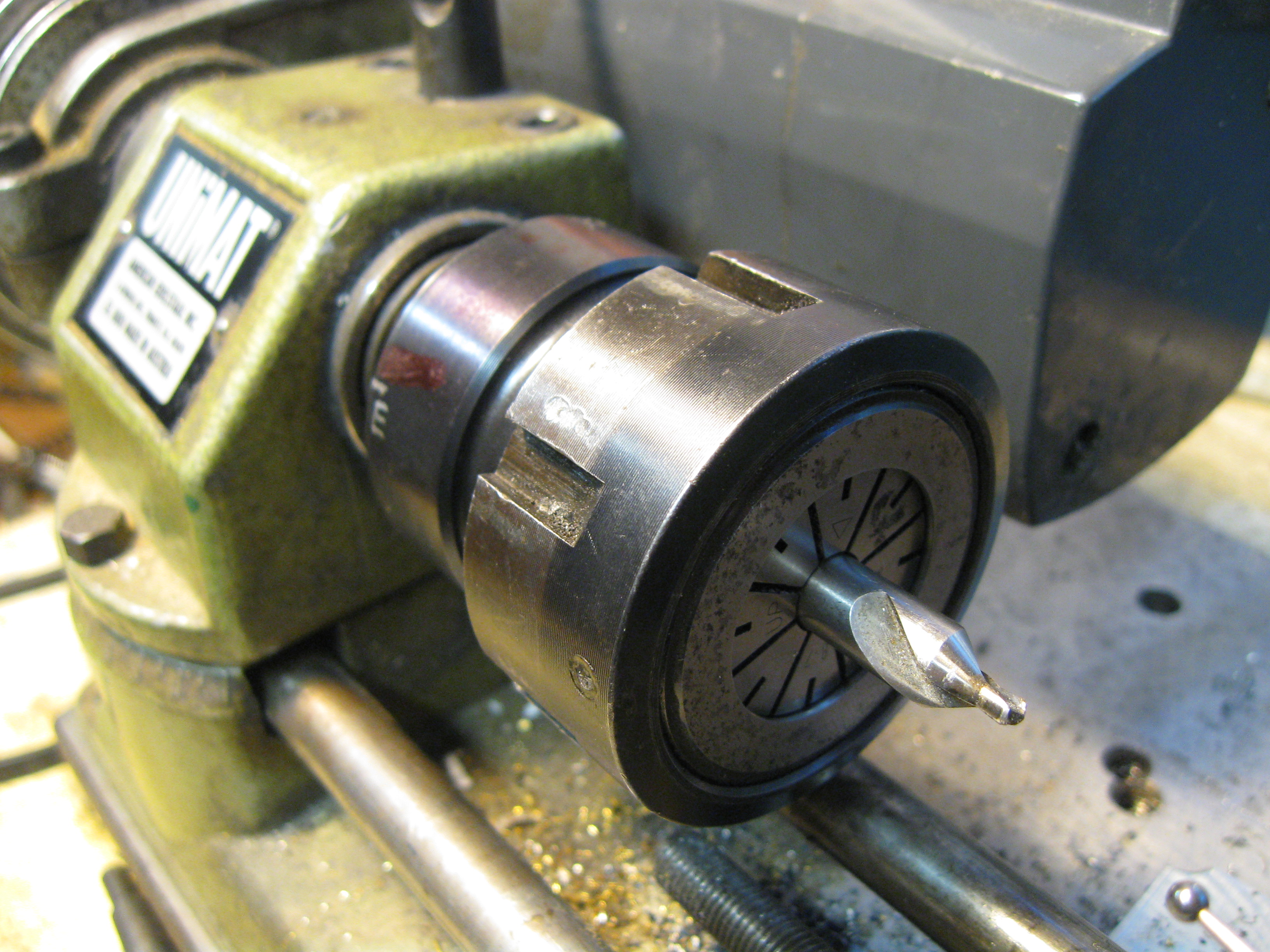

Now it is all finished and it is great. I used it to hold wood dowels and the range -1mm really helped.
Attachment 47110
Some said the chuck would be too large for the Unimat, but it isn't much larger than the 4 jaw chuck.
Good luck! Carl.
