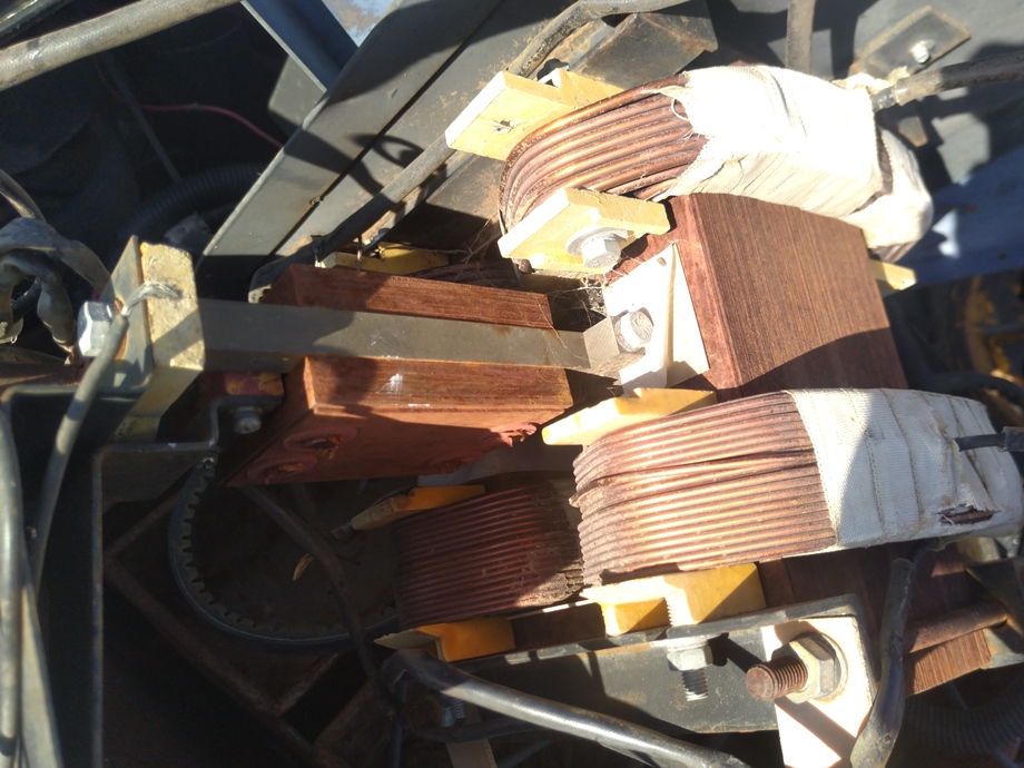

    How are you controlling arc current output? or is it just a one heat setting, and you have what you have. A lot of welders like yours have Mutiple taps on the secondary windings by winding more than a single secondary. I tore one apart once that had as many as 8 sets of windings for the secondary using 1/8" square enameled wire and another that controlled the current by adding or deducing the amount of steel in the core by pulling a large chunk of it away from the center

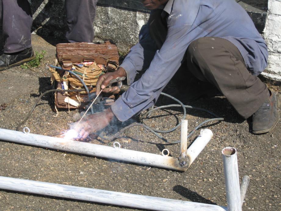

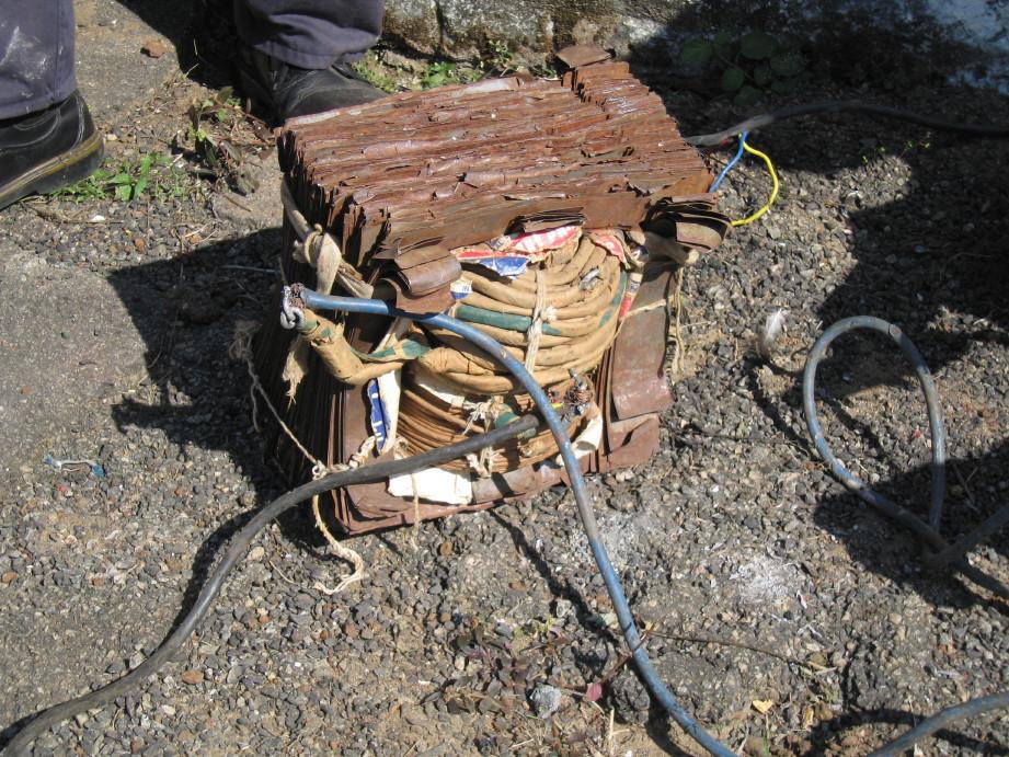

    You mean something similar to the attached:
    Exellent Homemade Welding Machine using 4 Microwave Transformers-welderb.jpg
    Exellent Homemade Welding Machine using 4 Microwave Transformers-weldera.jpg

    That reminds me of the stuff I saw being used when I was on a job in Siberia, circa 1992
